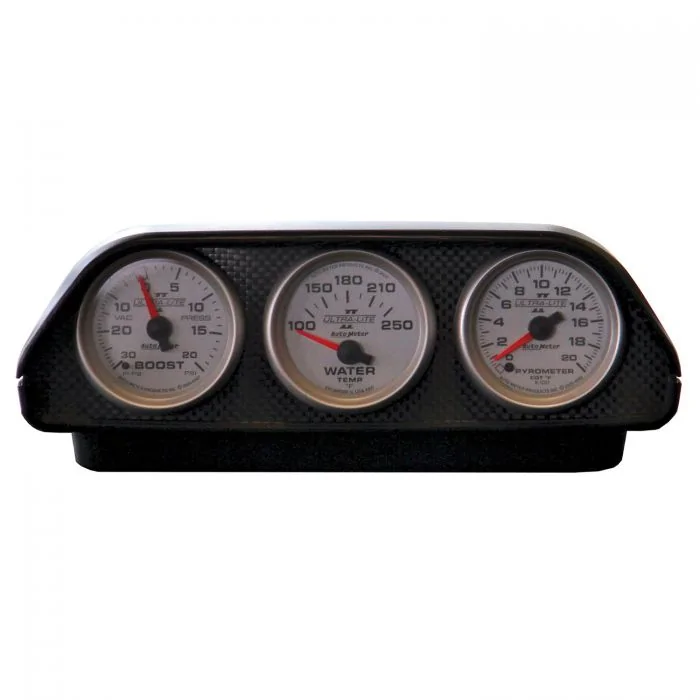

I am mounting the gauge pod below in the dash tray, it comes from Autometer. I have purchased a vacuum/boost, oil pressure and volt gauges.
For the boost gauge I purchased a tee that goes in series with one of the vacuum lines on the manifold. This kit doesn't require cutting any of the stock lines. I will be teeing off the oil pressure switch on the oil filter adapter.
I purchased GlowShift gauges because of the LED back lighting set to white looks most integrated with the factory dash.
I had hoped to integrate the upfitter switches that currently reside on the dash but the pedestal on the gauge pod is not high enough. If I ever have a need for the up fitter switch's I will find a place for them.
Just waiting on a warm day to get the installation done.

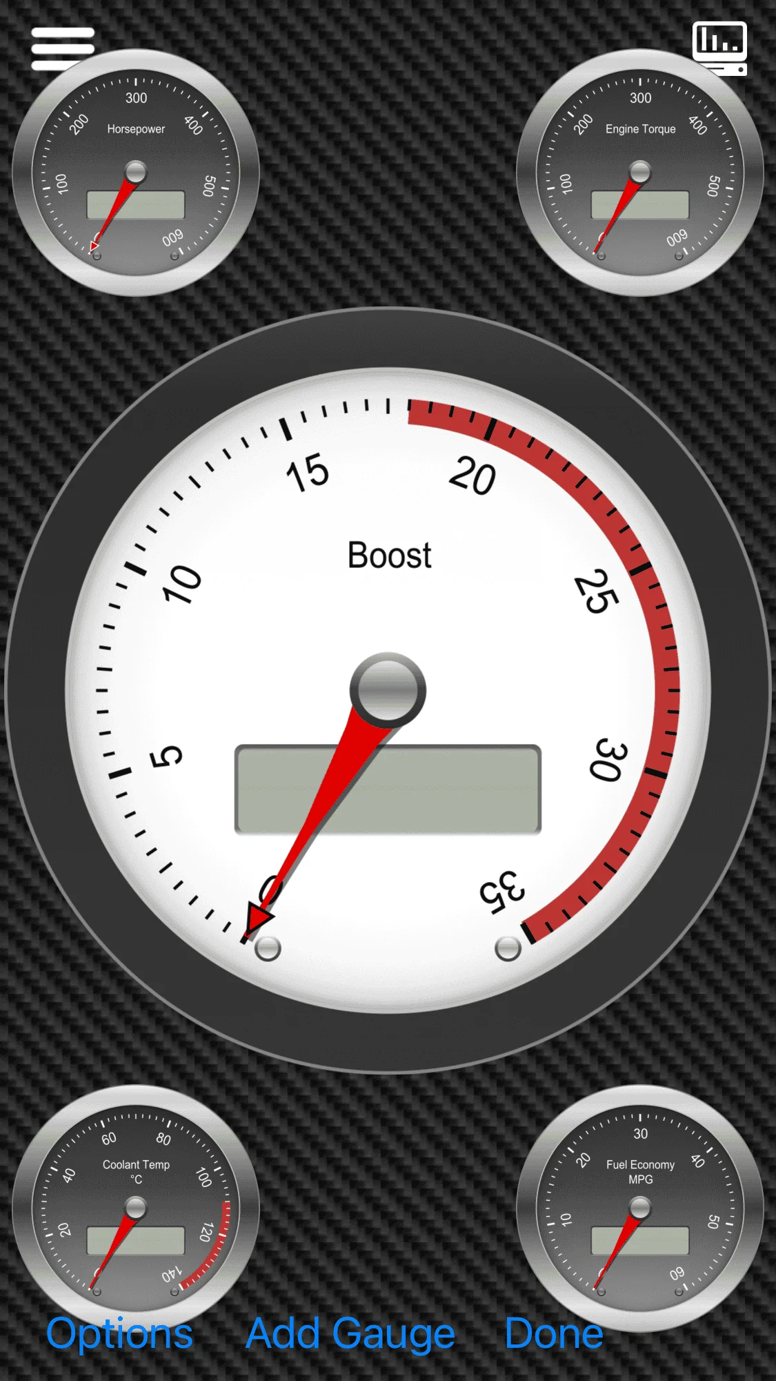

I’m using Dash Commander on my iPhone and a OBDLink MX+ Nice thing about that combo is you can setup software on your phone to pull in any OBD reading and make a gauge to show current activity. It also is a scanner and you can use Forscan lite with it.
