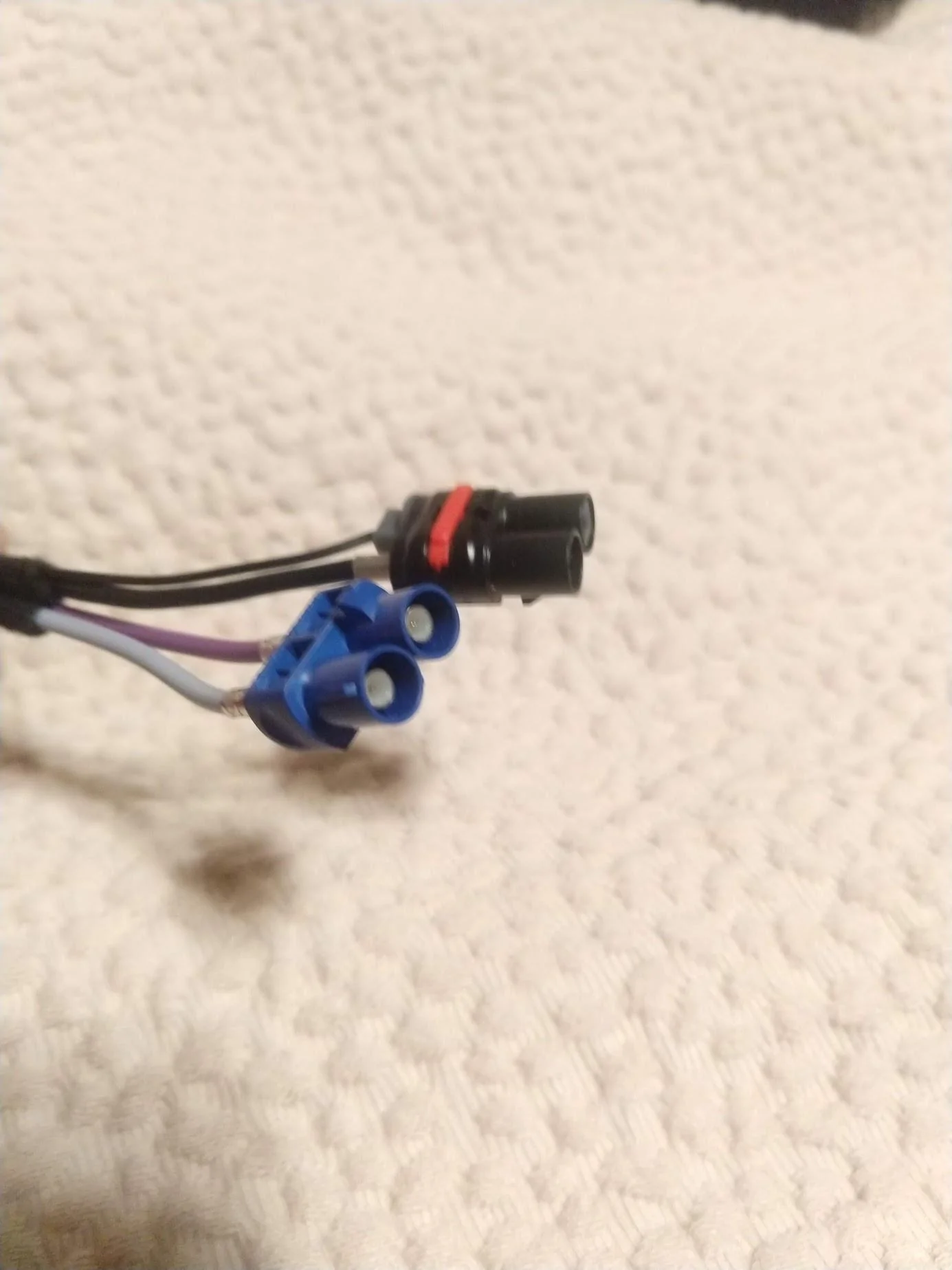

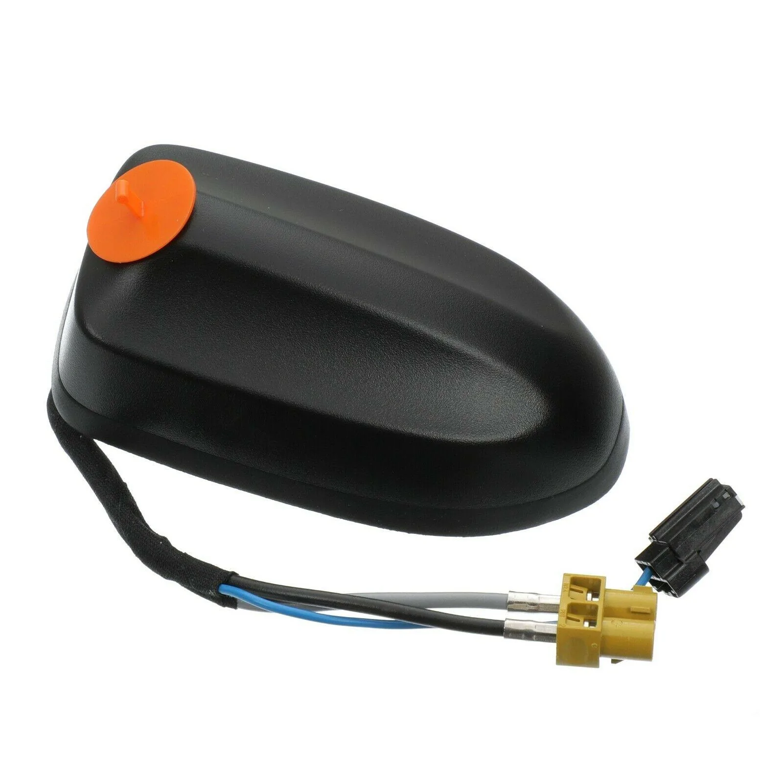

Not sure if anyone is still planning to do this, but I decided I wanted my FM radio to work so I went back in and connected the Ford Escape antenna to the terminal connectors inthe ranger. This required a bit of hackery with the antenna terminals.
The Ford Escape antenna is part #DS7Z18936D. Stock photo attached.
I got it working with trial and error, so I don't know exactly what's what, but the important connections for FM radio to work are the blue wire and the black wire.
Those two wires need to connect on the Ranger to the terminal for the two black wires going into the black terminal connector (photo attached). I didn't do anything with the grey and purple wires going into the blue terminal connector.
I took the male end of the black terminal connector off of the Ranger antenna and reconnected the black and blue wires from the Escape antenna using the black terminal connector from the Ranger. Then the antenna plugged right in. So far everything is holding up well.
