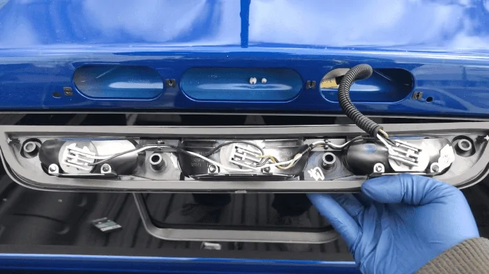

Hello! I have a question for those who have worked on this truck more than I have. My shark fin/radio antenna assembly is loose on my roof. It seems it is possibly loose enough to let water/moisture in in a heavy rain/car wash. I want to access it from below to tighten it down.
Will I have to remove the entire headboard to access this? Or am I able to fit a tool in there from the back by removing the 3rd brake light above the rear window?

If it's under warranty, I agree with T Bone.

No, you won't be able to easily reach it by removing the third brake light. Make the dealer make it right.

I had to drop half the headliner, broke several clips and parts on the way.:angry: There is a video on this forum somewhere.
