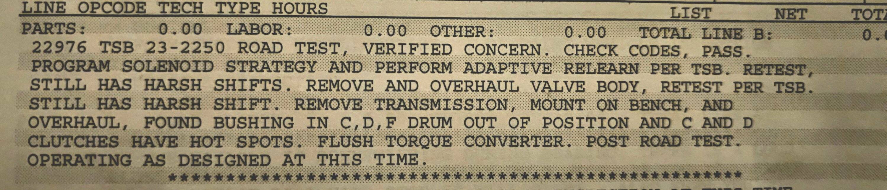

UPDATE:
Picked up my truck this evening. Work done is as outlined in the attached picture.
On the drive home I did a little sport mode driving after the engine was warmed up all the way. Truck behavior is the same to me as when I dropped it off. Transmission overhaul at 22k miles? Yeah, I'm not happy about this and the ra t that it is still clunking in and out of several gears. I'm going to unload this giant disappointing lump of junk and get something else. I need something that can tow my camper ~6k miles a year without letting me down or having to go into service for over a week for some overhaul or another.
I'm done with the ranger. Going to have to do some serious research on what to replace it with. On the bright side, it looks like I should get quite a nice price for it. No lean either.

UPDATE:
they didn't specify the adaptive learn was completed again after the overhaul.
I would assume they did it, but perhaps they didn't.
Give it a bit of time before you throw in the towel just in case.
The Ranger hands down outshines any of the competition when you have a primo transmission, a good battery, a slightly lowered bed for easier access and no TG damper.
What I experienced on the drive home was exactly the symptoms that lead to me taking it in, I don't see how a simple relearn could be the cause of such obvious issues. These aren't just feeling a slightly hard shift, it is clunking so bad it literally feels like being rear-ended. As for the competition, I won't be getting a compact/small truck. It'll be a full size with proven reliability. Heck, as much as I dislike how the Tacoma drives, they have earned their reputation in the small truck segment. In hindsight I should've just went with a Tacoma instead of the Ranger but the turbo pulled me in. It's time for me to do some reading and go on some full size truck test drives.

I'm curious then how the tech came up with the "operating as designed" comment at the end then.
Two vastly different opinions.
Taking it to an independent trans shop and get an unbiased opinion would be my next step. I wouldn't be able to trust myself with my own opinion if I was angry either, and we know the mechanic has a desire to cover his ass if he dicked up somewhere.

Well thats disappointing as hell ?, did they replace the drum ? I have a 21 with bad shifts and was hoping the drum would fix it , changed drums in 22'S I believe...
Not sure. I imagine they would have put it in the work done description if they changed such a component. My biggest concern is how much I tow and that thise same parts or others will just go bad again. Next time it could fail catastrophically, when I am far from home towing a trailer. Not what I want. 22k miles and the transmission is falling apart is very shitty in my book. If it happened once it's likely to happen again.
I too am looking closely at the full size segment again, my needs are changing and I may need the towing capabilities pumped up considerably.
This work was covered under warranty. I really have no interest in spending money for a second opinion. Regardless if it is "operating as designed" now or not, it still fell to shit after only 22k miles. I'm just going to sell it and get something different.
"operating as designed" is code for "not my problem"...
