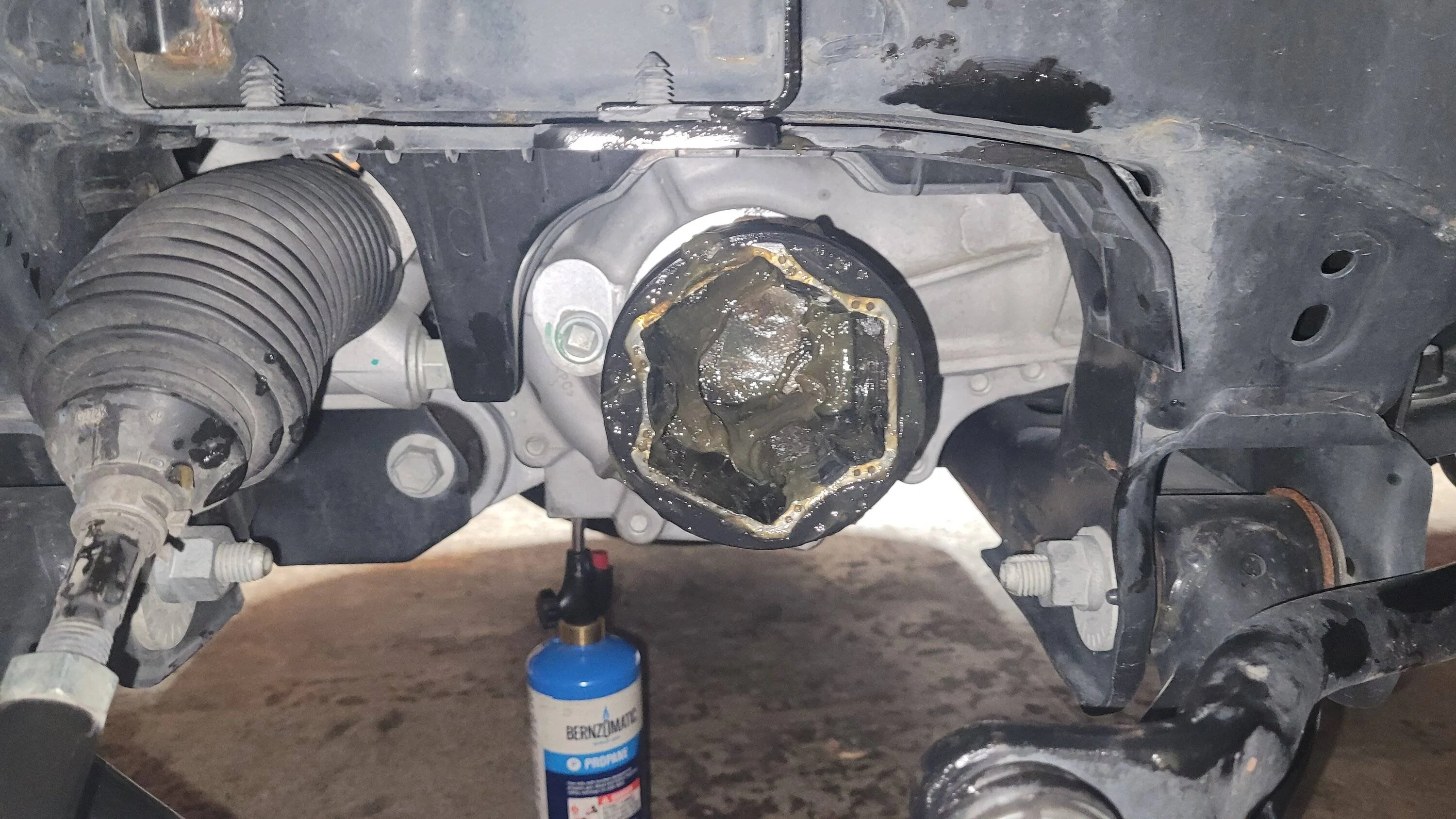

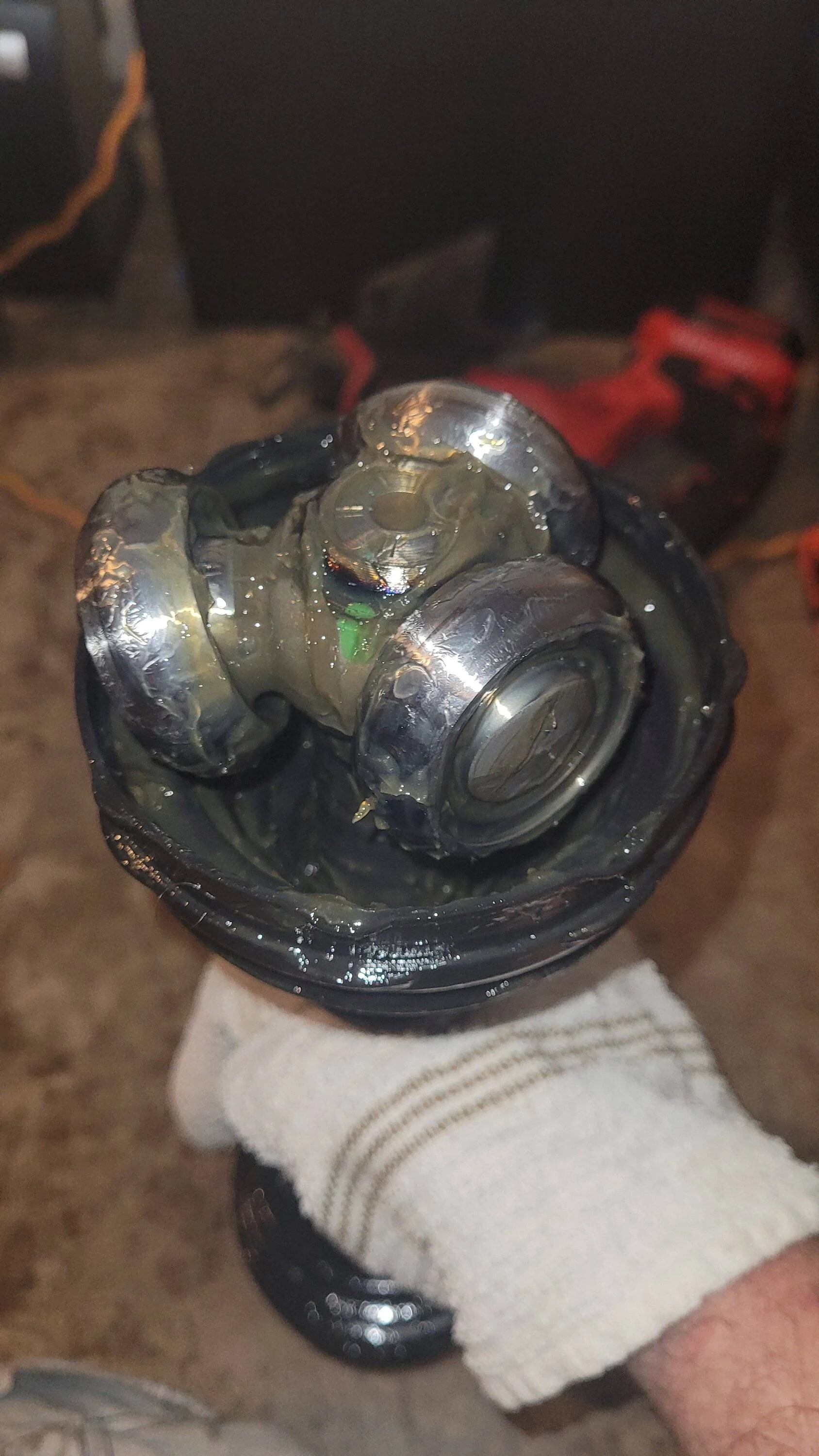

It will not just slide in, line it up streight and give it a couple of good wacks with a dead blow or small sledge with a block of wood so you don't jack up the threads and it should pop in..
Good Luck! worst case complete axles are ~$150 - cheaper than a tow and repair bill. The shaft pops out of the housing with a c-clip (a couple of large pry bars will get it. There is a PDF somewhere on here, I will see if I can find it.
This PDF shows prying it out with large prybars. Hope that helps!

Here is a Great Ref video for a pulled CV issue, scroll towards the end of the video, ironically, he hits on the scenario of pulling it out by accident at the 7:05 mark
Why Does My Car Axle Click? Diagnosing and Explaining Axle Noises (youtube.com)
The positioning of the bearings is a HUGE key to getting it in, so a complete OPPISITE of what you would most likely think to position them, so this is a GREAT reference video.
For the few in my career that I have had to do this, I just got lucky on the vise, I guess. I might have moved them around but if I did it was pure luck I moved them to the correct position.

Sorry for the late reply I had another fiasco with tires after this finally she runs nice and smooth with my RTR EVOs and new gen BFGoodwrich KO3s.
So far the CV Axle is dry and I am thankful. I thought I dug myself a real deep hole this time. I have done lots of work on my 90 Mustang and there was always something new I had to learn when i got into a job especially suspension, but it wasn't my daily driver either and road blocks were ok. This time its 4X4 and a big learning curve.
thanks everyone for input this forum saved me!

Ouch... Yeah i couldn't believe it Ford removal instructions were literally to use a "crow bar" believe it or not the axle popped out from the differential no problem at the cost of a little nick in the aluminum diff housing. Yes I used a plastic block to protect it but it slipped and my knuckles paid for it.
