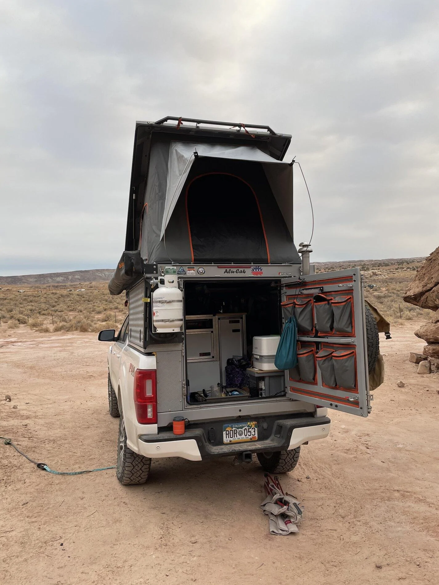

GP Factor install kit for the Dickinson heater arrived. From start to finish wiring it took me the better part of 6 hours. Getting the right fitting and hose length was a bit of a pain. I think it's a very clean install and the heater puts out some heat! Props to Rin from OK4WD for making this happen!
I know not many, if anyone else, will purchase this setup, but it is very light, convenient, and clean.

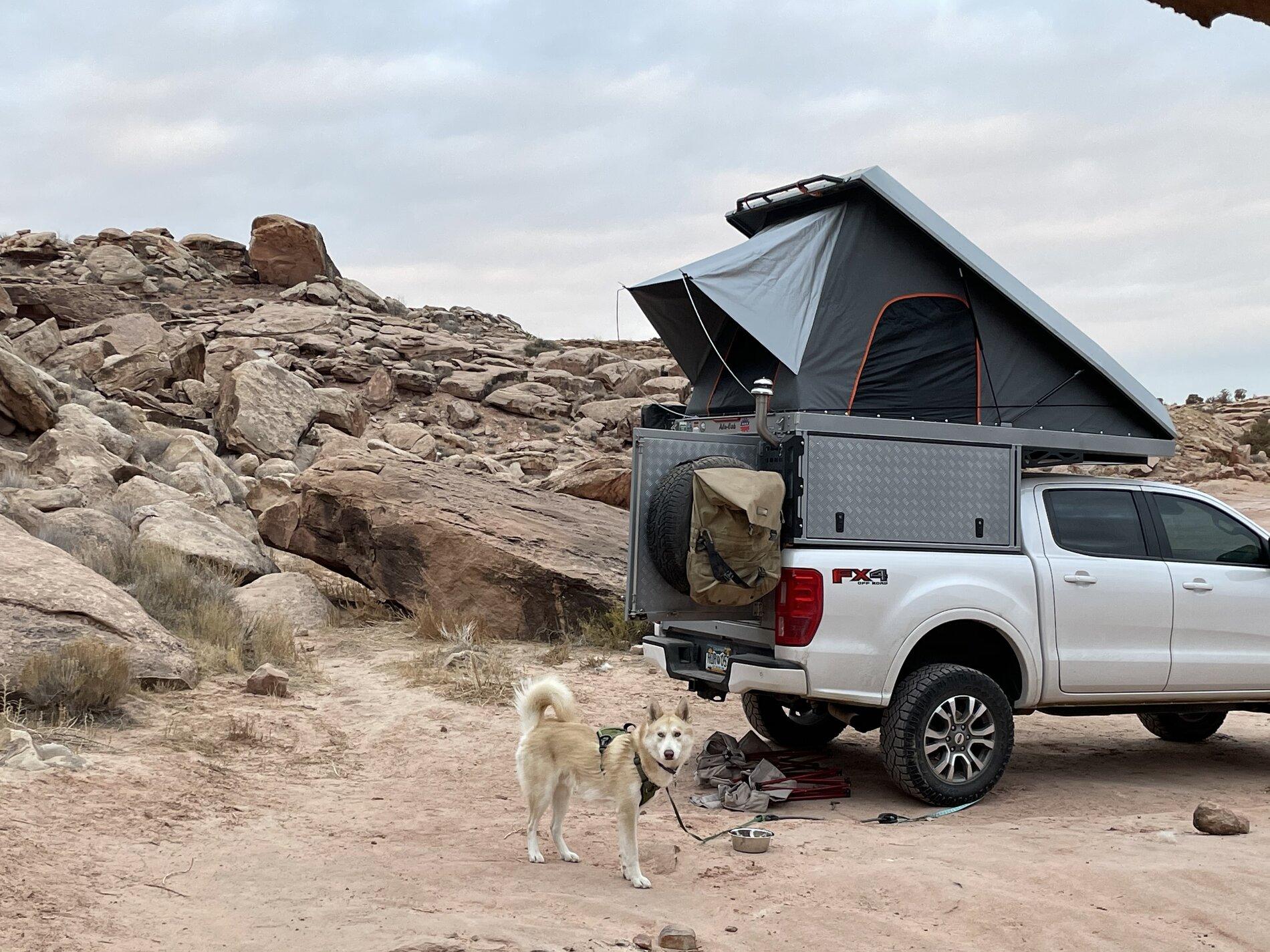

Just wanted to post up my build to give people ideas and for fun.
For reference I've use Tepui RTT for years. I bought my first in 2014 and used it around CO for 14er hikes. I sold most of my stuff while I moved around in the Navy for a few years. When I separated I "upgraded" to a light 18ft travel trailer to travel long distance more. The Tacoma couldn't handle it and I hated to awkwardness of it and not being able to take it on dirt roads. I sold the Tacoma and bought the Ranger and quickly ordered the AluCab canopy camper. I love the versatility of the camper. It's light, warm, well constructed and thought out, and a good price. A well rounded package in my book. I also love the tech, power, and smallness of the Ranger. I can get down any trail I want to with ease.
Ranger Mods,
Eibach front struts and rear shocks
https://www.stage3motorsports.com/E...Eibach-Pro-Truck-Front-3-Leveling-Struts.html
Rear air bags
Stainless steel down pipe
https://www.stage3motorsports.com/D...coBoost-SPD-3-Stainless-Catted-Downpipes.html
AFe interocoler piping (really junk!)
32in Duratracs
Tons of Forscan mods
AluCab Canopy Camper
https://ok4wd.com/brands/alucab/alu-cab-canopy-camper-for-2019-ford-ranger
Trail Kitchens Van Kitchen Box (A great compact kitchen with built in fresh and grey tanks, stove, drawers, everything)
https://trailkitchens.com/products/campervan-kitchen-unit?variant=7106575073310
National Luna battery box (smart charging and battery isolator all engineered and built as one small unit)
https://www.frontrunneroutfitters.com/en/us/battery-solutions/national-luna-portable-power-pack.html
Generic cheap and small Amazon compressor fridge
I have the propane heater Rin from OK4wd has in his Tacoma, but I am waiting on a fit kit for the AluCab. Winter is coming fast though.
https://www.amazon.com/Dickinson-Ma...nson+heater&qid=1599578403&sr=8-6&tag=mh0b-20

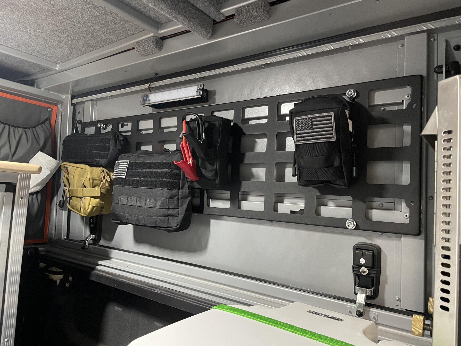

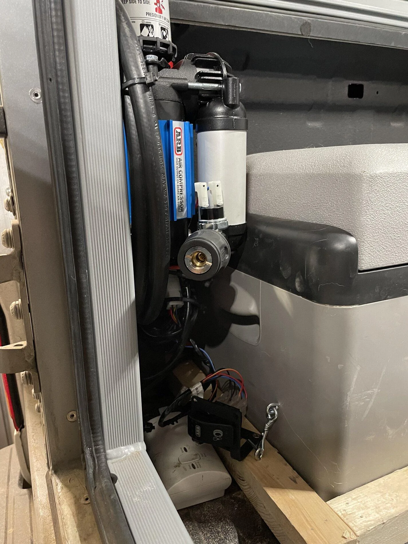

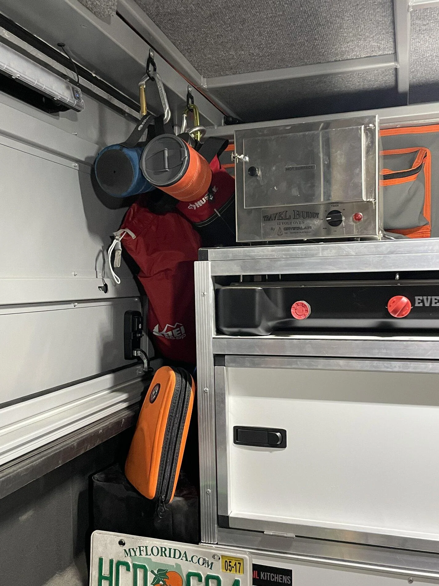

Well after a long winter of having covid, recovering, getting the vaccine, and then getting shingles, I had some time to make needed Improvements.
Added and ARB compressor, some MOLLE plate, and some storage hooks for coffee gear. Can’t
wait for EJS2021.

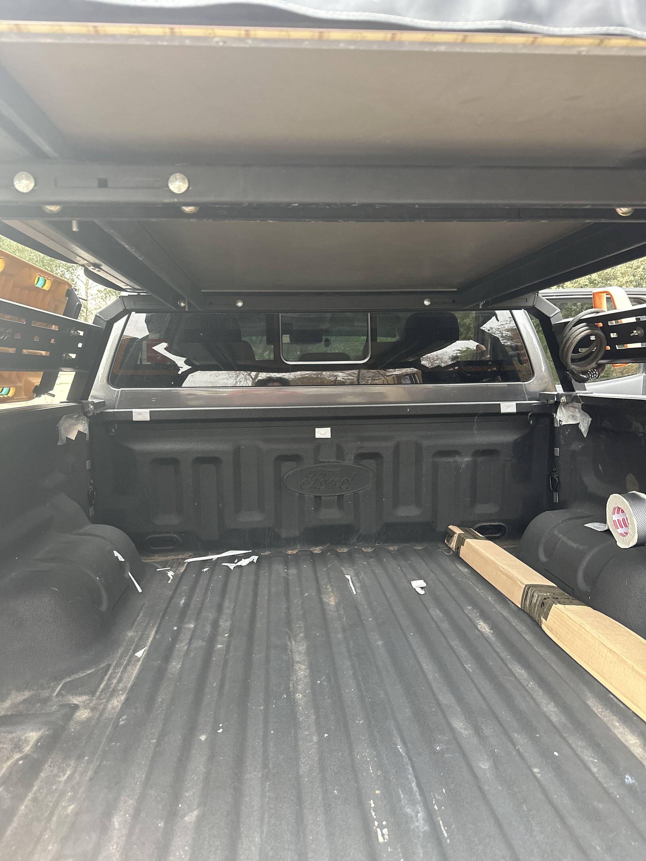

does anyone have a picture of the filler plate at the front of the bed im sealing mine and am wondering how professionals do it
