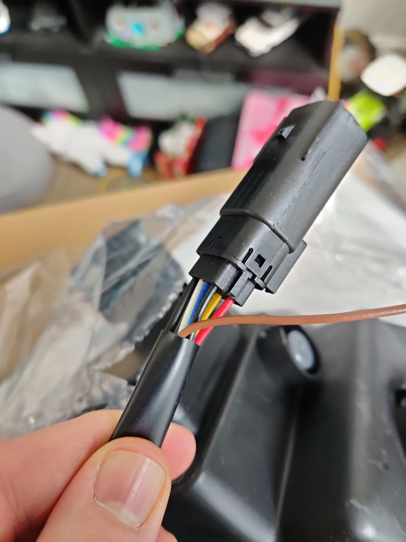

Based on what I'm reading from your doc and the way this harness is wired, it appears they've wired 1, 4, 5, 6, 7, and 8 on their assemblies. The brown wire is the additional wire that plugs into their DRL harness.
Sounds like from reading their explanation that the only reason for the DRL module is to run the strips at full intensity with the headlight switch off. I'd try it without and see how it works. I keep my switch in auto mode all the time anyway. Maybe it really is just plug and play then.
Are you looking at it upside down? Pins 2 & 3 are low/high beam so they gotta be there. Going off your pic, pins 1 thru 4 are wired, I can see 5 (red) but I can't tell if there is a gap between it & the yellow wire.
Edit: btw...the pdf is the trucks side of the harness

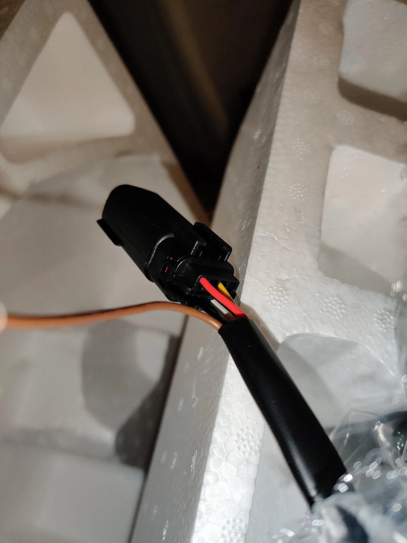

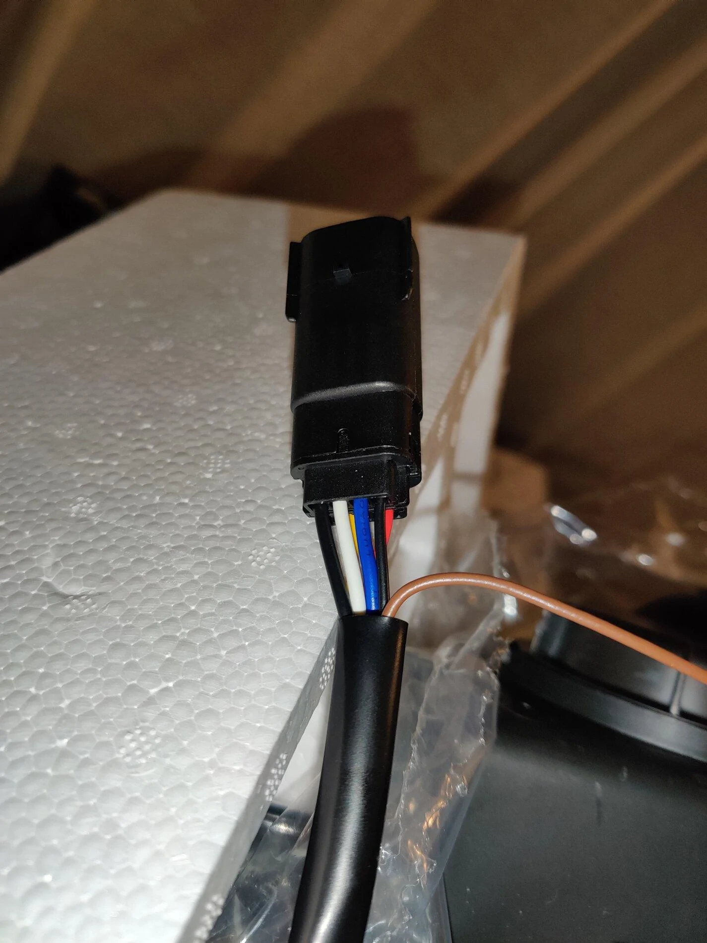

Definitely was looking at it wrong. I was in a hurry earlier and didn't pay enough attention.
Based on this and if I'm reading the PDF correctly (I think I got it this time), we have 1 (blk), 2 (wht), 3 (blue), 4 (blk), 6 (ylw), and 8 (red) on this connector. Which still doesn't make sense based on the circuit functions in the PDF.

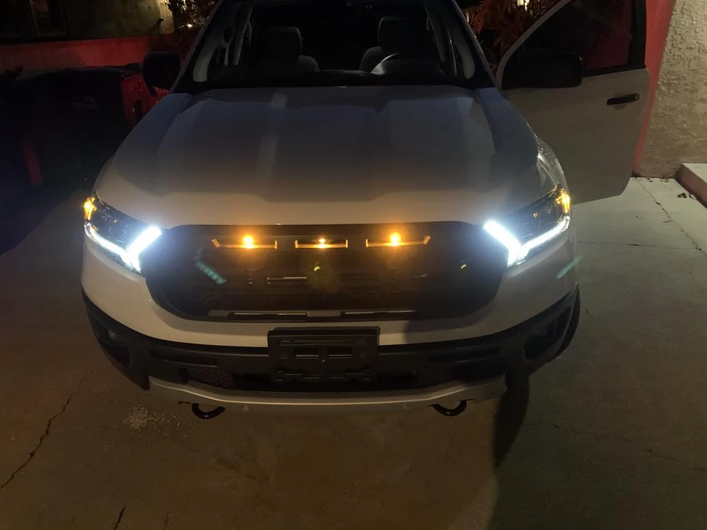

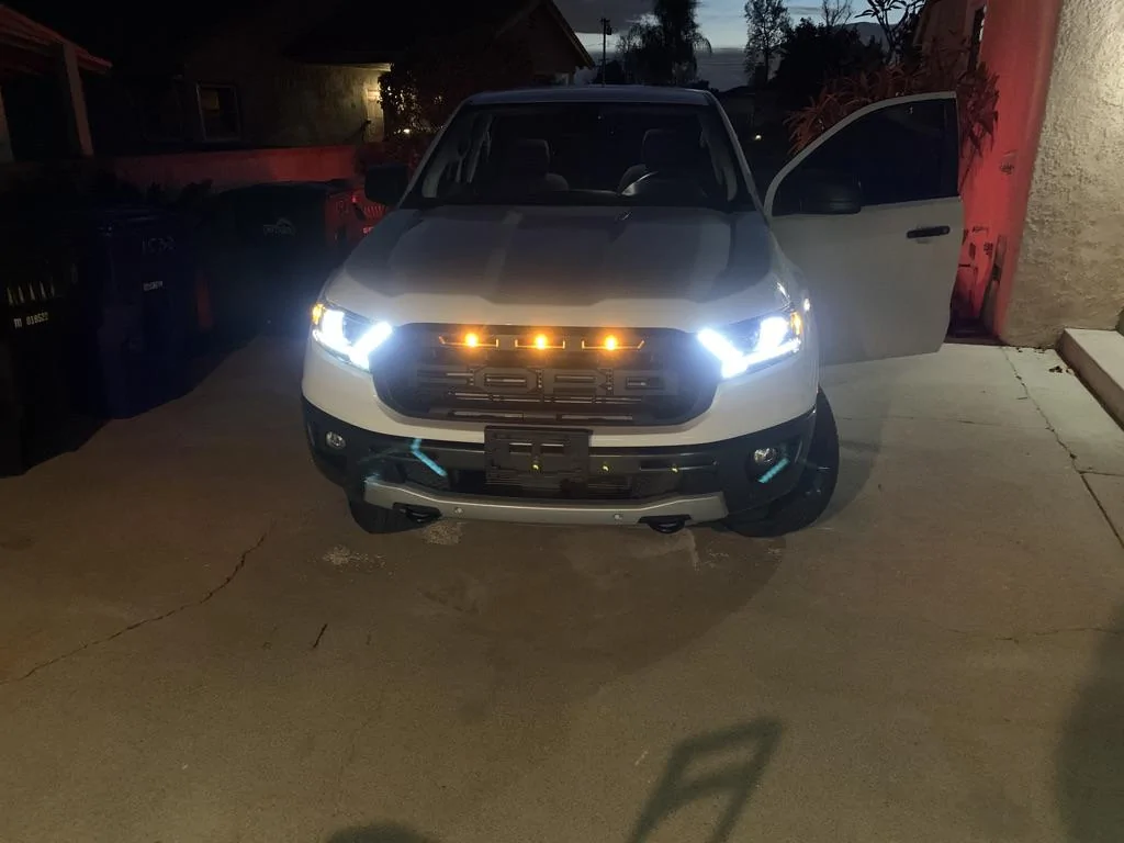

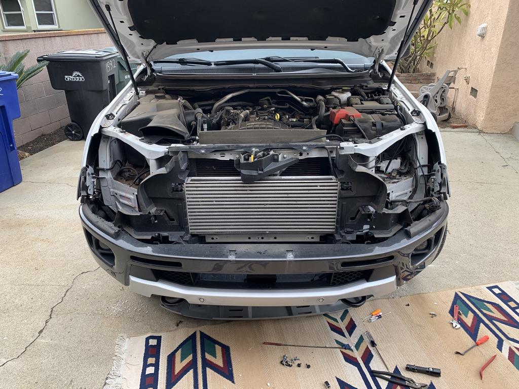

I Received my Luxx order on Thursday 3/11/21. Had to do some reading/ investigating. Headlights are plug and play, the DRL harness provided ( has a positive and ground connection it also has a wire with a fuse tap on it already { ing source } 2 more 1 wire each going to headlights ). Now it my understanding everything will work Start up sequence, DRL, everything. What DRL harness is suppose to do is make DRL more intense ( brighter in daylight, not so bright with lights on ). With that being said no splicing factory wiring, only adding a fuse tap ( which is provided ). Now Just need fair weather in Southern California ( Ontario ) and the time to install.
