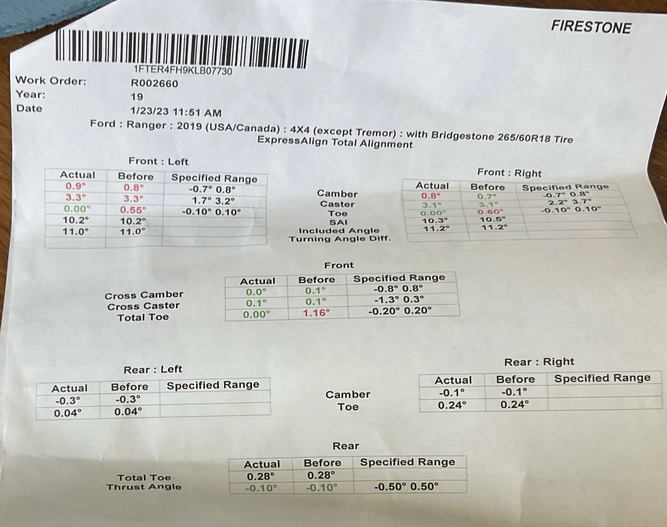

2021 Ranger Tremor XLT

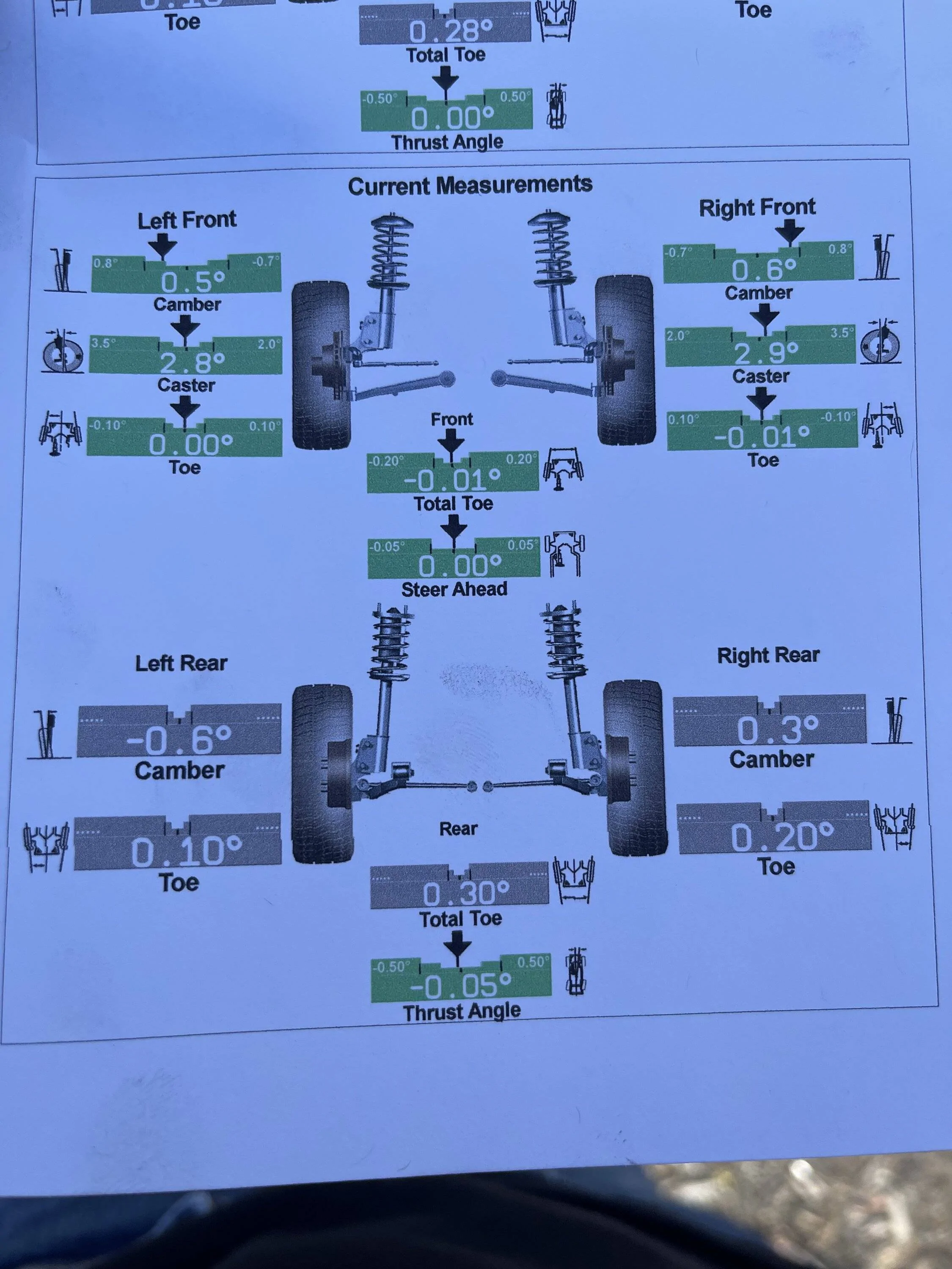

Numbers look good!

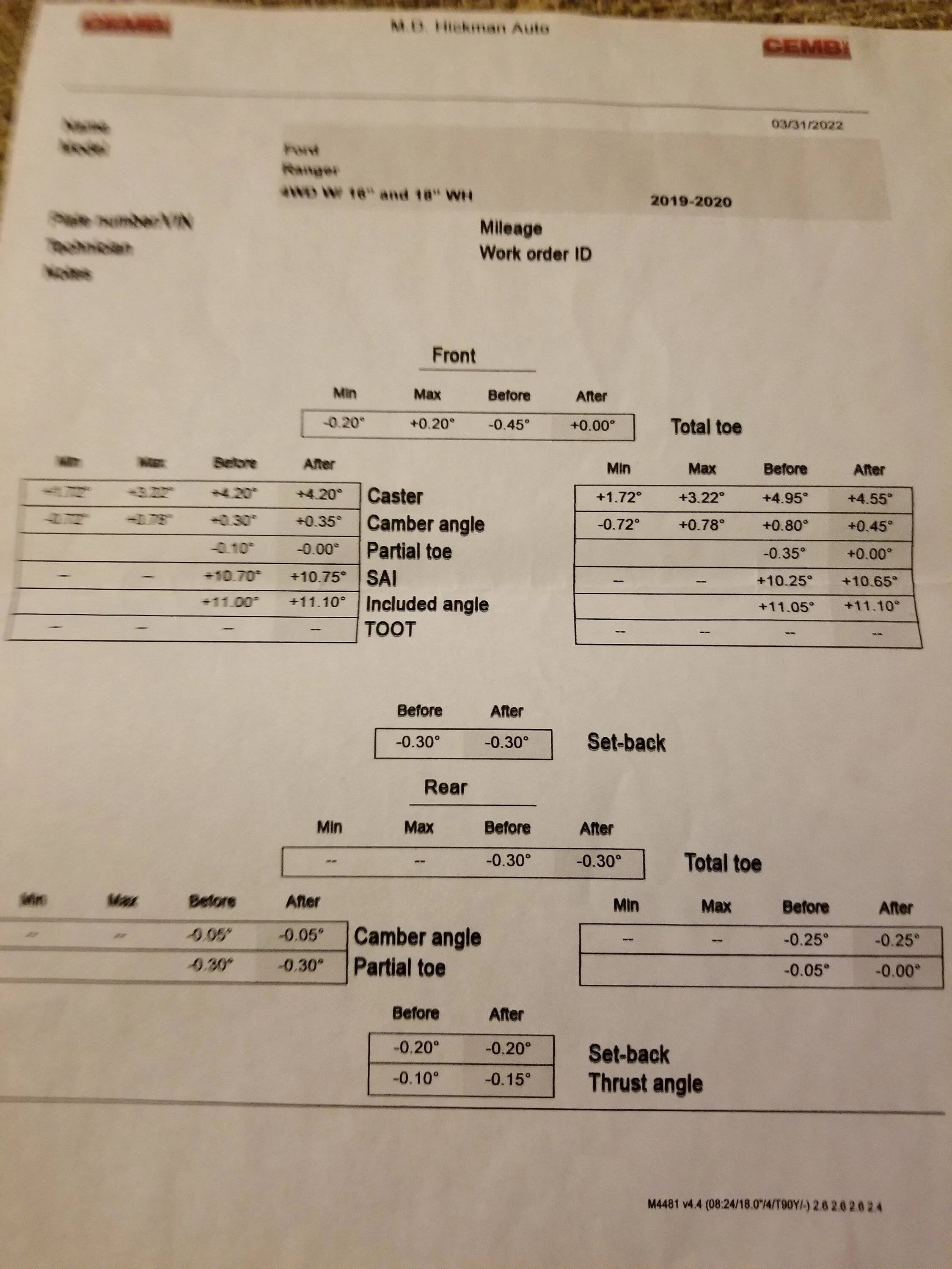

Frenchy
Mar 15, 2020
168
7,663
10,922
Elizabeth, Colorado
Field Service Technician
Not perfect but way better!!
