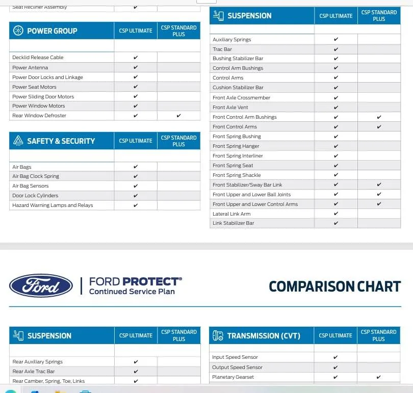

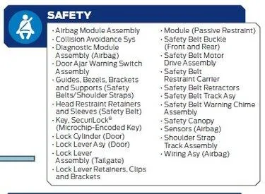

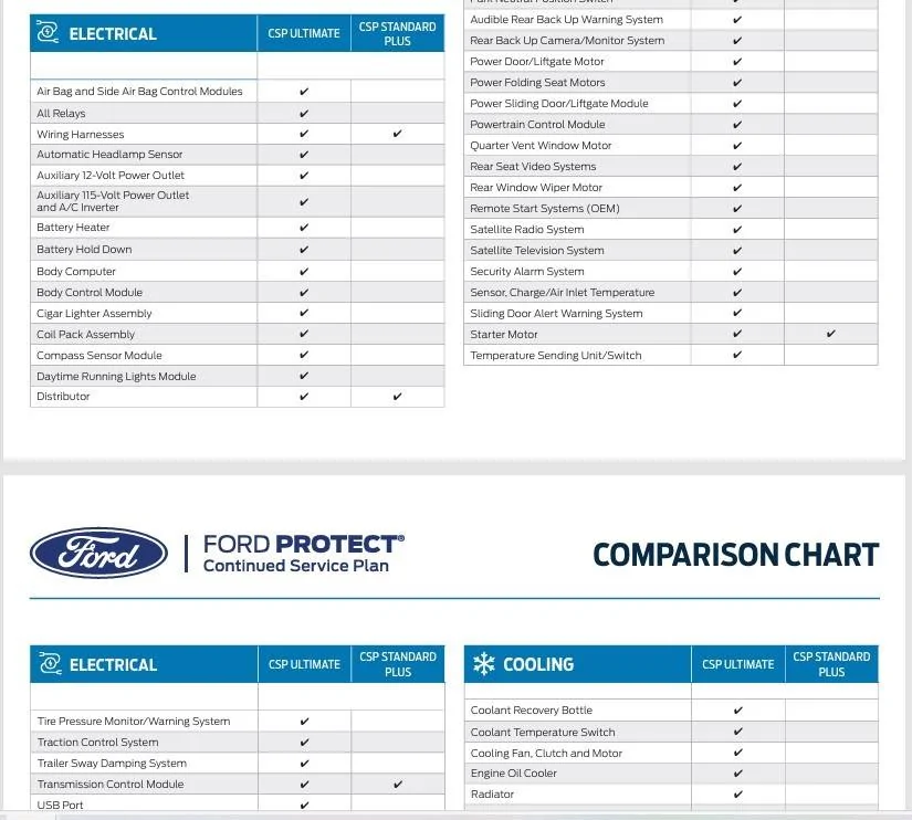

This is from my - Premium Care Plan
The OP has Premier Plus (per the OP)
I also have a 22 and purchased (Premium Care - Extended Service Plan)
So - Yes, the Airbag Module Assembly is the (Airbag)
The Diagnostic Module Assembly = RCM (Restraint Control Module) or (AKA- SDM-Module)
Sensing Diagnostic Module.
Ford calls the Airbag a (Inflater Module) or (Airbag)
So, it boils down to (WORDING) of the Premier Plus (coverage) I cannot locate the (Coverage) list for Premier Plus or any reference to that coverage (Policy/ Plan Name)
My Plan:
I think the confusion comes in as to the exact coverage that was purchased.
The Premium Care - Extended Service Plan and This One (Continued Service Plan) are the only ones that mention anything regarding Airbags.
