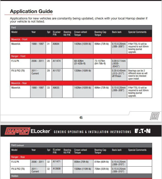

Thanks. I've looked on that site and downloaded the manuals and here's some relevant information:

So the question I've got is, what are the specifications of the front axle and differential housing?
I THINK it's a Dana 30 axle on a Spicer 200 diff housing (I know Dana and Spicer are the same company) but I haven't seen anything to confirm this completely?
