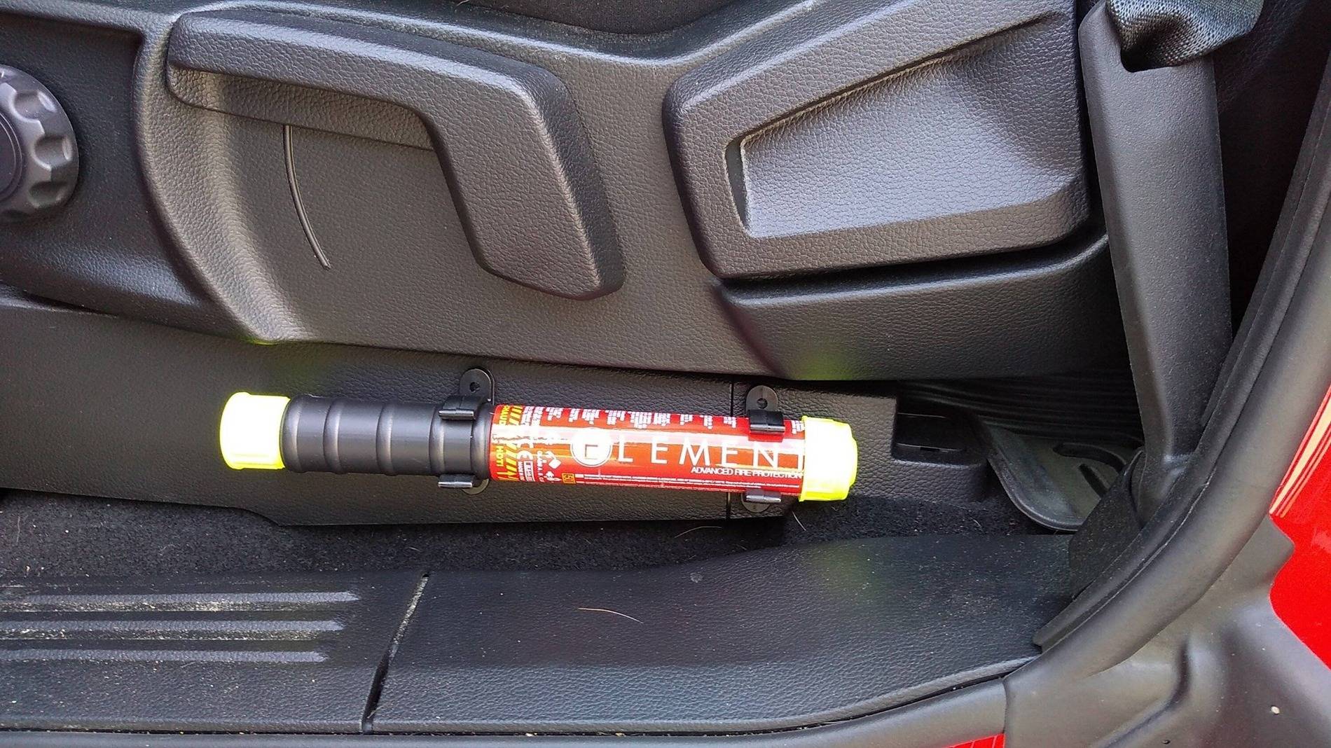

How about a tape primer pen?
https://www.amazon.com/gp/aw/d/B005LDKTV6
Designed for 3M very high bond double-backed tape.
Without the pen prep, 3M VHB lasted just over a year holding my European fire extinguishers onto the plastic at the base of the seat. That's including temps around -5 F.
And that had very little surface area.
I have the pens but have yet to reapply the brackets.
