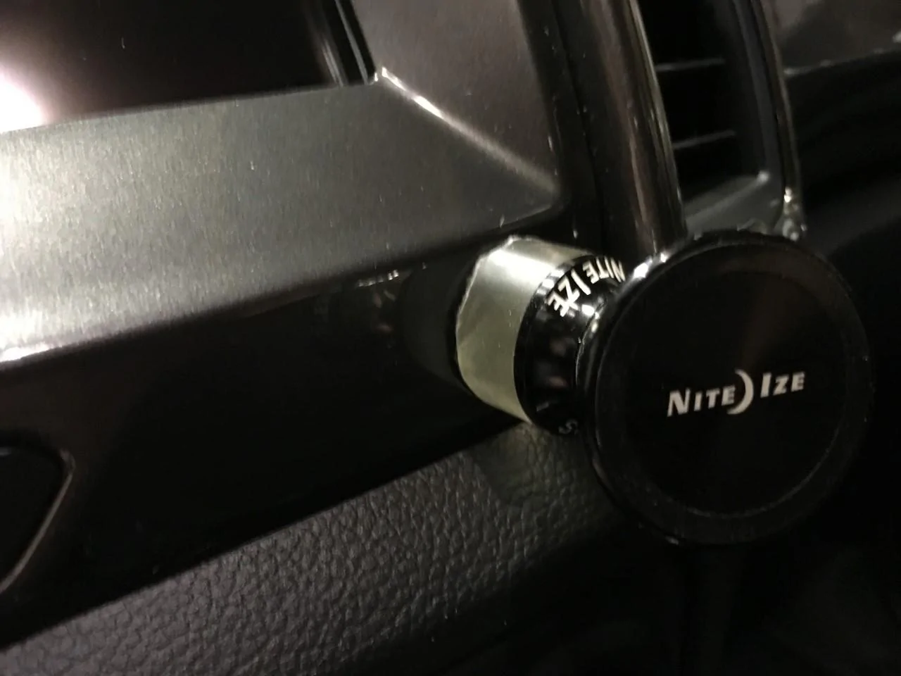

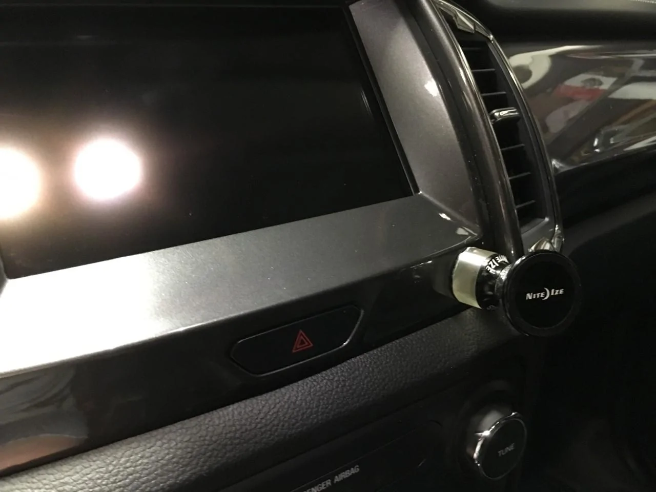

I took a standard Nite Ize Steelie Orbit and made an extension to move it out about 1/2" to gain more range of motion. I used Alumlite Amazing Clear Cast resin and a short piece of 3/4" PVC (perfect size) with tape on one end as a mold. Mixed up a small batch, poured it into the mold and let it set overnight. I wanted to be able to position my phone to avoid any glare or blinding reflections. The side that attaches to the dash is ground to fit the slight contour to get the full effect of the 3M VHB tape.
