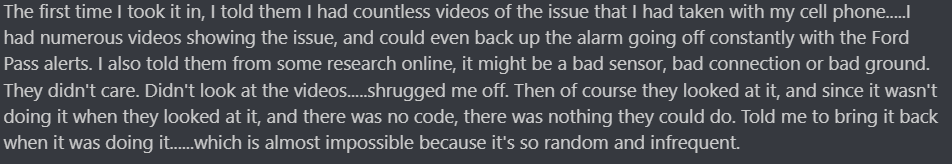

AS far as carwash - Did you have FOB in your pocket while walking around spraying? If so mine does that, except it's not the hazards it's the door unlock perimeter lights triggering. I have also noticed that if I'm in garage by the truck with FOB on me you get the occasional truck wake up, fuel pump priming sound. I think it's related to the Ford Pass app communicating with the on-board modem (as I have my cell phone on me as well) IDK, this is one of the items on my truck that I have to research WHY does it do this?
Yup, I'm pretty sure I actually did have it in my pocket. The 2nd one would have been in the truck with her.
Thanks!! I was hoping it could be something like that!
