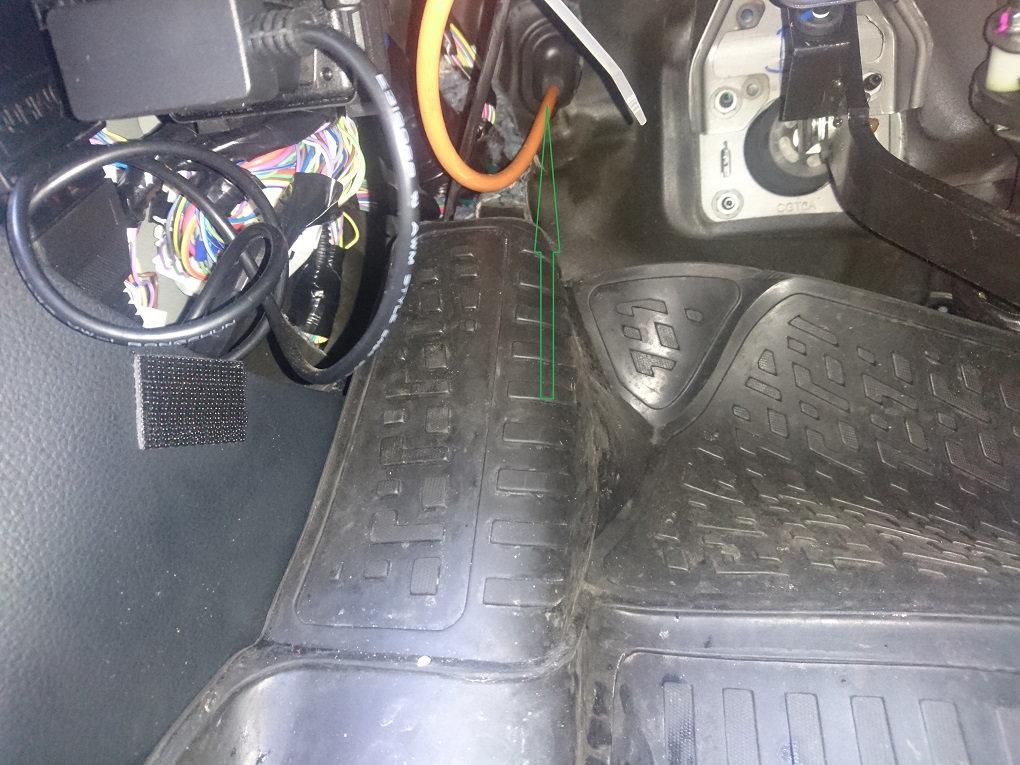

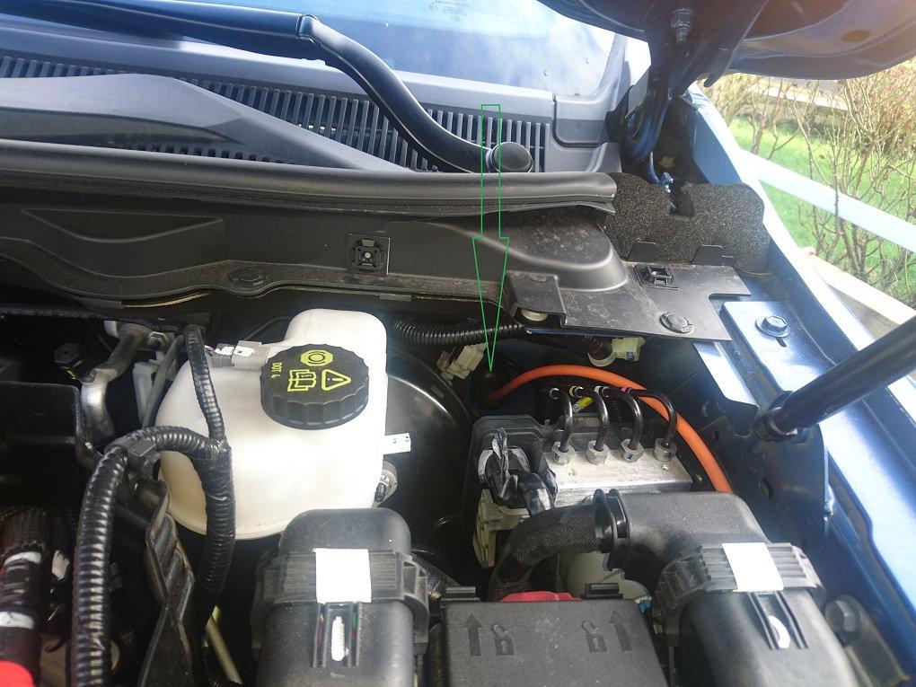

here the route instead of through the firewall (thereis a special part to go in for the cable)
Where is this? Kinda hard to tell from the photo.

2 pics more , it isa french ranger raptor (2l bi turbo diesel engin!!) it can be different from US!
incide:
motor side:

I see...need to look on the passenger side for US version...what is that orange line?

french and US car are on rigth side of the road!!
The orange line is my cable for auxiliary ligth (BD xl80) it is a flam risist cable up to 1000Ā°C

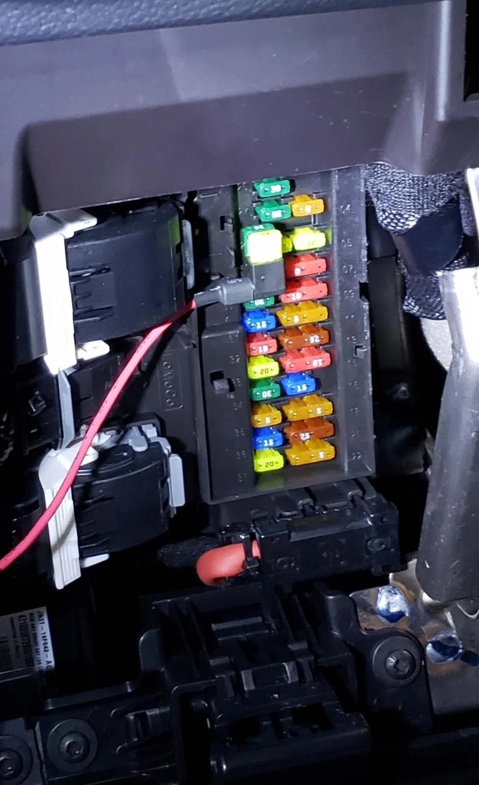

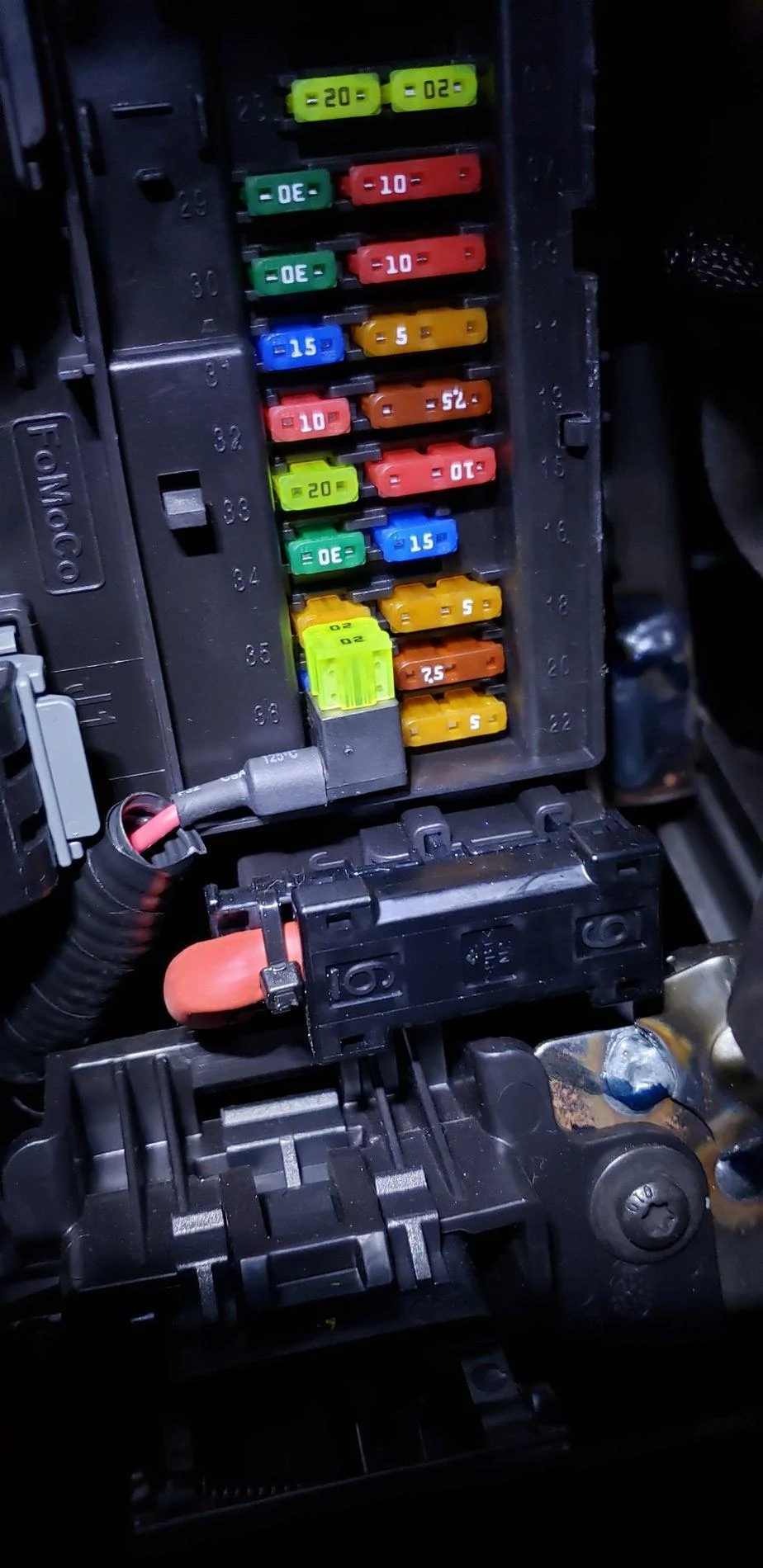

I had the windows down and left the truck in the garage for an hour came back and the lights are still going!!! Maybe I should try another fuse slot.
So were you able to confirm 33 is constant power? I started another thread looking for help to find a constant power but haven't got any help. Can anyone here help? My dash cam park mode requires a constant power, an accessory power then a ground.
I almost certain 33 is constant, since the pod lights never turned off! But I didnā€™t do too much investigation since I found a slot that wasnā€™t.

Here is my tap...

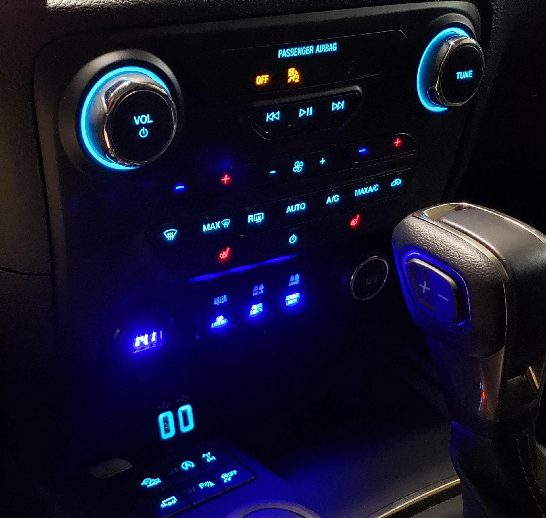

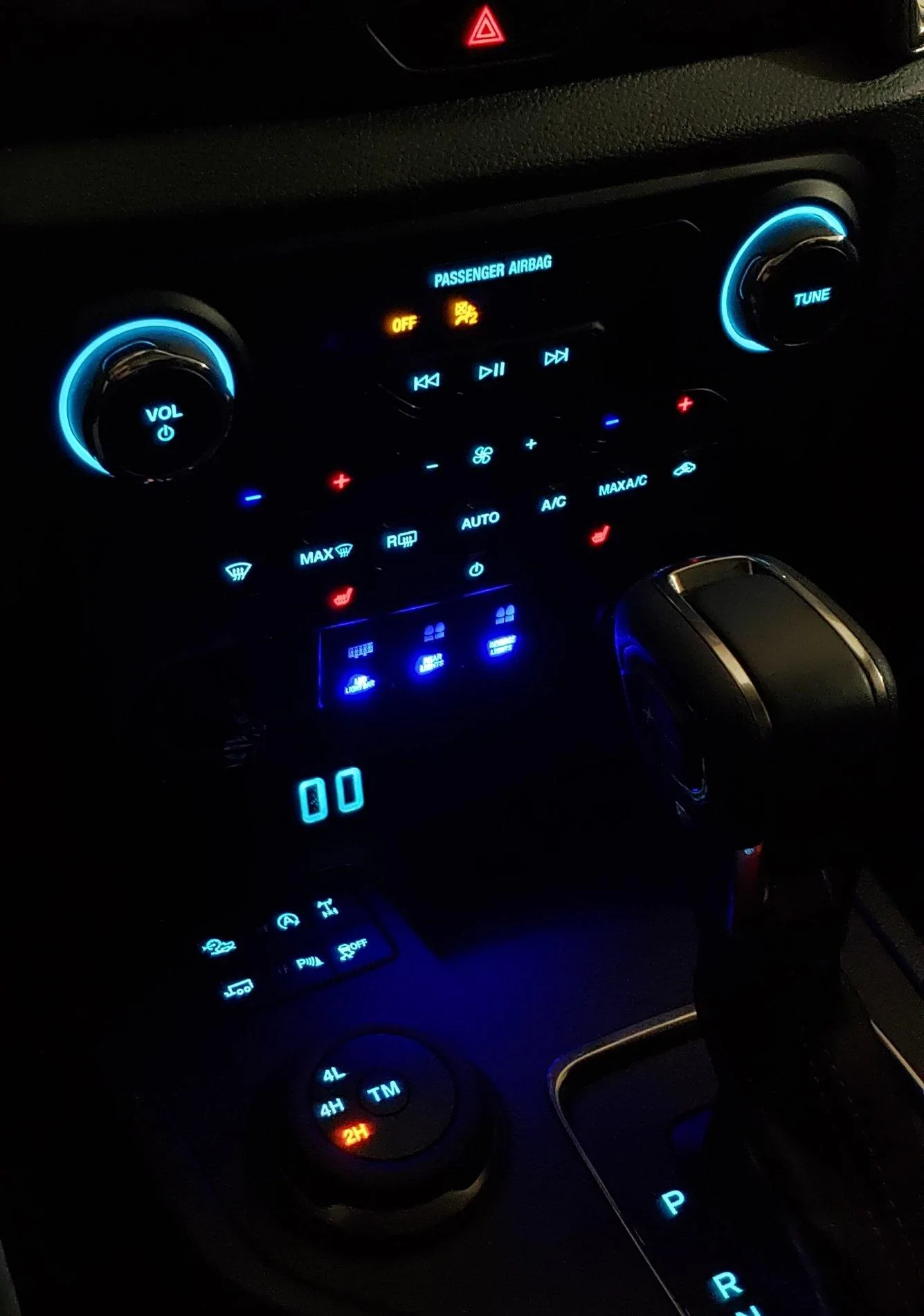

Added a voltmeter/usb. Side question... does the voltmeter LED turn off eventually?

Nm.. it shut off after awhile. It's basically a power indicator as well!
