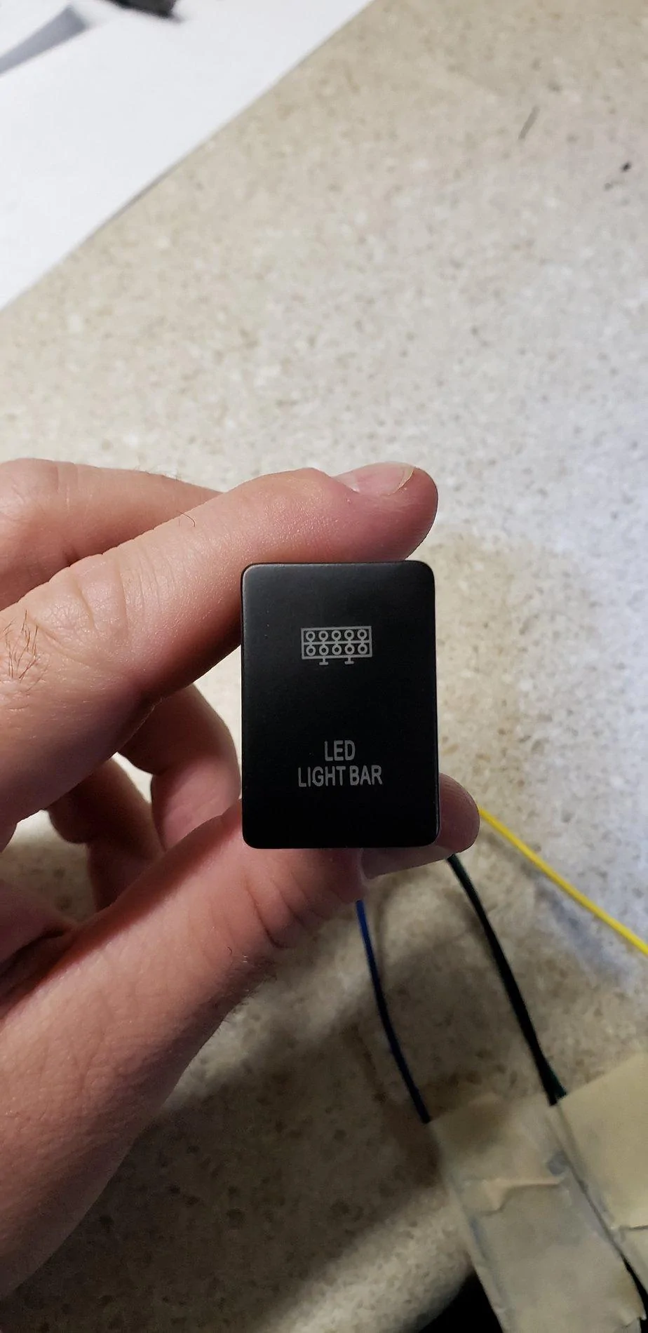

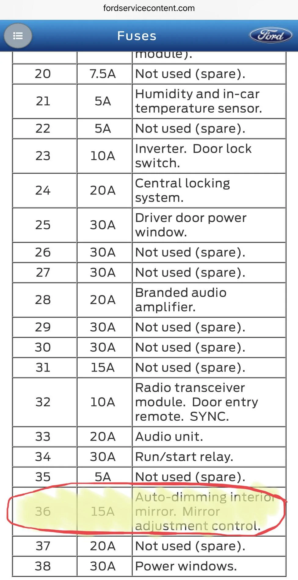

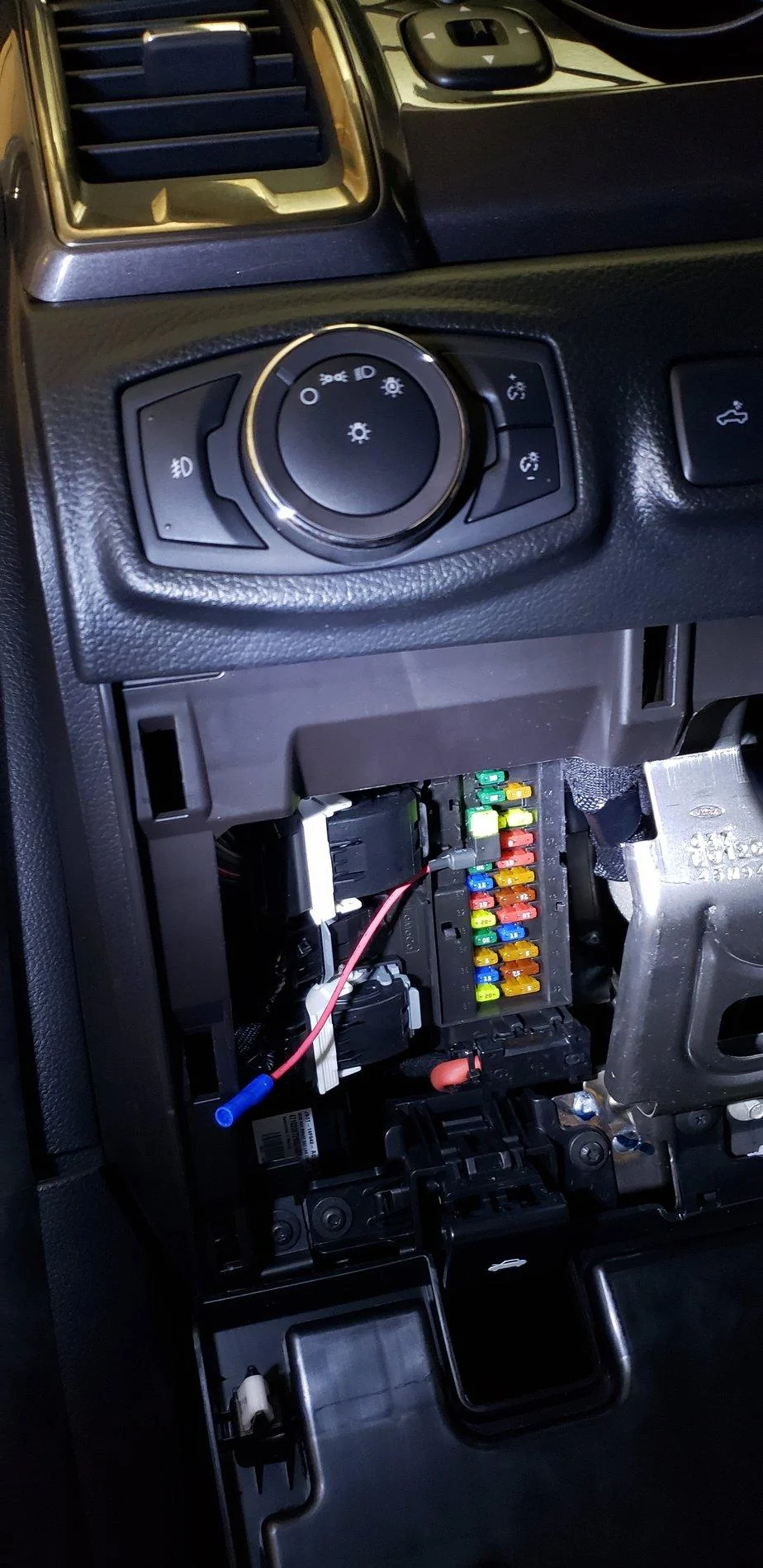

So I found the right fuse slot number 36 (auto dimming mirror, mirror adjustment) this slot is off completely when the vehicle isn’t powered on, and now my rocker switch panel isn’t on, when the truck is off!!!

@PatrickM just an FYI, you should flip your add-a-fuse the other way, the way you currently have it installed, if the fuse pops the light switch will still get power as its on the hot leg of the fuse. :like:
Oh thanks for the heads up I’ll do it right now
Fuse 37 is a spare fuse but still ignition powered.

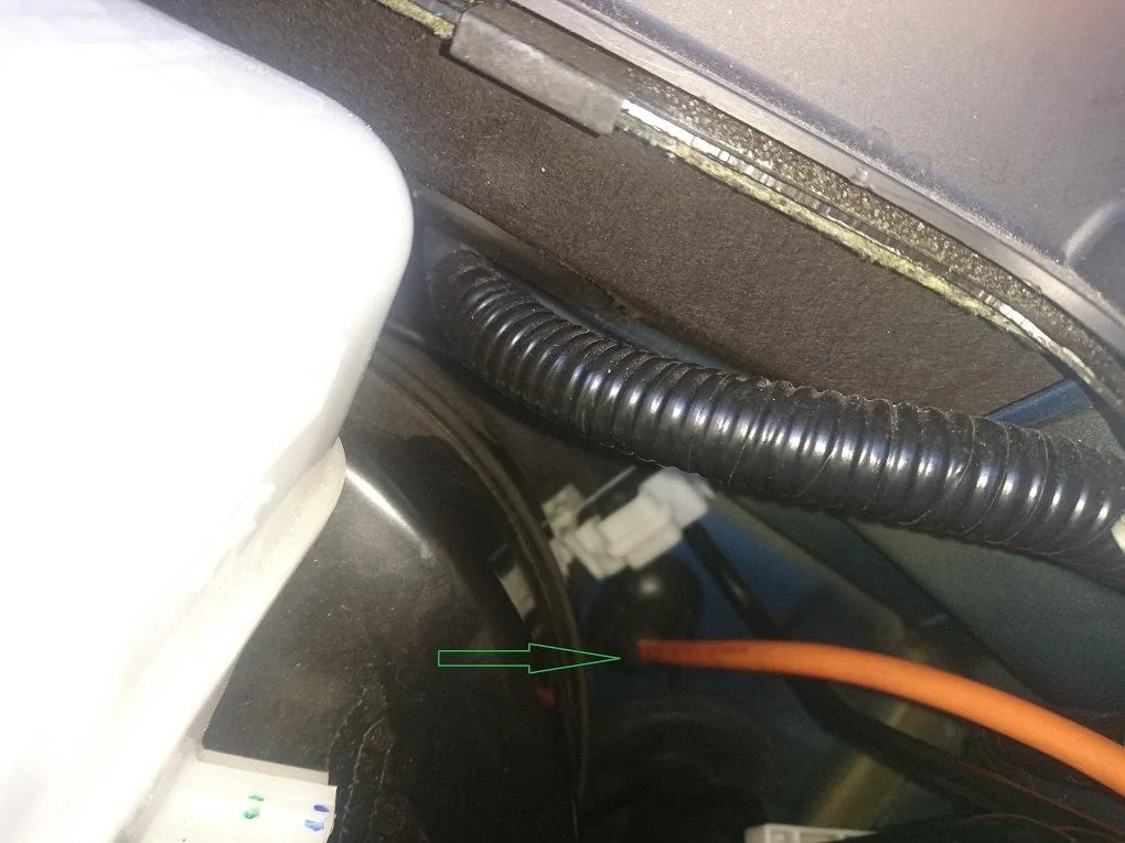

Any guidance on how you got wires into the cab? I installed some pods on the font of mine but gave up while trying to figure out how to get access to the big grommet that the factory harness comes through; when I look through the engine bay, the a/c blower motor is in the way... I just want to run a wire for my switch!! Any pictures or guidance would be GREATLY appreciated!

I did this on my 2011 Ranger also. Alternative route instead of through the firewall.

here the route instead of through the firewall (thereis a special part to go in for the cable)
