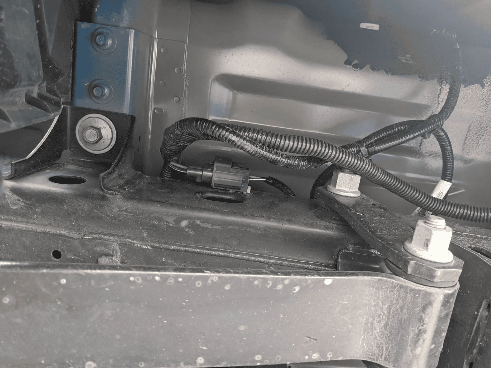

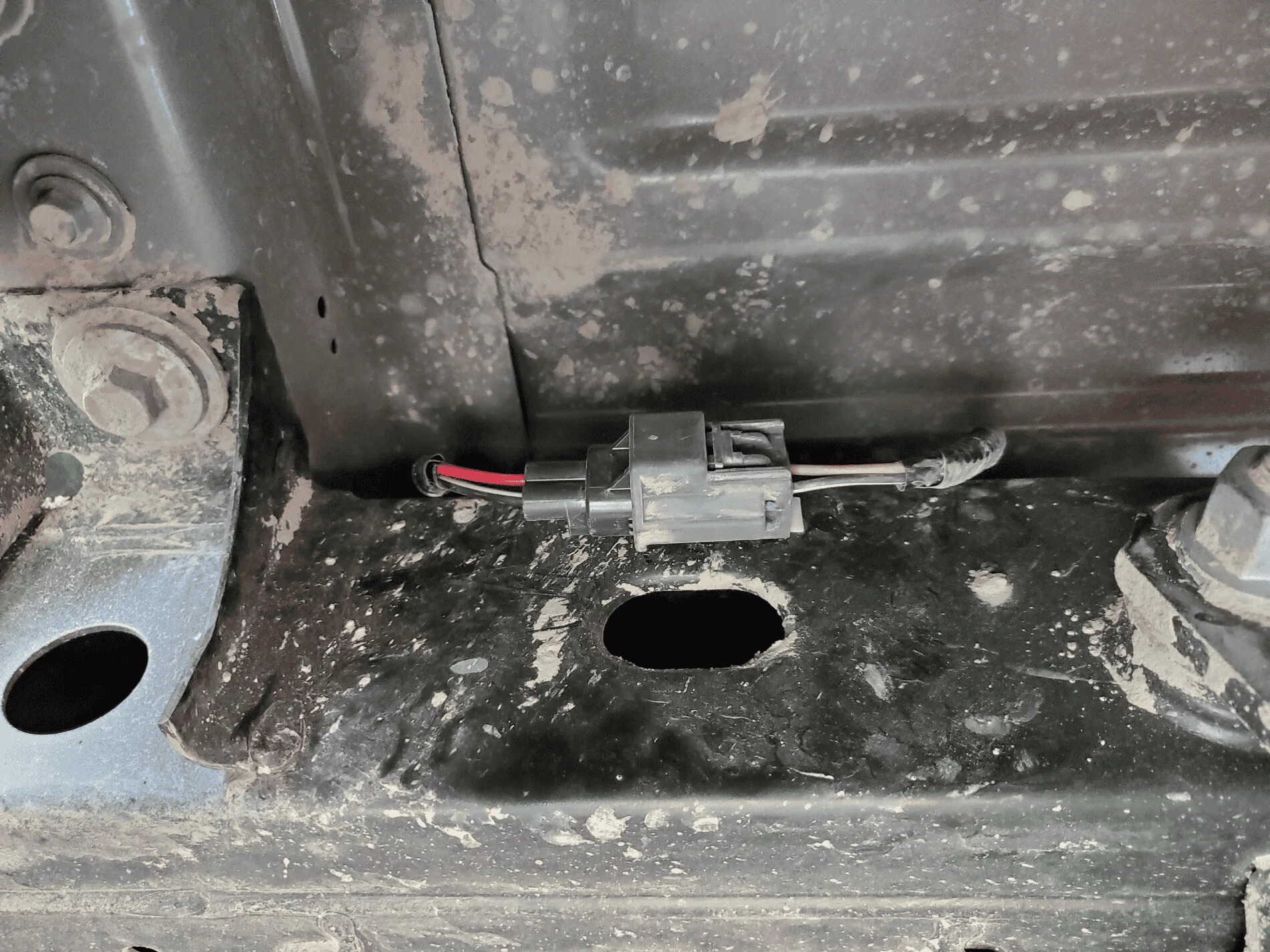

The empty power plug is exactly what I’m looking for. Where is it located? Left right somewhere in the middle?
3,426
16,339
Better late than never - here are pics from @4g63det and @gfitzge2 - the plug is on the driver side next to the bed inside the wheel well near the leaf spring hanger.
