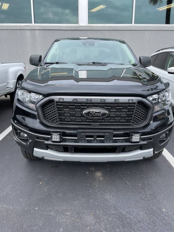

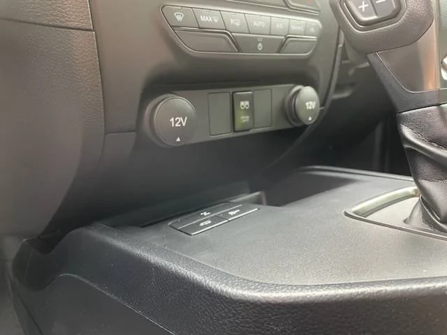

I am trying to add a set of fog lights to my xlt. I have the mount and everything I need but I am trying to find out where everyone is hiding the wires to get inside. My last question is I have 3 wires coming in and have a four wire switch. Red, black, and blue is understood and yellow is left over. Any ideas?!? I appreciate any and all help.

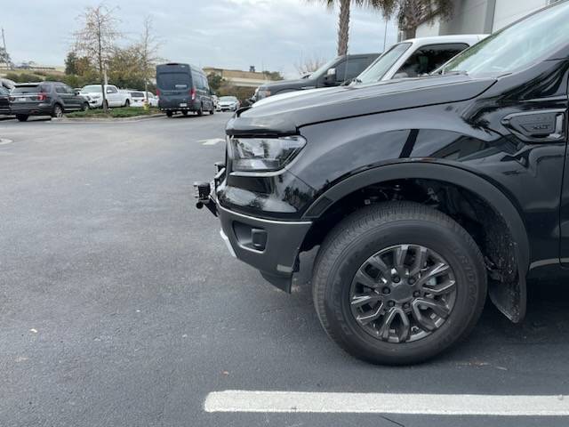

I mounted an svc bar on the front. I am mounting them on it.

Got it done all wires are hidden very well and install looks pretty damn clean if I may say so!
Thank you all for your help and input
