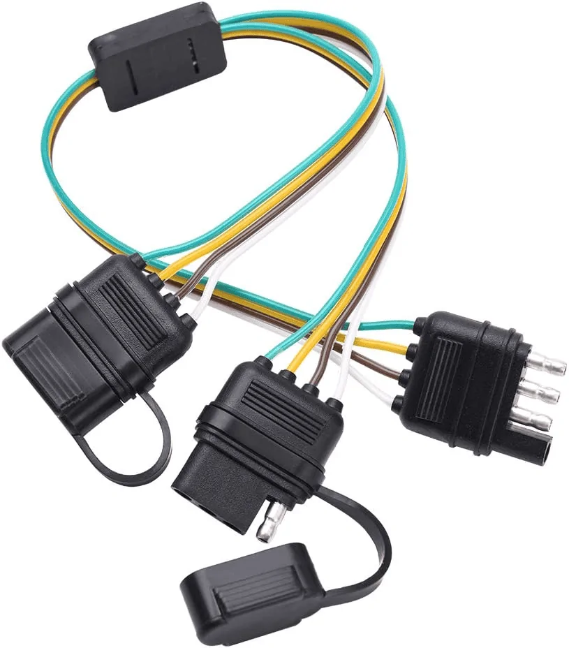

Never heard of an adapter like this (never thought about it).
But would something like this work?
https://www.amazon.com/MICTUNING-Un...Tailgate/dp/B01JCT84XY/ref=asc_df_B01JCT84XY/
Conceptually close but not quite...

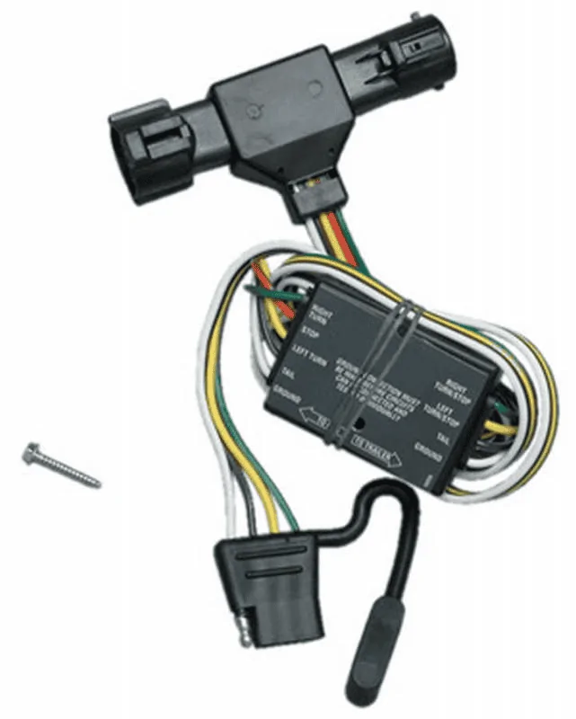

This is how the after market trailer lights on my 93 Ranger worked and I got it from Walmart. Imagine the plugs where your harnesses meet. You unplug them and then plug something in between them that has a tap out on it.
Like this.
That's how these aftermarket add on lights should be working.
You pay $300 for a light kit but it T-Taps into an existing line? Cuts the insulation? Causes a failure point that will bite you in 3 to 5 years? No bueno.
But if you use this type of a harness tap then you maintain the integrity of water tight connections and can use heat shrink on what ever you do with the wires that come out of it.
AND!!! If you are adding a LOT of lights, more amperage than the wire will hold, you just use a relay on that line and then string a new power line from the battery. Zip tie it along side the harness as it runs down the frame to the lights. Simple, easy clean.
Like this.
