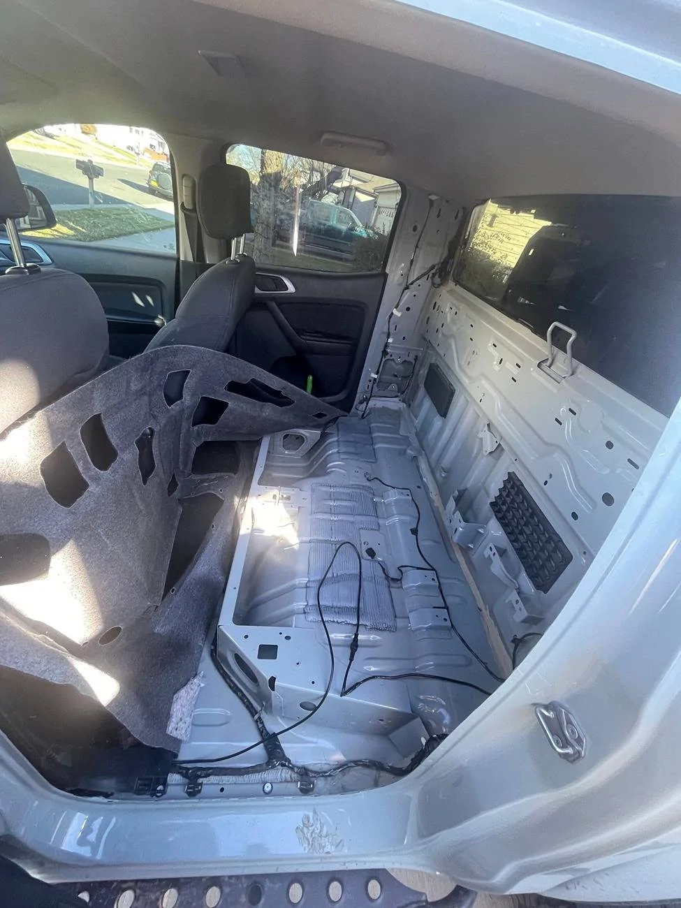

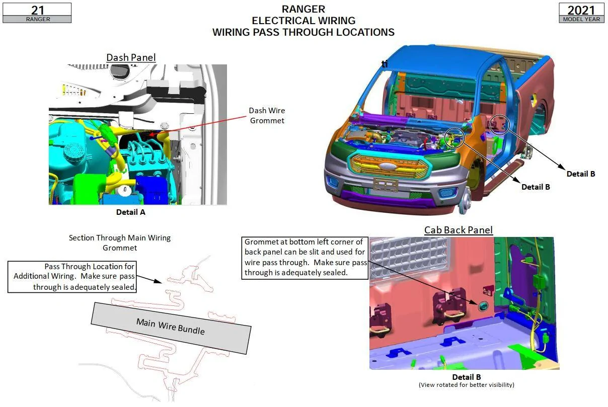

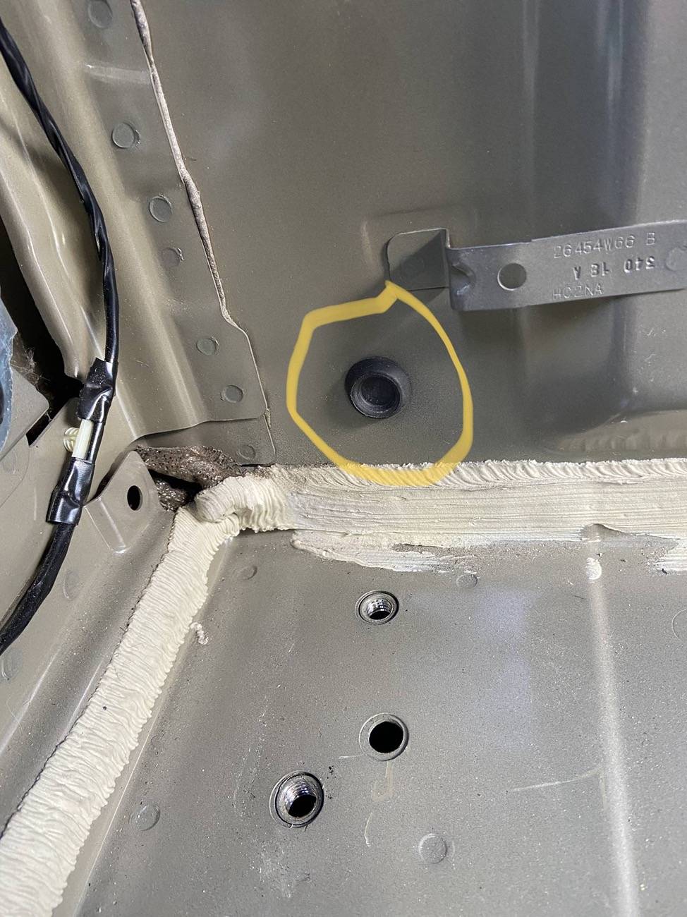

Here is another shot (Borrowed Pic)
If you zoom in - its in the lower corner RH
A little confusing on if there is a grommet on both sides or just the (Right) as these 2 diagram / pics give conflicting info a opened up pic for the left rear seat does not show a grommet that can be seen anyway.
