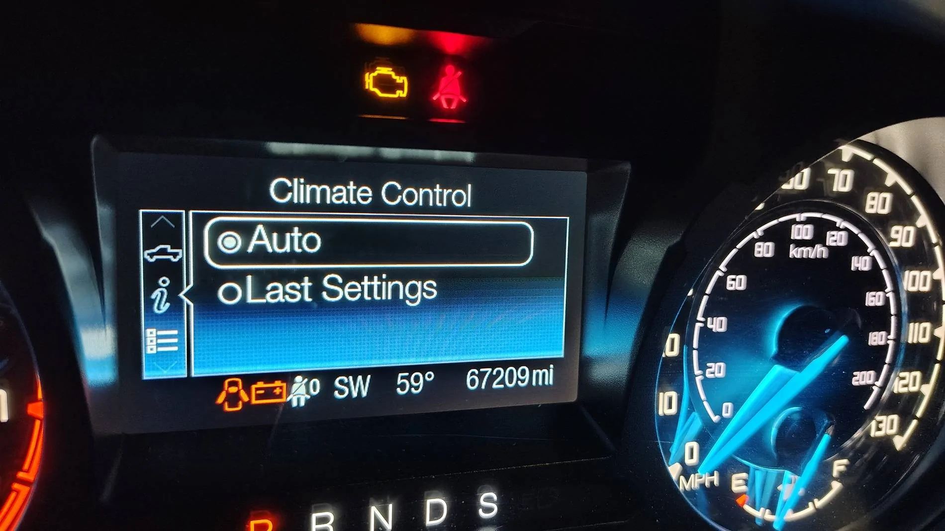

Are you changing the settings via the steering wheel control (in the truck menu)? There are two options in the menu "Automatic" and something like "Last Set"
None of the controls on the dash should have any effect when it has been remotely started.

You need to choose in the menu whether you want the truck to use the last settings you had, or if you want it to take its best guss and do it automatically.
If you pick 'last setting' from that menu the truck will crank with the last settings you left it at, but you still won't be able to change anything. You'll have to set the climate control the way you want it to be on your next remote start before you shut the truck off.

Try deselecting the (Climate - Option) to off to disable it, cycle the ignition and then reselect it (Either Auto or Last Setting) as I am thinking this data is not being transmitted to the FCIM, when you cycle the key (after remote start) the IPC and FCIM data are not syncing together.

I believe that fixed it! Thank you!
