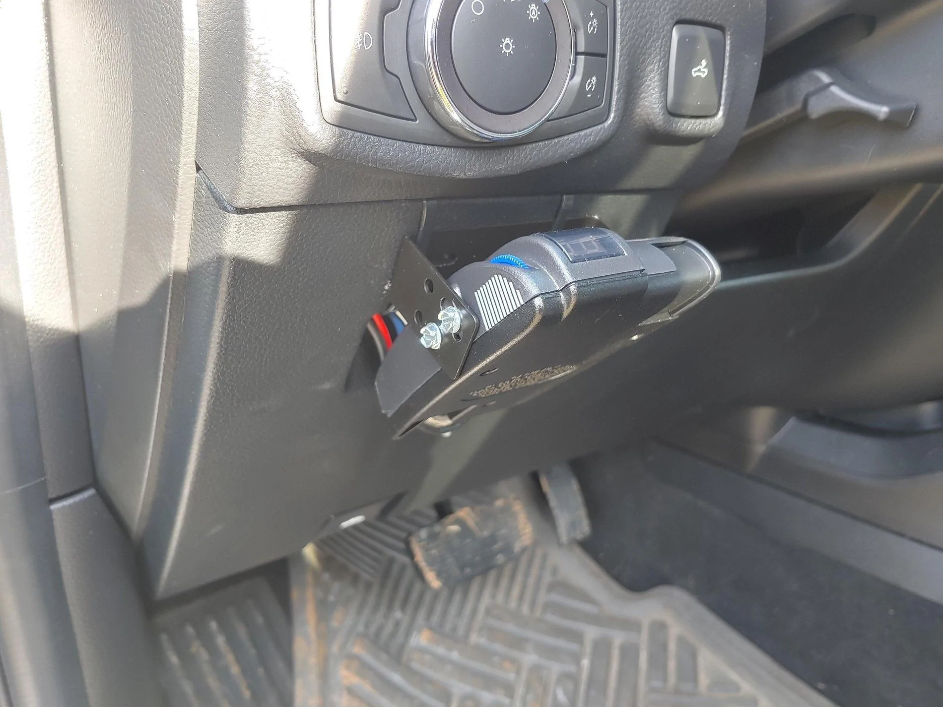

I talked to my dealer nothing good came out of it .I did call a company about what they sold the tech guy said to use this one primus IQ part # 90160 has anyone used this one thanks
Yes, it works well. The hardest part is dealing with the short length of the tow package wires to extend them.

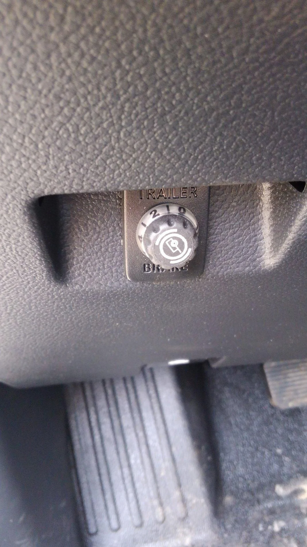

My 2019 is at the dealer as we speak for the factory Ford TBC install. Funny, I asked the Service Drone about the manual GAIN knob, and he didn't know, he went to one of the mechanics, he didn't know, so we both went to the Parts Dept and asked, and his system only showed the the TBC box as the only part included (which I got from the dealer when I got the truck in December).
So...is there a knob or slider for the factory Ford controller? I'm skimming 15 pages of this post and haven't seen one yet.
Thanks.
I believe this is what you're asking about yes it comes with the Ford controller.
This is what i got from Ford. Sort for the fuzzy, it's a frame shot from a video I am making.
