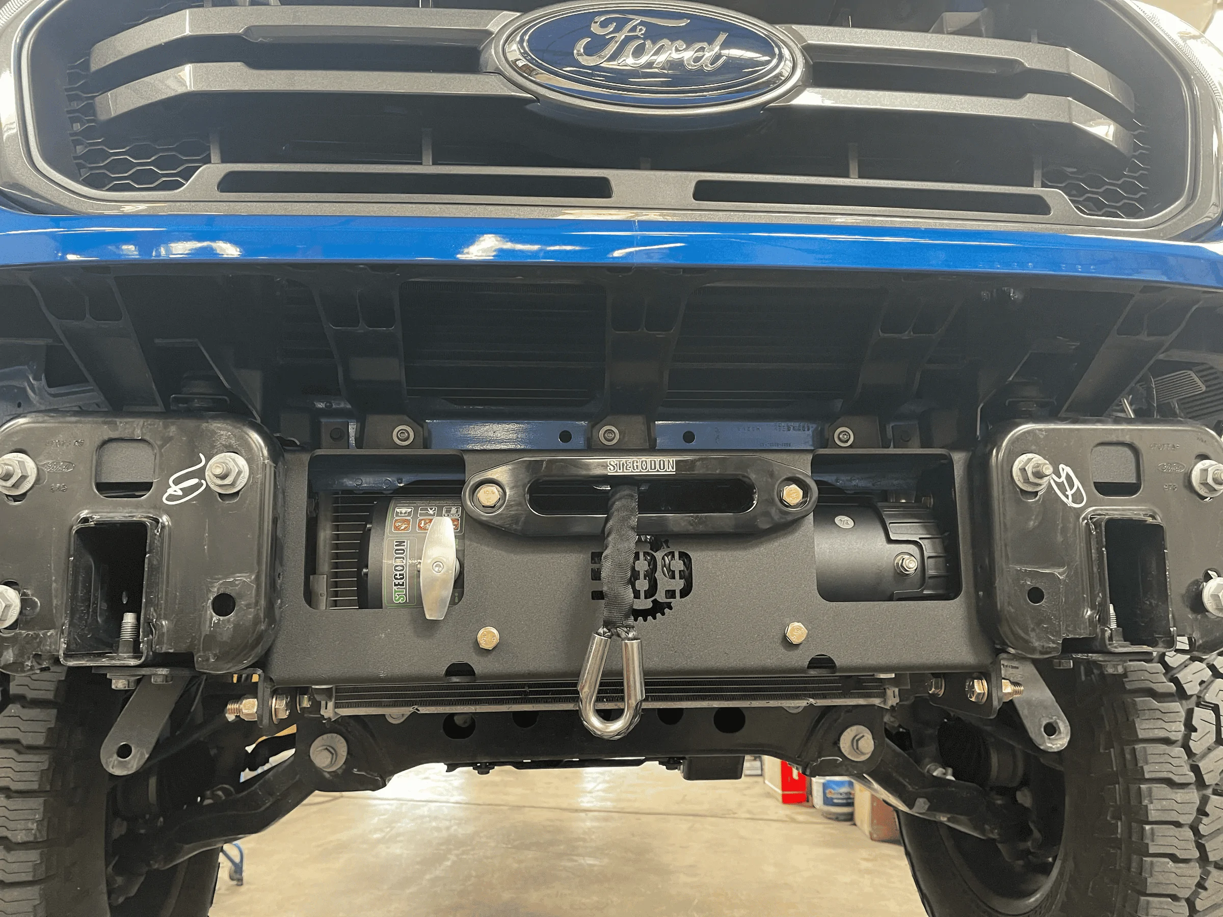

The mount works great and the winch fit perfect with the stock bumper intact. had to make a custom bracket for the winch controller instead of making new leads. Still working on a bracket for the adaptive cruise control.
There are plenty of other pictures online and in the forums of the winch/plate installed. Looks very clean and is pushed back nicely.
this looks sweet. does the ACC need to be calibrated after relocating?
Socal Steve
Stephen
Mar 21, 2021
Southern California
2019 Ford Ranger XLT
Healthcare
As far as I know it does not need special calibration, just releveling as you would do after a lift/level.
