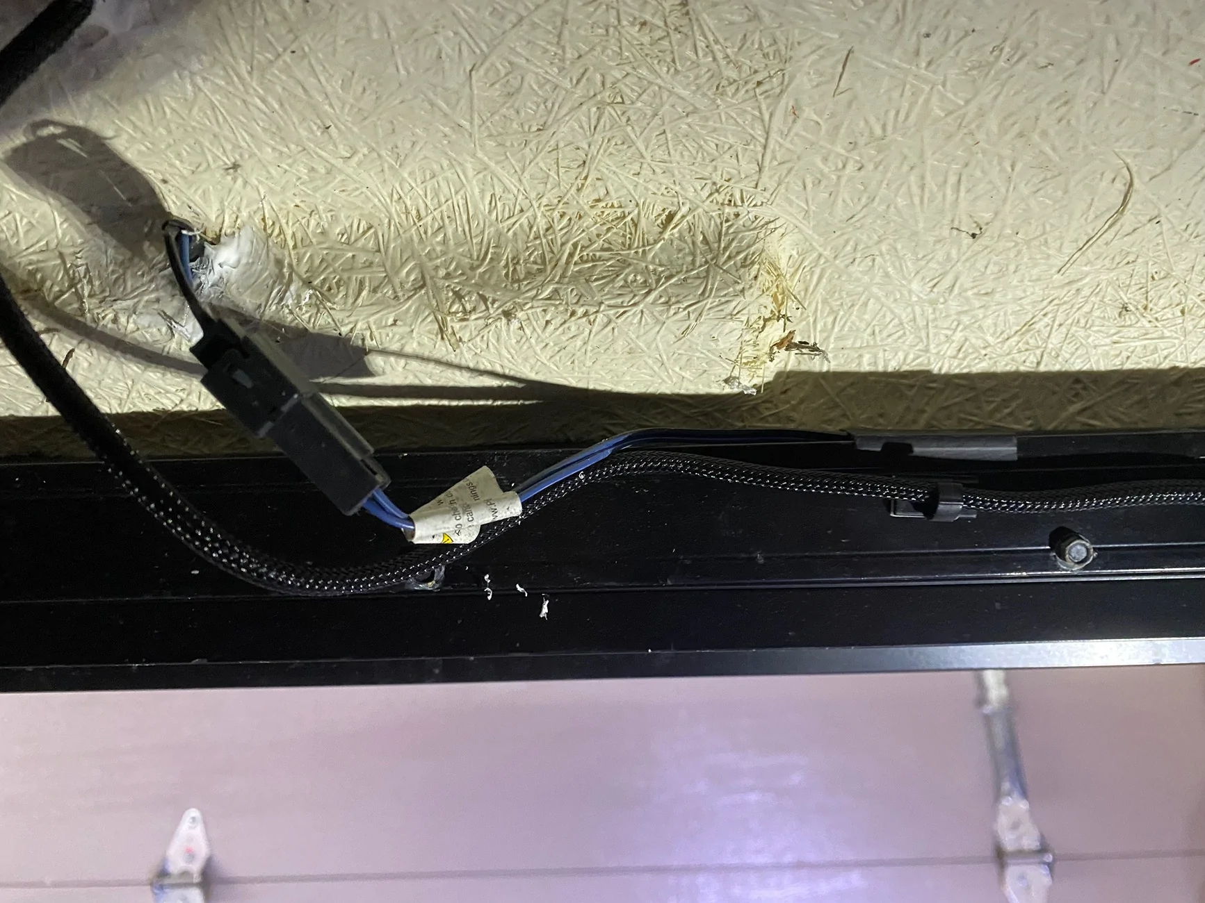

No problem. Does the wiring coming out of the canopy’s brake light look like this. (Not the braided stuff)
No it's just 2 wires, 1 blue, 1 black, when I apply power to each, the 2rd brake light comes on, no matter the wire, the brightness is the same

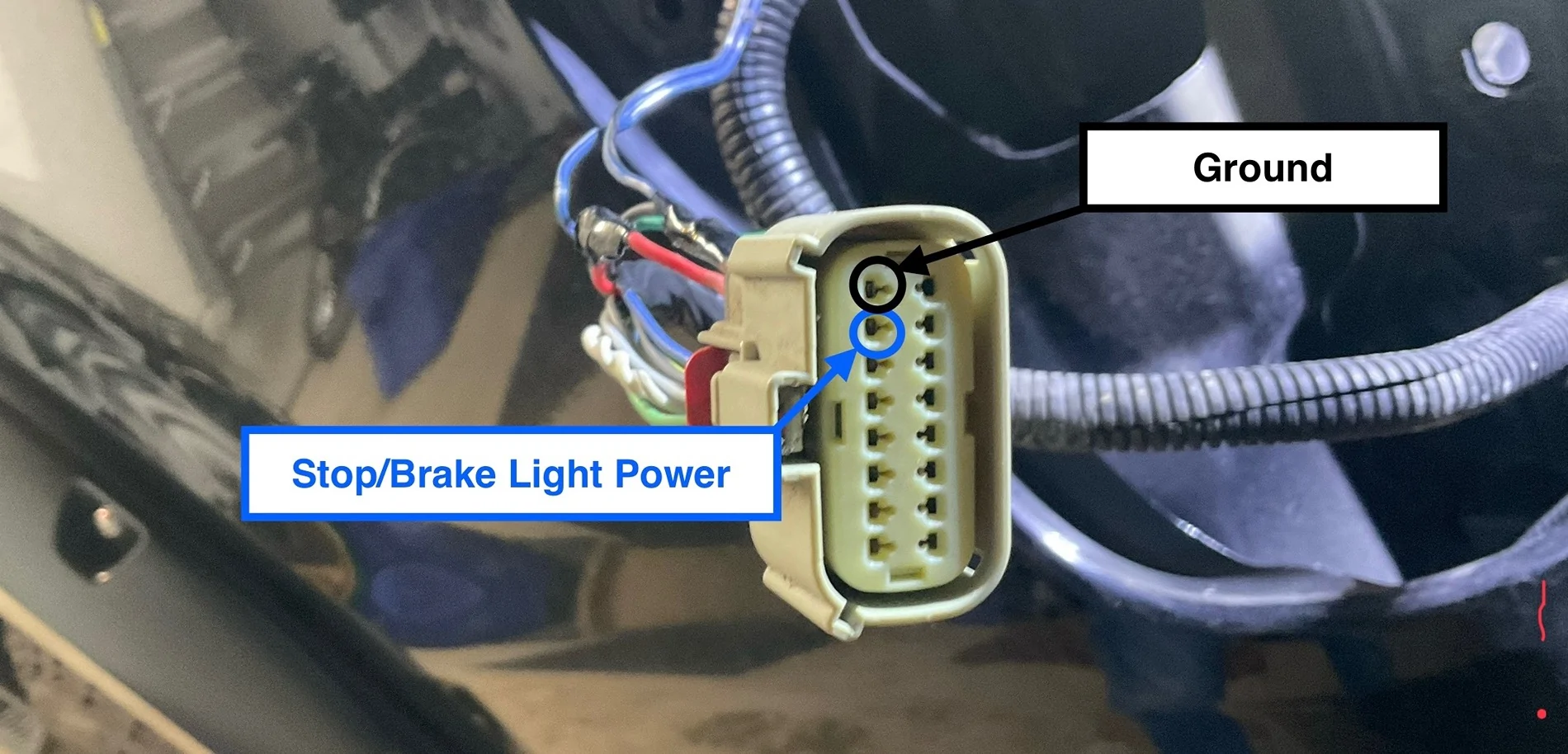

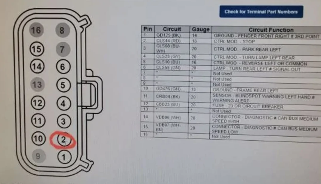

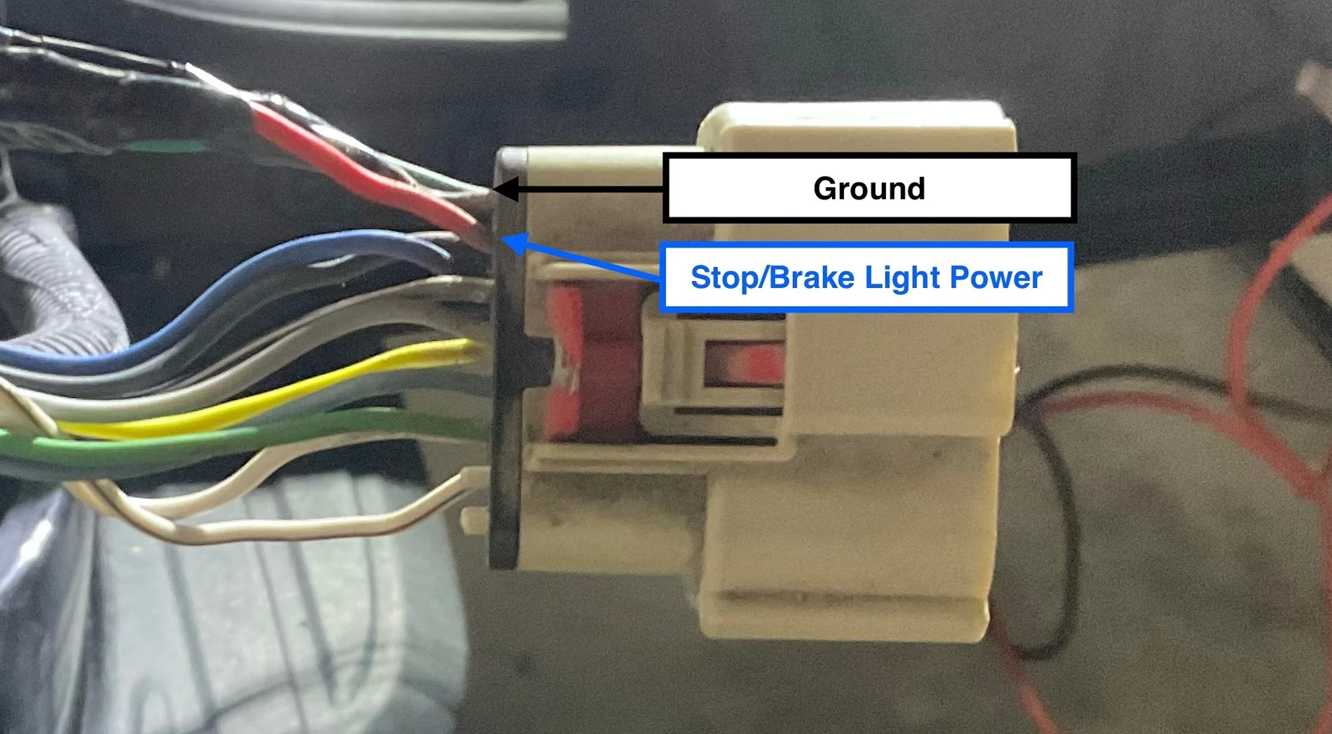

Mine has two wires - 1 blue, 1 blue with black stripe.
Blue wire is tapped to Brake Power at the taillight connector
Blue with black stripe is tapped to Ground at the taillight connector
