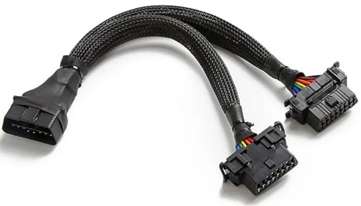

Just a note on the OBDII port being used by the steps. I use Forscan and Diagnostic tools too often to block the OBDII port so I installed an OBDII "Y" splitter cable to keep a free OBDIII port in the stock location.
Simply remove the the OBDII port from the stock location, plug in the Y cable, Plug the AMP steps into one leg and install the other leg in the stock location. I think I paid $10 for the OBDII splitter.

I just got around to reading this thread, and see you have already solved your problem.
I do like the AMP steps. Not had a problem with them in 5 years of usage.
Just saw this. Thanks! I ended up getting a smaller version of this, but the same idea. My truck is an ongoing project, so I'm having to unplug the power step connection when I'm using Forscan or flashing the ECU for performance tuning since the OBD signal gets noisy with multiple devices trying to communicate. A small hassle, but can live with it.
