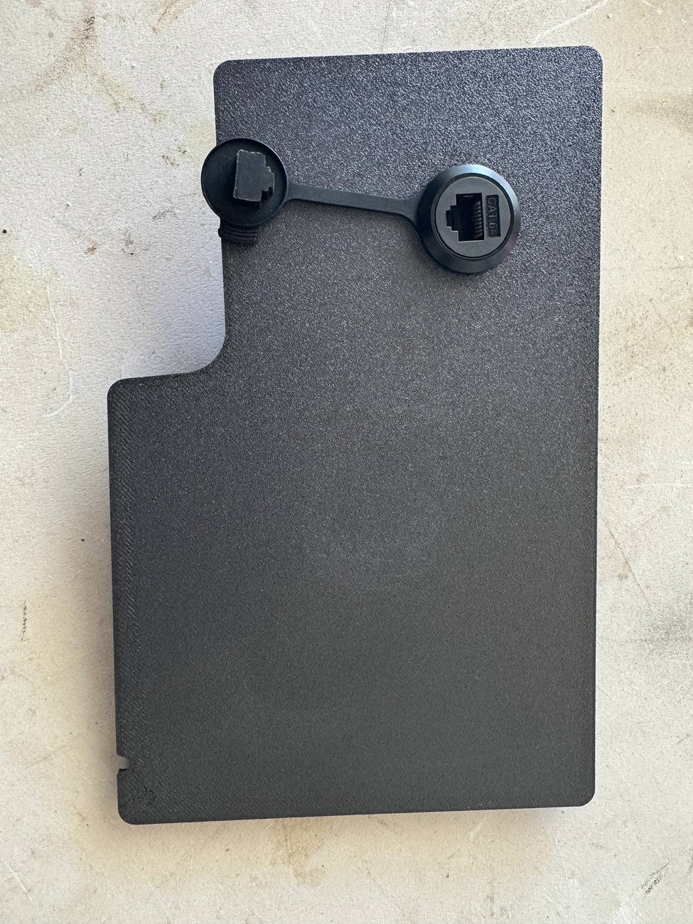

I've got a bunch of crap hard mounted in the center cubby and need a cover. Thought I would integrate my HAM radio mic mount into it. Work in progress, but I am happy with how its coming out.
Shoutout to @Griffin_W for the base STL file to get started. There will probably be some redesigns and more items get integrated (not sure what yet, but... I have the freedom to do what I want.

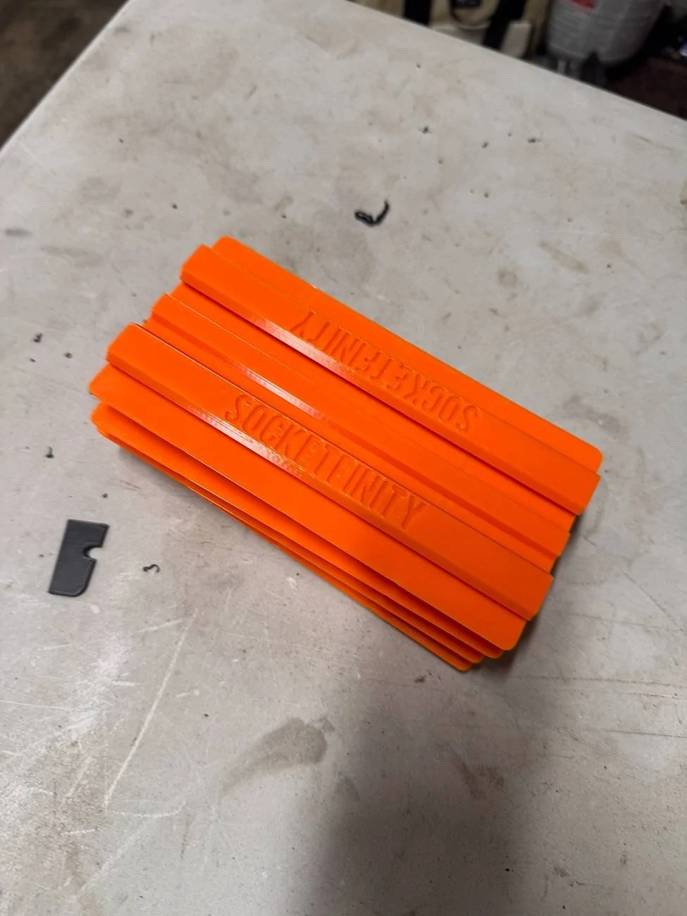

I’m printing orange bases for my metric sockets. It’ll help me distinguish metric vs standard in the drawer.
Love it! Such a solid idea! Great outcome!!

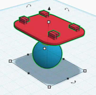

I printed a tool to twist the pins of my Maxtrax mount. It makes it a ton easier to twist them.

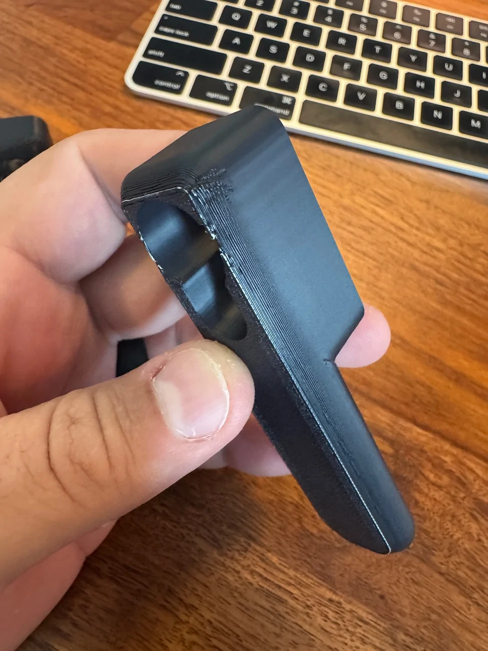

I also designed this mount for the baby camera in my truck. I hated the suction cup window mount. Printed at 100% infill using ASA. Its held up great so far. No sagging, no drooping.

Good Idea!
I find ASA brilliant, most of the benefits of ABS without most of the warping problems and better UV protection. But contrary to popular belief I've found PLA+ to be far better out in the weather than people give it credit for. But PLA is not so good for intruck use, not with our summer temps anyway.
I printed a part in for in the truck out of PLA+ and it held up great until is warped hard. The truck was at the dealer and sat outside for several days. PLA couldn't handle that.
Yes I printed a new sunvisor clip for my sons Kia Sportage, which similarly held up well all winter but warped come summer, particularly as it is a black car.

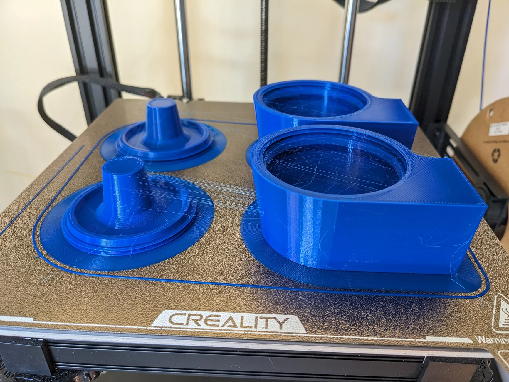

However I made some PLA replacement rubble drain grates after one of ours got clipped by the ride on and broken, and 3 years later they are still holding up well out in full weather. I printed them in bright blue so they could be easily seen if a storm pops them out of the drain overflow. ( the originals were grey)

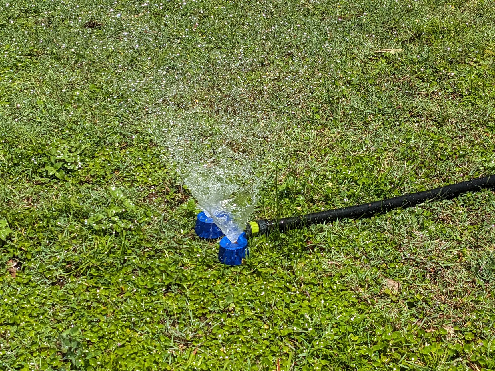

Similarly I made a couple of PLA+ sprinklers for our home sewage plant because I was sick of having to remove the metal ones and back wash them every time the nozzle got blocked. The new ones have a screw in back which you can unscrew with a coin and just wash them out, they also don't corrode.
They've been working well with chlorinated waste water and out in full sun for a year now. I made two sets of spares in case they didn't last but I think I may never have to make another. Also for some strange reason these seem to never block - I think maybe the metal ones used to corrode internally, creating a rough surface which used to catch small debris until it built up a blockage. Certainly I used to have to replace them every few years because they would eventually corrode through.
