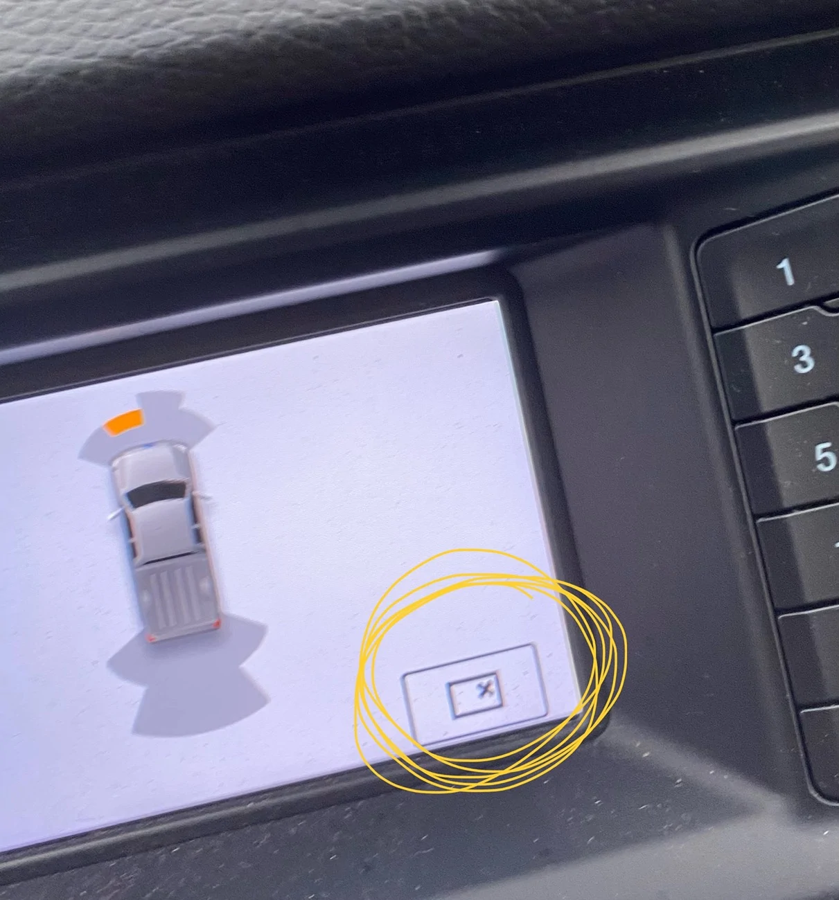

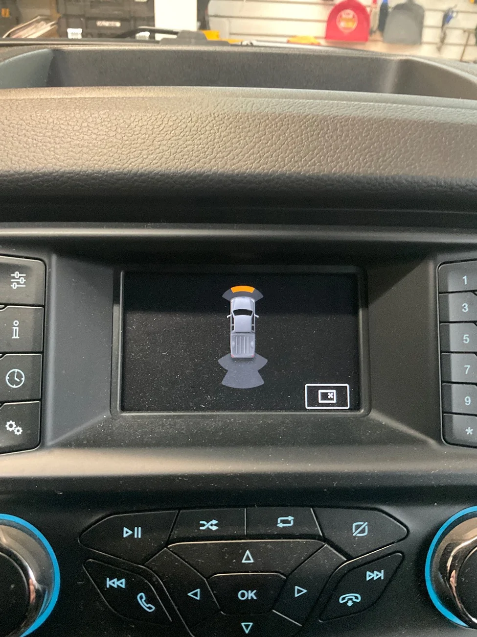

My 2019 XLT has the 300A package (4ā€ non-touchscreen display). It shows typical infotainment stuff including backup camera image and parking sensor warnings.
When the backup camera image is displayed, there are small icons on the lower left of the screen. They have a real purpose and are interactive - you can use them and arrow buttons to toggle between regular view and a closeup on the hitch receiver area when backing up to a trailer. Handy, right?
When the parking sensors detect an object, an image of the truck is displayed with graphics showing which sensors are pinging. On the bottom right of the display, there is a small icon. As with the backup camera icons, I expected it to have some sort of meaning and to be interactive.
Instead, it just appears like an online image that can’t be located and just has that goofy ā€œxā€. And, yes, like a dumbass, I tried pressing it with my finger. šŸ¤¦ā€ā™‚ļø
Any ideas? šŸ¤·ā€ā™‚ļø
On a positive note, the image of the truck is a SuperCab, unlike the SuperCrew image for Lane Keeping Assist and Door Ajar on the instrument cluster.

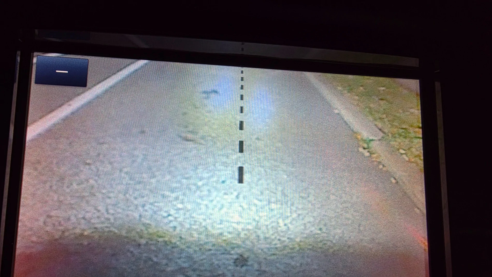

Actually, it a zoom in button, or at least it is on my Lariat... I just noticed it a couple months ago after 5 years of ownership. I guess it was/is intended for when trying to hook up to a trailer...
Page 181 of Owners manual
Manual Zoom
WARNING
: When manual zoom
is on, the full area behind your vehicle
may not show. Be aware of your
surroundings when using the manual
zoom feature.
Note: Manual zoom is only available when
the transmission is in reverse (R).
Note: Only the centerline shows when you
enable manual zoom.
Selectable settings for this feature are
zoom in (+) and zoom out (-). Press the
symbol on the camera screen to change
the view. The default setting is zoom off.
This allows you to get a closer view of an
object behind your vehicle. The zoomed
image keeps the bumper in the image to
provide a reference. The zoom is only
active while the transmission is in reverse
(R).

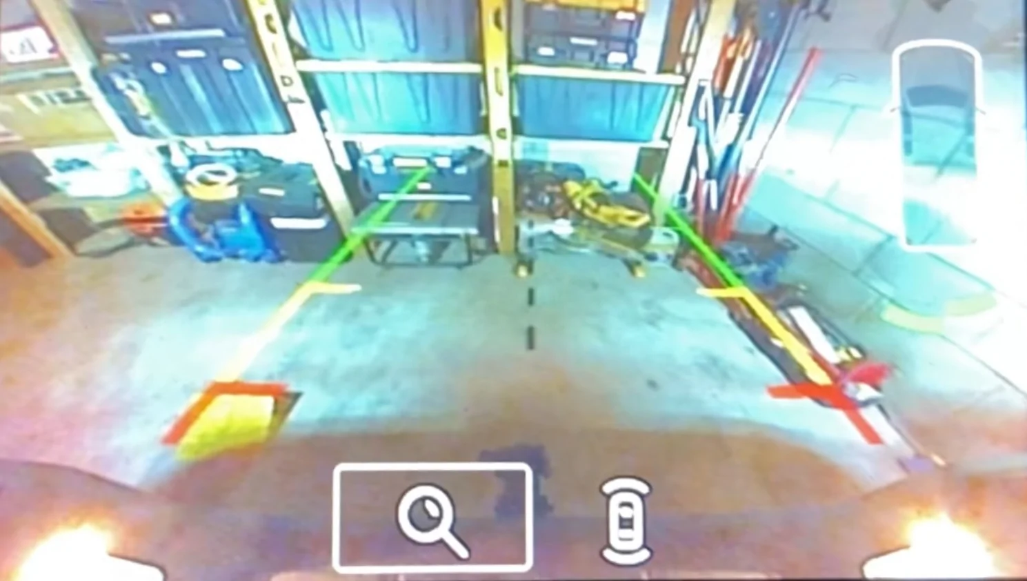

Just to confirm - This screen is the (Reverse Back-Up) Camera screen and when the parking sensors trigger - the back-up cam image disappears, and you see this screen.
If you are in drive - and the park sensor triggers - do you see the same (X)?
For the Lariat 8in screen, both the rear camera and truck image (upper RH Corner) with the park sensors are combined in the same screen.
When in drive - you get the windowed screen like you have posted (park sensors-trigger)
If this is the rear cam view and park sensor trigger, I would say it is supposed to be a way to (x) close the screen and back to the rear camera view.
Someone else with the same 4in screen may be able to confirm.

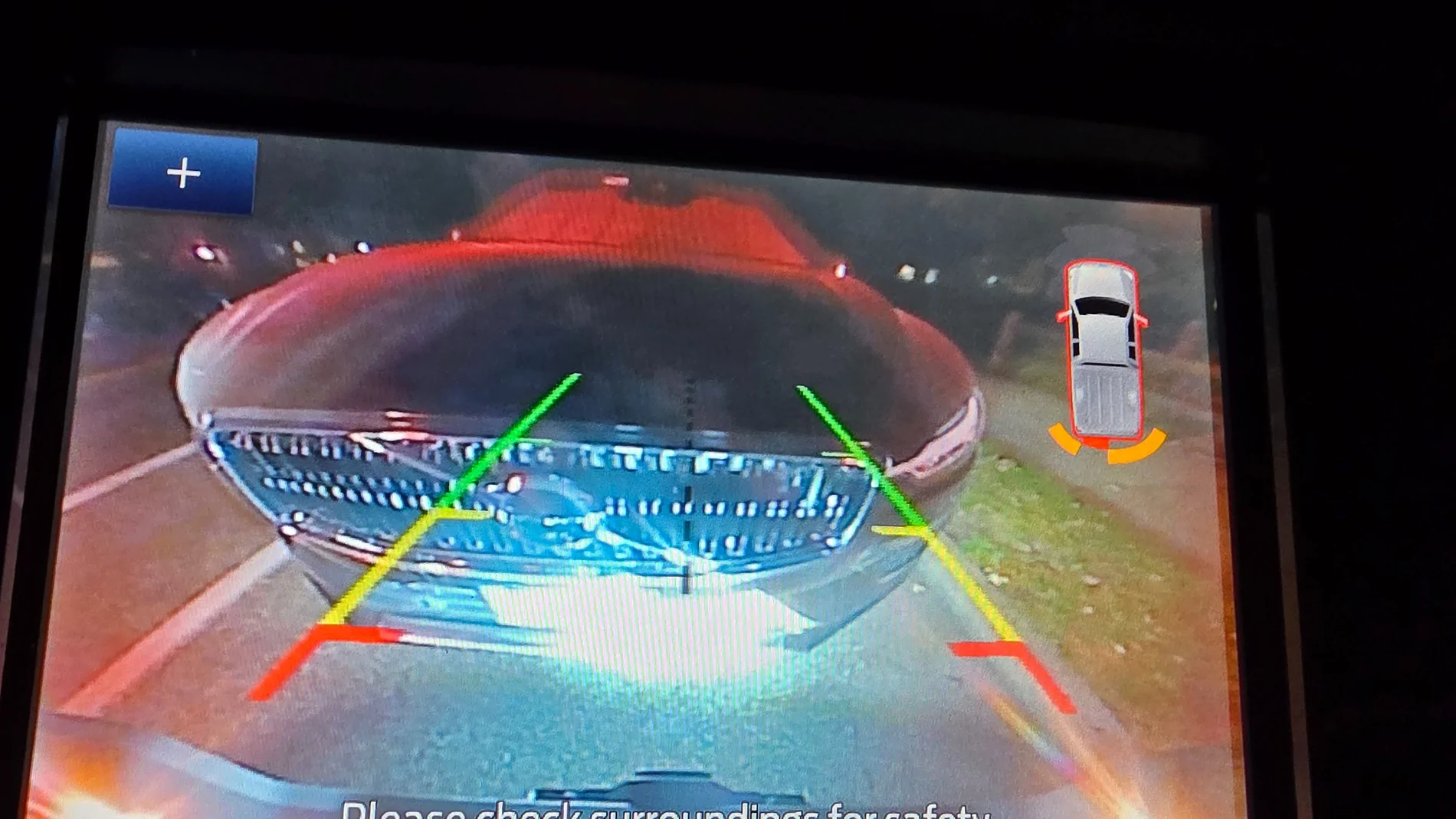

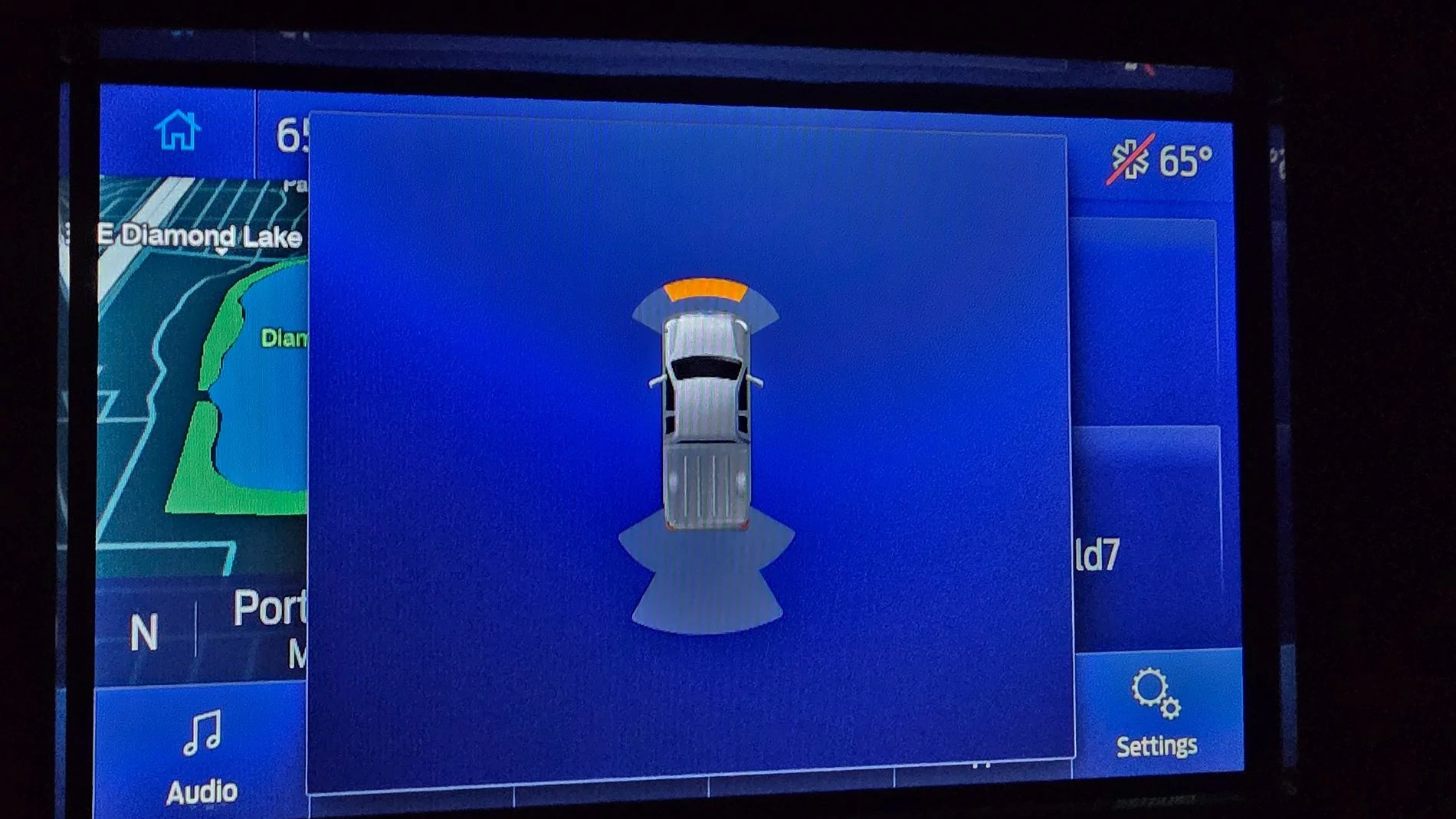

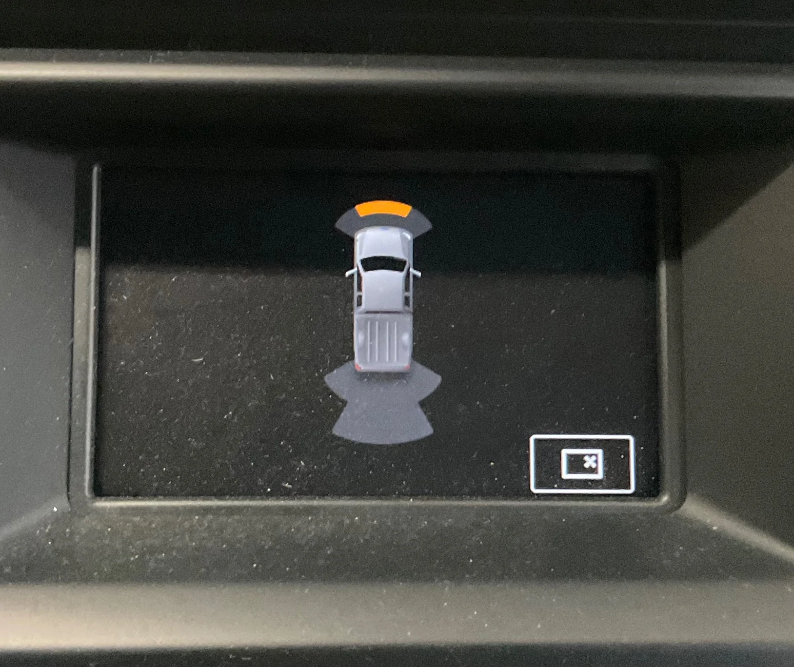

@DukeCanBuildit and @airline tech ... let me try again... 2019 Lariat FX4 with the Bose audio system (if that matters). No front camera, only on tailgate. (was a front camera an option??)
Photos in order taken:
Plan revise - nothing close:
In reverse and pressed the + in the top left corner of the previous photo:
Backed up and got closed to my wife's SUV:

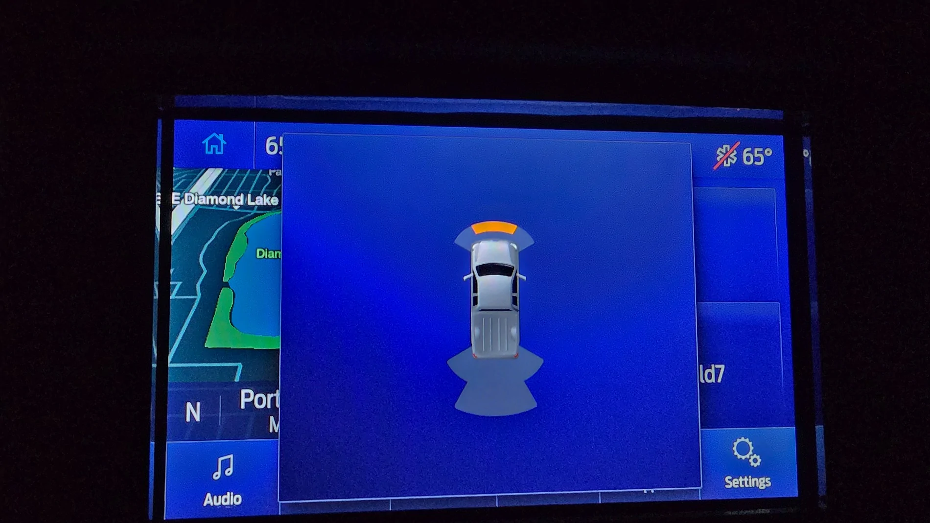

Drove forward to get close to the car in front: Some beeping till I stopped and a few seconds the notice went away.
Drove forward to get even closer to the car in front: More intense beeping till I stopped and a few seconds the notice went away. No real change in display message however (like the orange turning to red and such).
So the 4" display does have significantly different messages.

Thanks Richard.
It seems the forward parking aid screen image of the larger infotainment system doesn’t have anything but the truck image and distance indicators.
i.e., no mystery icon like in the bottom RH corner of my screen
Just to confirm:
Do all 4 Front Sensors register (objects)
I see the front (inners) but do the outers register?
Just to confirm - Rear Parking Sensor Operation
and using this as a ref:
Do all 4 of the rear sensors - pick up objects when you are backing into the garage
When you continue to back up here - 3 of the 4 rear sensors should be changing colors, the passenger outer (?) Maybe
Sorry: It did not post the way I wanted it:
Edit:
Do all 4 sensors pick up objects - I see the Front (Inners) but not the outers

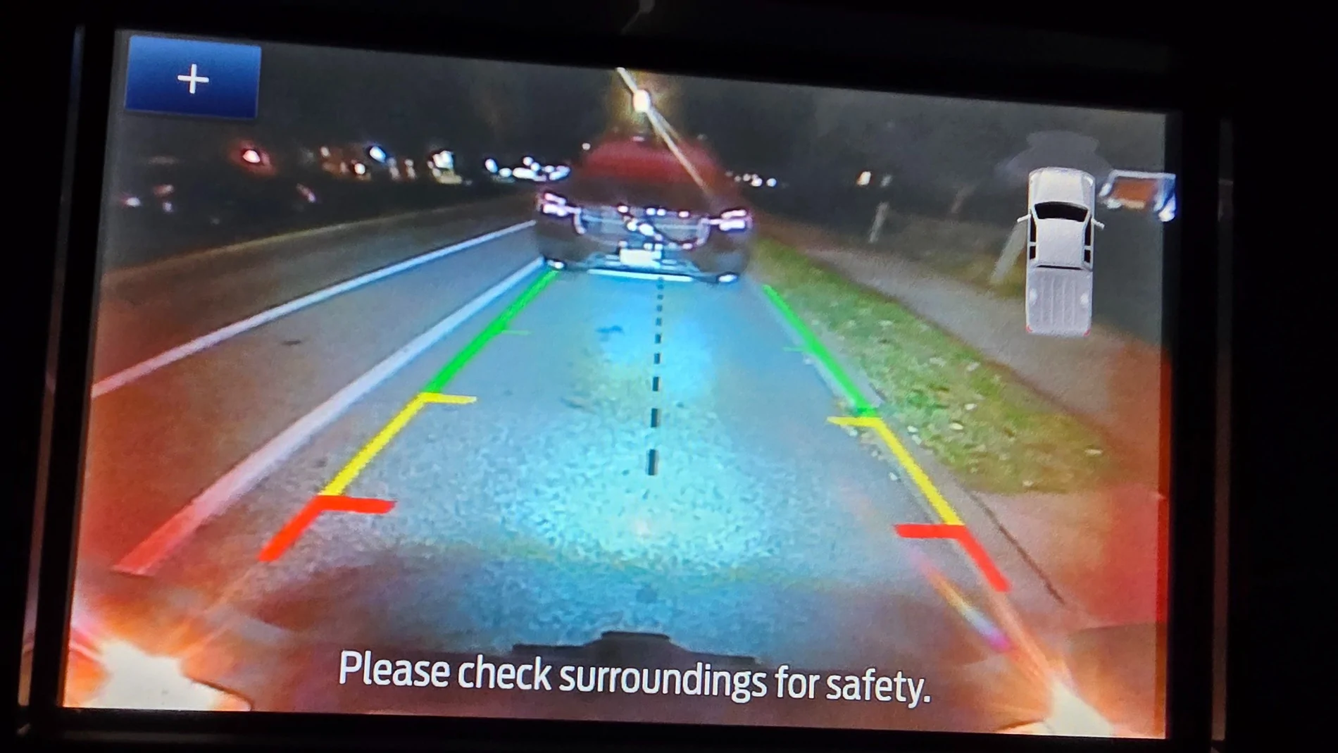

@airline tech When I was backing up, the 4 sensors on the rear bumper, lit up at various moments... the photo shows what the final display was when I stopped and took the photo. Note that the center line of the camera was not on the center line of the SUV so the "red" sensor was a little closer to the SUV than the other... or so I theorize.
I was using your PIC as a ref for Duke, for him to ref what the rear sensors should be doing.
I was thinking that possibly (the icon) may be trying to display a (!) failure of one of the sensors.
Since he states (ALL) are working - that's not it
