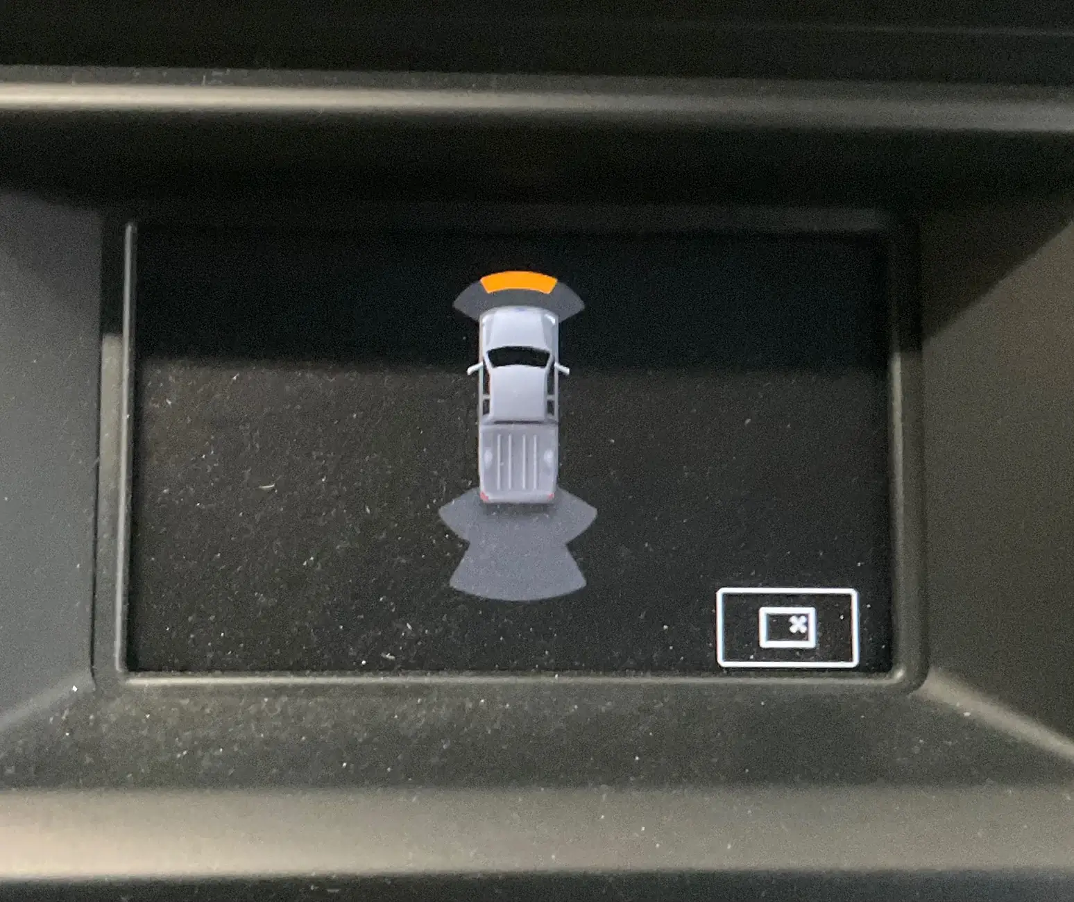

The normal course of events for the screen is as follows…
  1. Truck approaches an object
  2. Forward Parking Aid screen is displayed
  3. Brakes are applied - truck comes to a stop
  4. The screen automatically closes after one or two seconds or if the gear selector is moved to “Park”
Figarou and airline tech both suggested it closed a screen. They were referencing the backup camera screen and the forward screen closes on its own so I wasn’t thinking of that functionality.

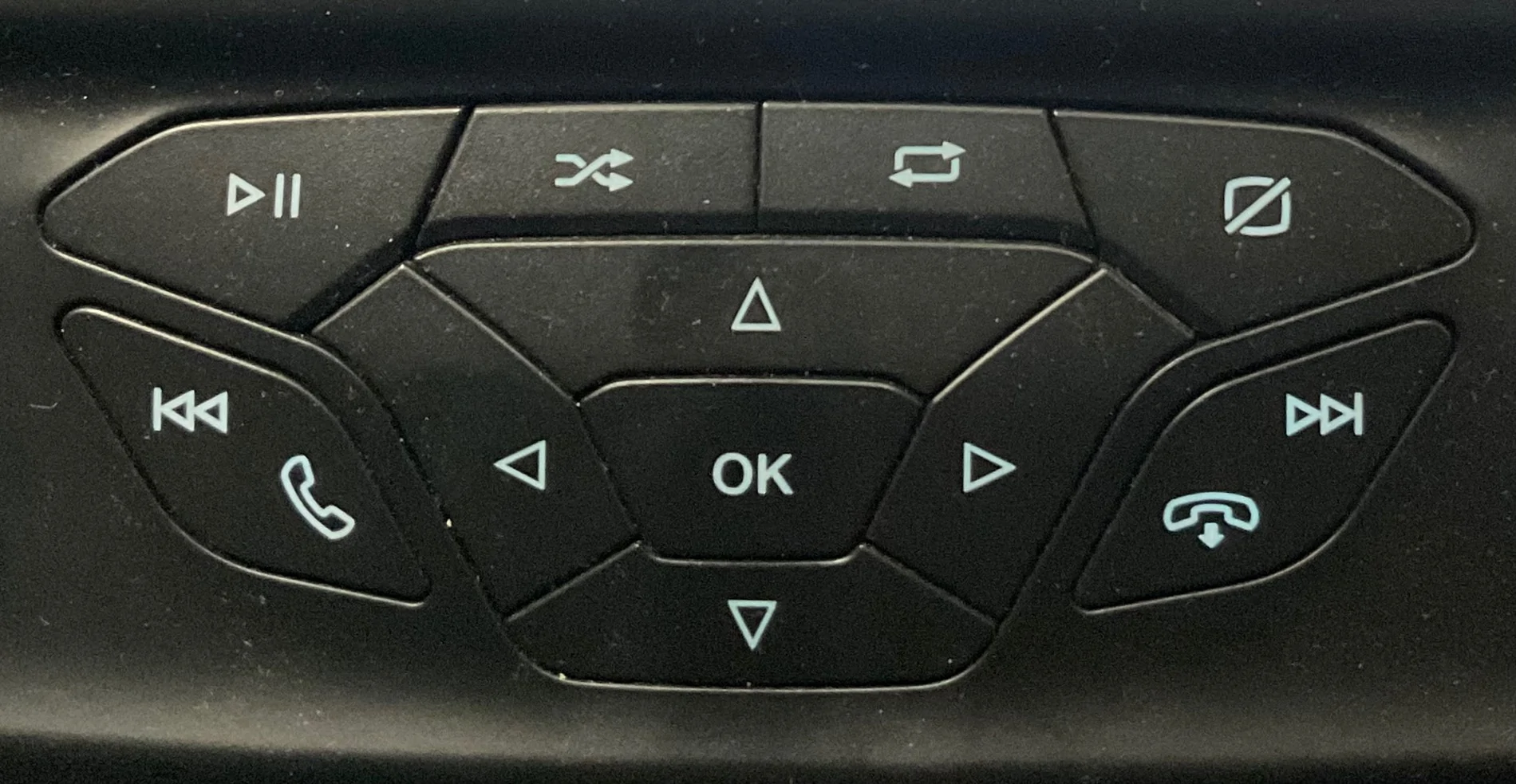

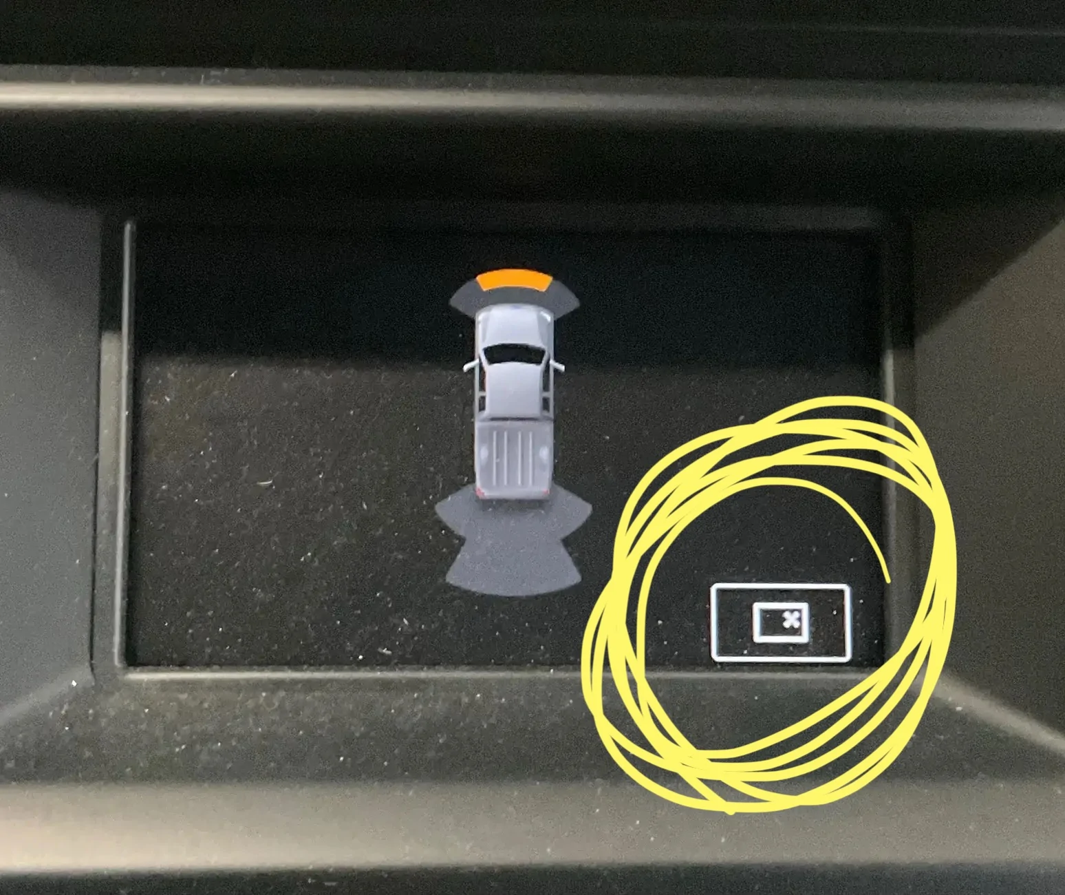

HOWEVER, what if there are times when the Forward Parking Aid screen does not automatically close? It would be nice to turn it off and that icon does look like it stands for “Close Screen”.
So, there I was…out in my garage again this morning…..back and forth, back and forth…..in and out of my driveway, until the screen did not automatically turn off. I didn’t have full missile lock but I had a solid tone for a second - the tone stopped but the screen was not closing. Pressing the OK button closed the screen.
Nothing fun, super helpful or informative like on the backup screen - just a way to close the screen for those times when it doesn’t close on its own and you’re not putting it in Park. I was hoping for so much more.
Now, to figure out what the conditions are that prevent the screen from closing automatically.

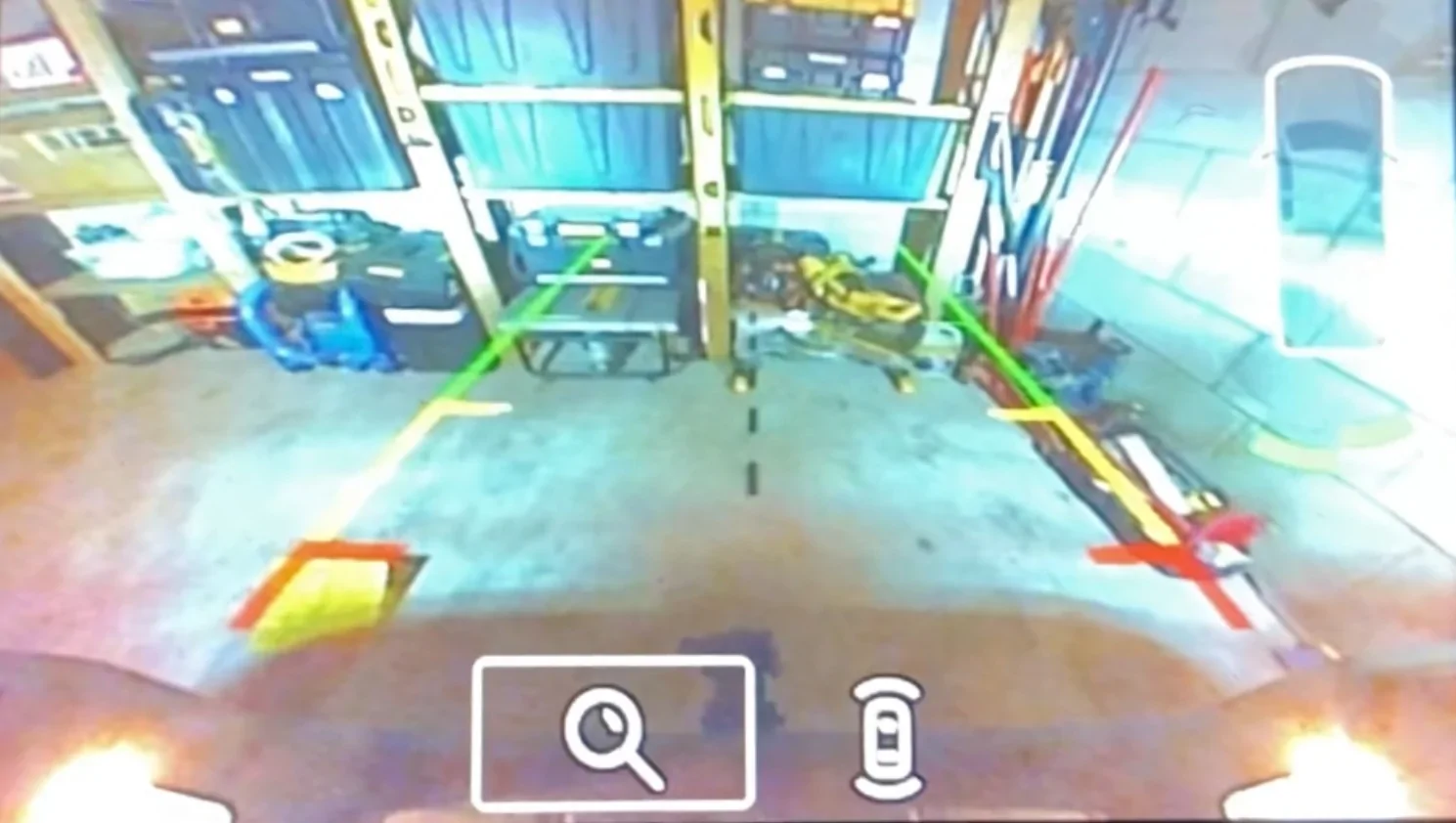

@DukeCanBuildit and @airline tech ... let me try again... 2019 Lariat FX4 with the Bose audio system (if that matters). No front camera, only on tailgate. (was a front camera an option??)
Photos in order taken:
Plan revise - nothing close:
In reverse and pressed the + in the top left corner of the previous photo:
Backed up and got closed to my wife's SUV:
Drove forward to get close to the car in front: Some beeping till I stopped and a few seconds the notice went away.
Drove forward to get even closer to the car in front: More intense beeping till I stopped and a few seconds the notice went away. No real change in display message however (like the orange turning to red and such).
So the 4" display does have significantly different messages.
