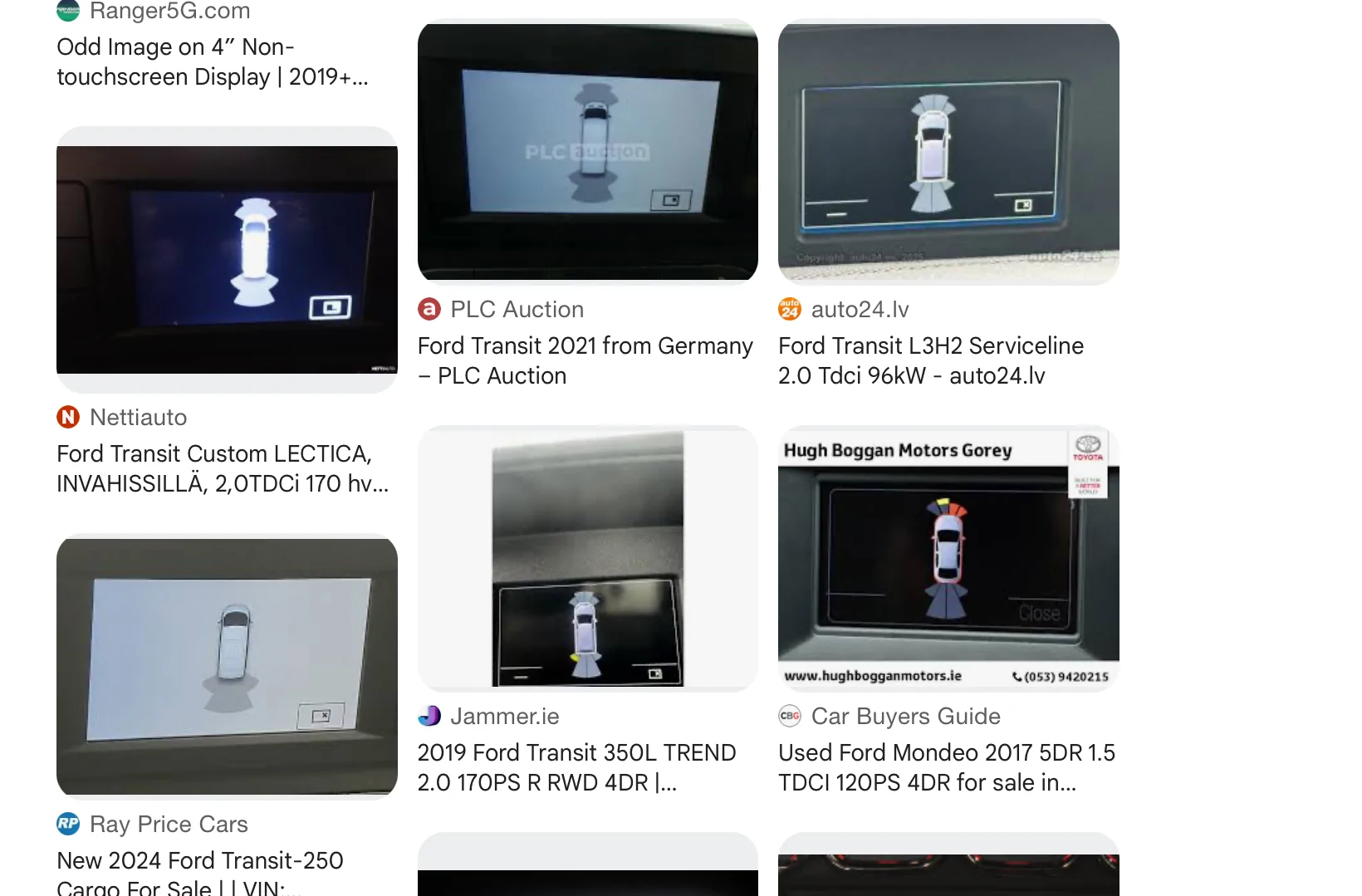

I did a reverse image search and the result was interesting…
Ford Transit and Explorer show the same thing.
I guess it's something that you're not alone, but that doesn't really get you much closer to an answer, either.

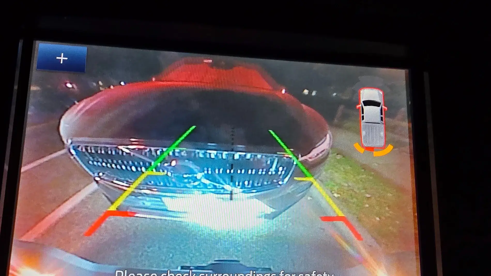

Just to confirm - This screen is the (Reverse Back-Up) Camera screen and when the parking sensors trigger - the back-up cam image disappears, and you see this screen.
If you are in drive - and the park sensor triggers - do you see the same (X)?
For the Lariat 8in screen, both the rear camera and truck image (upper RH Corner) with the park sensors are combined in the same screen.
When in drive - you get the windowed screen like you have posted (park sensors-trigger)
If this is the rear cam view and park sensor trigger, I would say it is supposed to be a way to (x) close the screen and back to the rear camera view.
Someone else with the same 4in screen may be able to confirm.
Ding Ding Ding! You are absolutely correct!

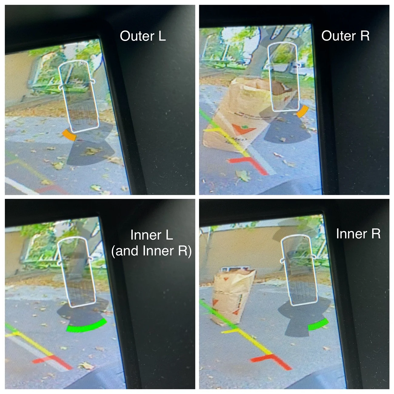

Well, a small truck graphic with activated sensors shows up in the upper RH corner of the rear camera view screen (see above) but it doesn’t include that icon - it includes two others.
I think AI might be confused. That icon can’t close the backup camera view when it’s not in backup camera mode. This happens when I’m in a forward gear.
You're probably right.

@airline tech and @Figarou both mentioned something that was really narrowing it down for me. This led me to do more troubleshooting this morning - I wanted to do it last night after Figarou’s post but Mrs. DukeCanBuildit already thinks I’m nuts and the neighbours must think the same. What, with all the repetitive backing out of and driving into the garage and all the leaf bag testing in the driveway, etc.

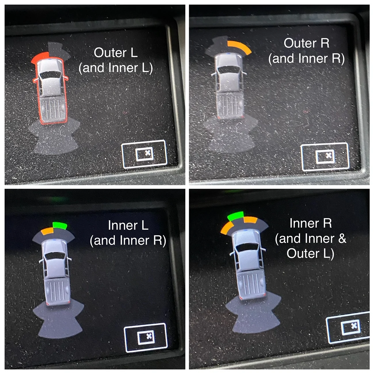

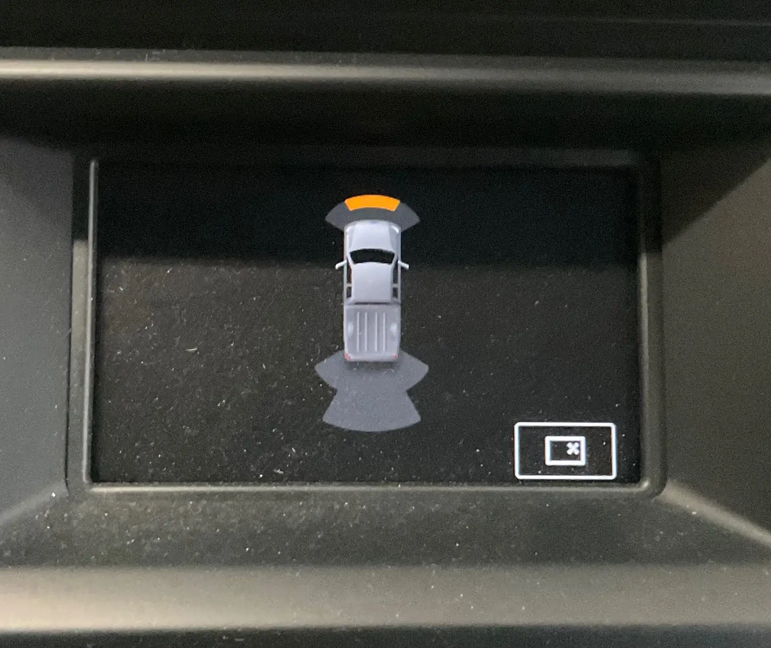

The normal course of events for the screen is as follows…
  1. Truck approaches an object
  2. Forward Parking Aid screen is displayed
  3. Brakes are applied - truck comes to a stop
  4. The screen automatically closes after one or two seconds or if the gear selector is moved to ā€œParkā€
Figarou and airline tech both suggested it closed a screen. They were referencing the backup camera screen and the forward screen closes on its own so I wasn’t thinking of that functionality.
HOWEVER, what if there are times when the Forward Parking Aid screen does not automatically close? It would be nice to turn it off and that icon does look like it stands for ā€œClose Screenā€.
So, there I was…out in my garage again this morning…..back and forth, back and forth…..in and out of my driveway, until the screen did not automatically turn off. I didn’t have full missile lock but I had a solid tone for a second - the tone stopped but the screen was not closing. Pressing the OK button closed the screen.
Nothing fun, super helpful or informative like on the backup screen - just a way to close the screen for those times when it doesn’t close on its own and you’re not putting it in Park. I was hoping for so much more.
Now, to figure out what the conditions are that prevent the screen from closing automatically.
