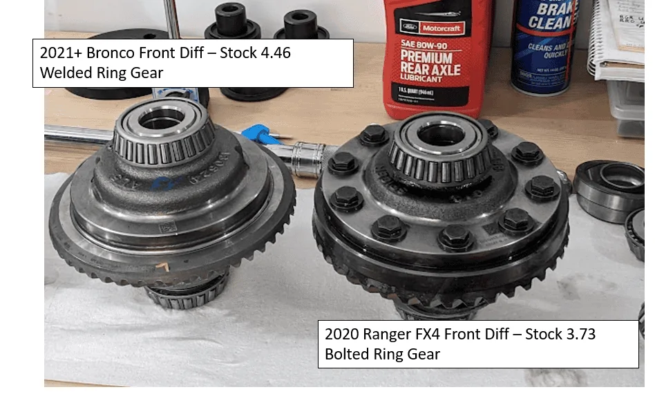

Mind elaborating on your regear setup some more? Wild build.
Sure.
Disclaimer: Don't take anything I say as accurate information; I wouldn't trust me. I'm still expecting to find something I missed or did wrong. Information on this diff is a bit scarce and so I likely made some potentially incorrect assumptions. This is an experiment in cheapness and potato-heading parts not necessarily designed to work together. This was also the first clamshell-style diff I've done.
My motivation for doing this is not terribly rational... Money could solve this problem better. I do find getting to know trucks and dirt bikes and farm equipment in these kinds of ways does come in handy when an improvised field fix is needed. I'm really starting to love this truck and I intend on getting dumber with it for years to come.
Anywho...
Parts:
Dana Spicer 10130628 - Differential Case Assembly and Gear Set (Bronco 4.46 pinion, welded ring gear and carrier)
Spicer 10267426 - 21-22 Ford Bronco Differential Rebuild Kit (comes with bearings, shims, gasket maker and patterning paint)
Axle and pinion seals can be found from an online dealer parts fiche. I don't have those numbers handy.
How I did it, roughly:

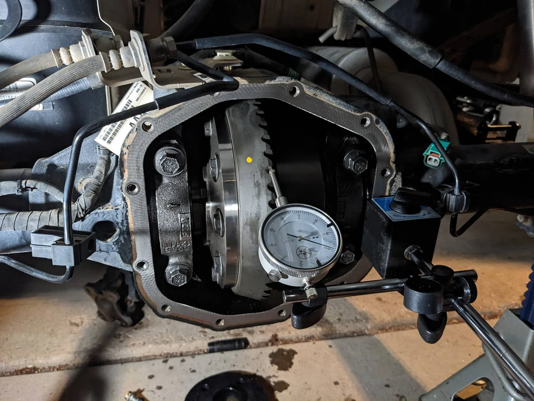

I couldn't find much in the way of torque-to-rotate and backlash specs for the M190 diff, so took a SWAG by referencing the Jeep M186 specs and taking measurements off the stock unit as I disassembled it. I referenced Toyota IFS diff rebuild procedures, as well. That got me in a decent ballpark.
If you want to do this on your own, buy all the diff-related tools listed in the Ranger service manuals that you can along with general diff rebuild tools, especially a menagerie of bearing and bearing cup installers (Ford 205-480 was especially useful when I had to improvise a puller for the inner pinion bearing), or turn your own on a lathe. I had all the tools I needed, but was missing some specialty tools I really wanted like " Ford 205-393 Installer, Drive Pinion Flange" and "Ford 205-072 Universal Flange Holding Wrench". I made this process slightly more annoying by not buying these.
Making setup bearings for the pinion setup would be a good call if using non-Spicer parts, but Spicer etches their gears to indicate how far off nominal they are. A decent first setup can be had if you use those numbers to inform pinion depth and carrier shim stacks... that's about all it took for me to get a good pattern.
I'd wager anyone who has done IFS diffs wouldn't have much trouble with these Ford differentials.
I wish I knew the stock Ranger ring gear was bolted on to the carrier before I got into it... I incorrectly assumed it was welded. Now, I wonder if these would fit this carrier: https://www.yukongear.com/shop/yg-dm190fd-488r.
I still have to do the rear, but that should be more straightforward.

Dana Spicer pinion gears come with their thickness variance from nominal etched on the pinions. This makes calculating the needed pinion depth and associated shim stack so much easier than guess and check setup. If not using Dana parts, I'd recommend using and grinding down old bearings and races to a slip fit for use as setup bearings. This will help get close on backlash and pattern before committing to pressing in the new bearings.
The rear axle is relatively straightforward for a DIY. Regarding the front, if I were to do this again, I might just take the front differential / FDU out of the truck and take it to a shop that does Toyota IFS gears. The front clamshell is a bit of a pain unless you have the right tools for it.

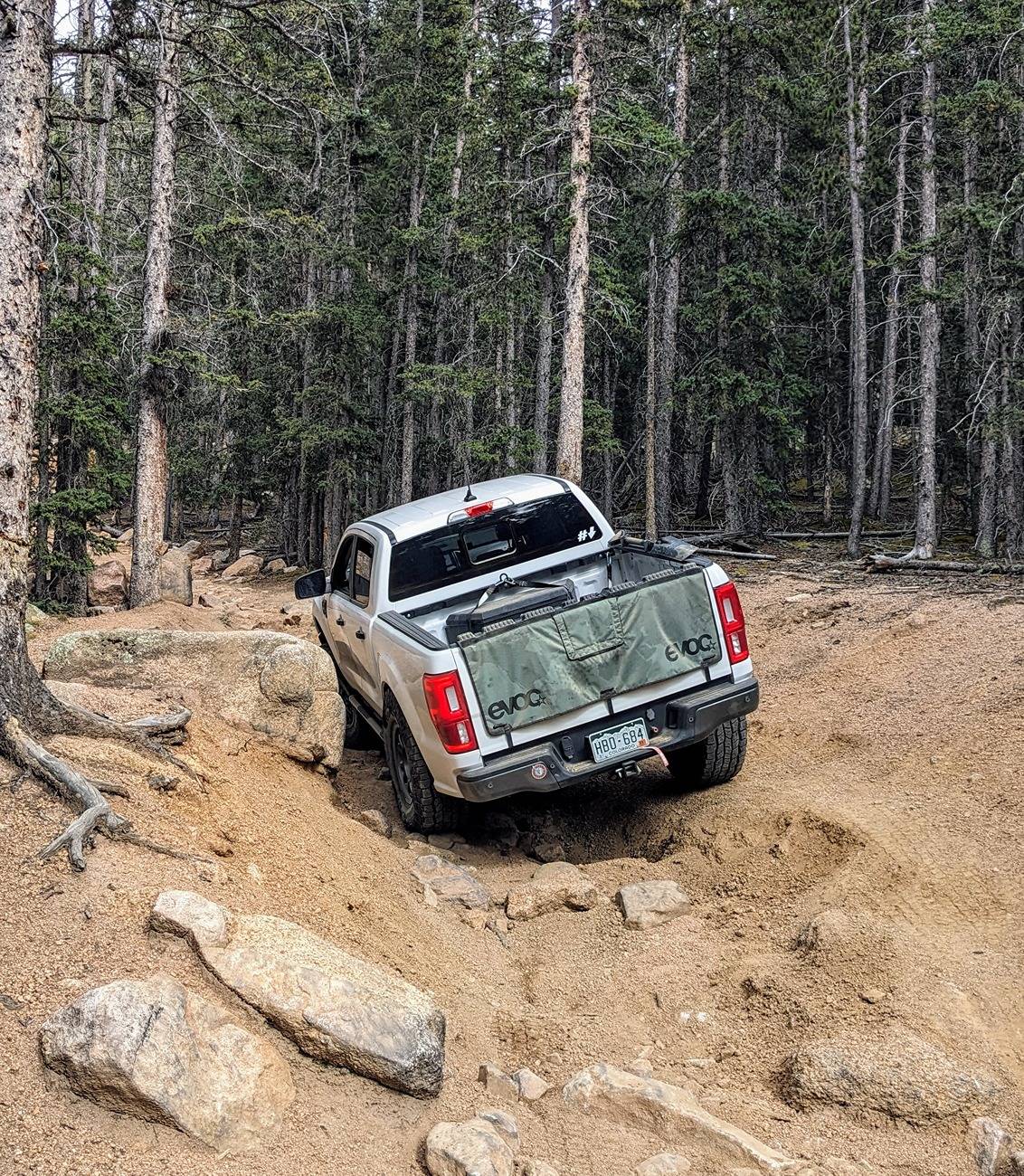

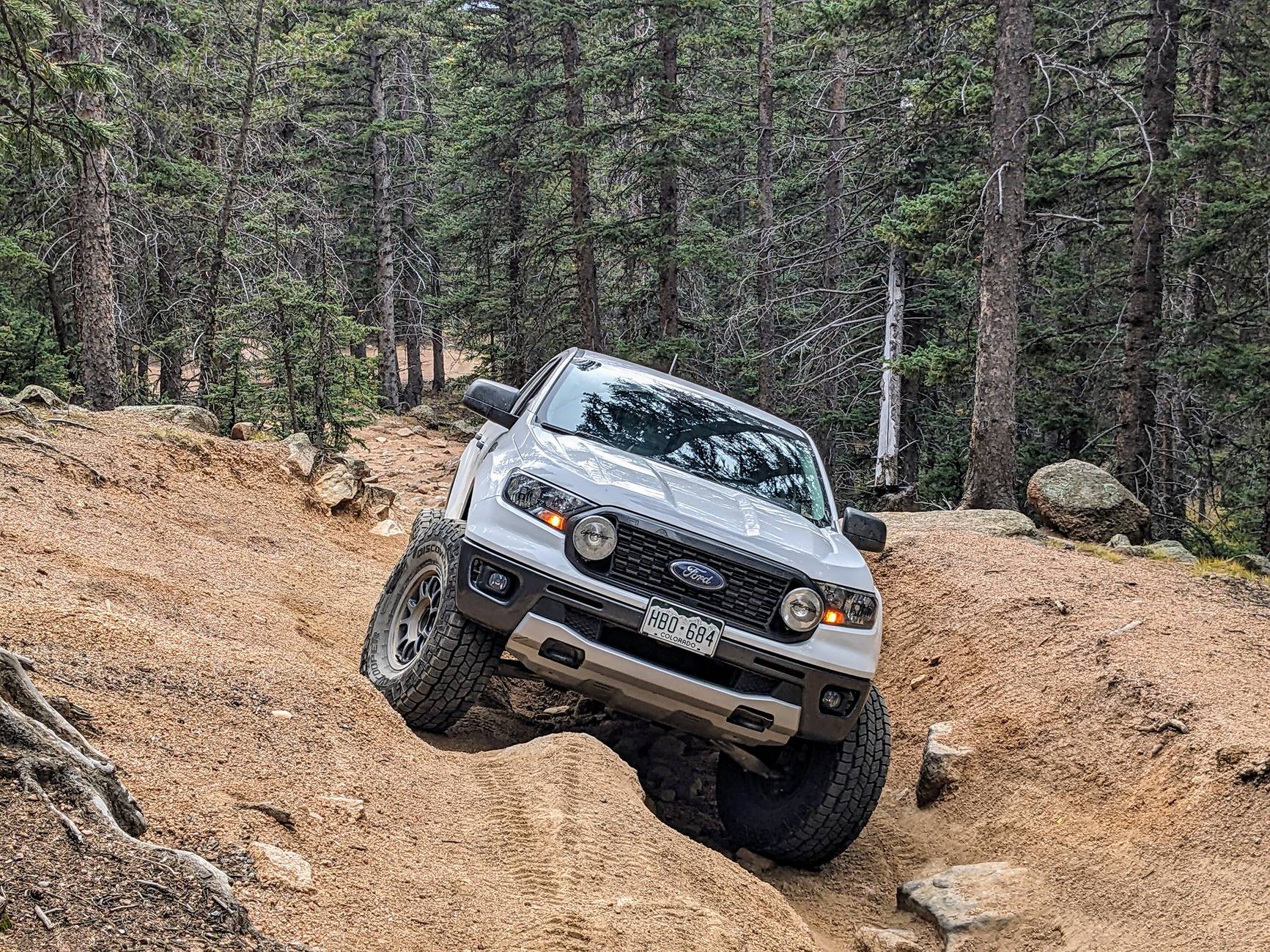

I've had this setup out just a bit more and have had some time to reflect. Keep in mind I favor going fast-ish on dirt and only like milder rock-crawly situations.
Thoughts on 37s:
- Big tires rule, everything in the way of them gets smaller
- They get the stock brakes HOT rallying around twisty dirt roads, especially in left-foot braking situations
- I've never been more aware of my tie rods, steering inputs are made with much mechanical sympathy when crawling through rocks
- 4.46 gears work with these lightweight Coopers for the most part, but I'd probably just jump to 5.13s if I had this to do over
Thoughts on the Truetrac:
- it is not a locker; it is not really an option for hardcore crawling
- e-brake can make it act almost like a locker, to a limited degree; it works better in this way with more suspension articulation than not
- I love the way it makes the truck handle at any speed above a crawl!
- for me, a Dana "Ultimate" FDU with a front locker could probably be a great compromise to allow me to have a broad offroad performance envelope
Other thoughts:
- I need to revalve the suspension again, as the capability goes up with the tires, I find myself wanting more damping on faster trails... It's so fun

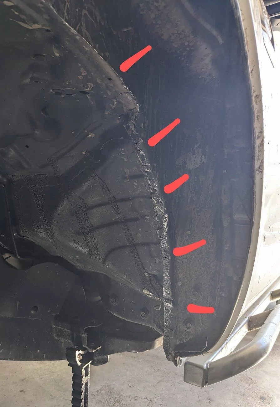

Now that you've had a chance to flex out, do you have clearance issues with the 37s? Rubbing issues, etc.
Oh yeah I have clearance issues!
On the front, I cut and hammered back the inner fender weld seam at the back of the fender well. I also had to limit bump travel about an inch. It cycles about 10" really cleanly right now, even with full steering lock.
On the rear, with the spring under suspension, and Raptor bump stops allowing more travel, I had to relocate the fuel return and vent lines a bit. I cut a bit back there, too. It rubs the middle of the inner fender well at full rear flex. I don't want to limit bump travel in the rear, so that's gonna require some cutting and welding on the bed.
I actually got a beater for commuting so I could mess with this thing more. This truck will never be done...
Front wheel well hacking:
