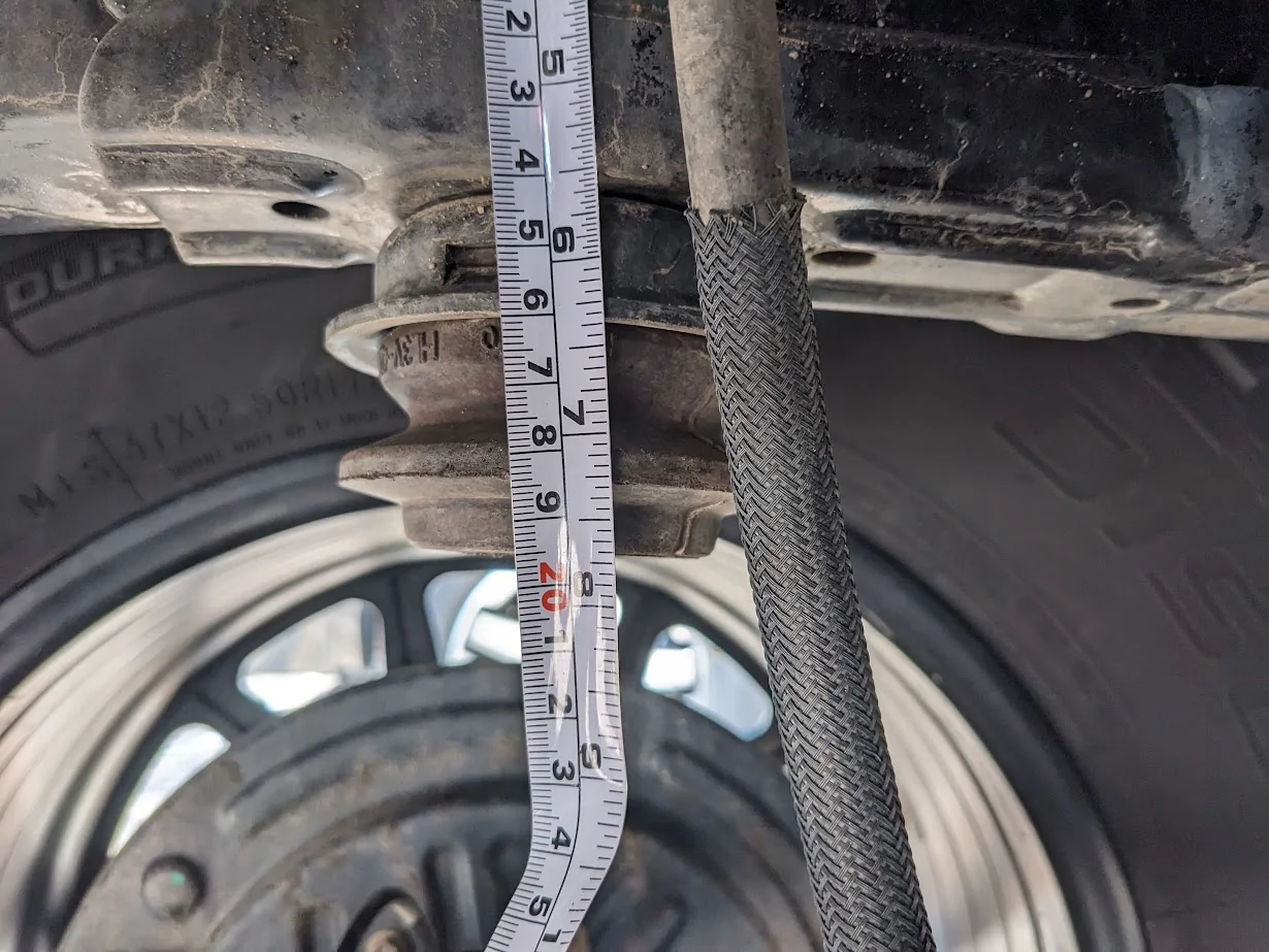

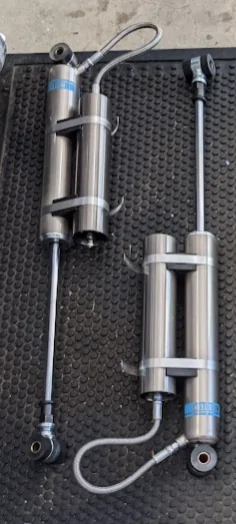

For use with the stock damper mounts, I found dampers with the longest stroke that would fit in a collapsed state with the increased up-travel of the spring-under setup with shorter Raptor F150 bump stops.
The dampers happened to be Bilstein AK7110SB (7100's, 10" stroke, short body... about 14.29" inches collapsed). I replaced the spherical bearings with urethane bushings one these, as well.

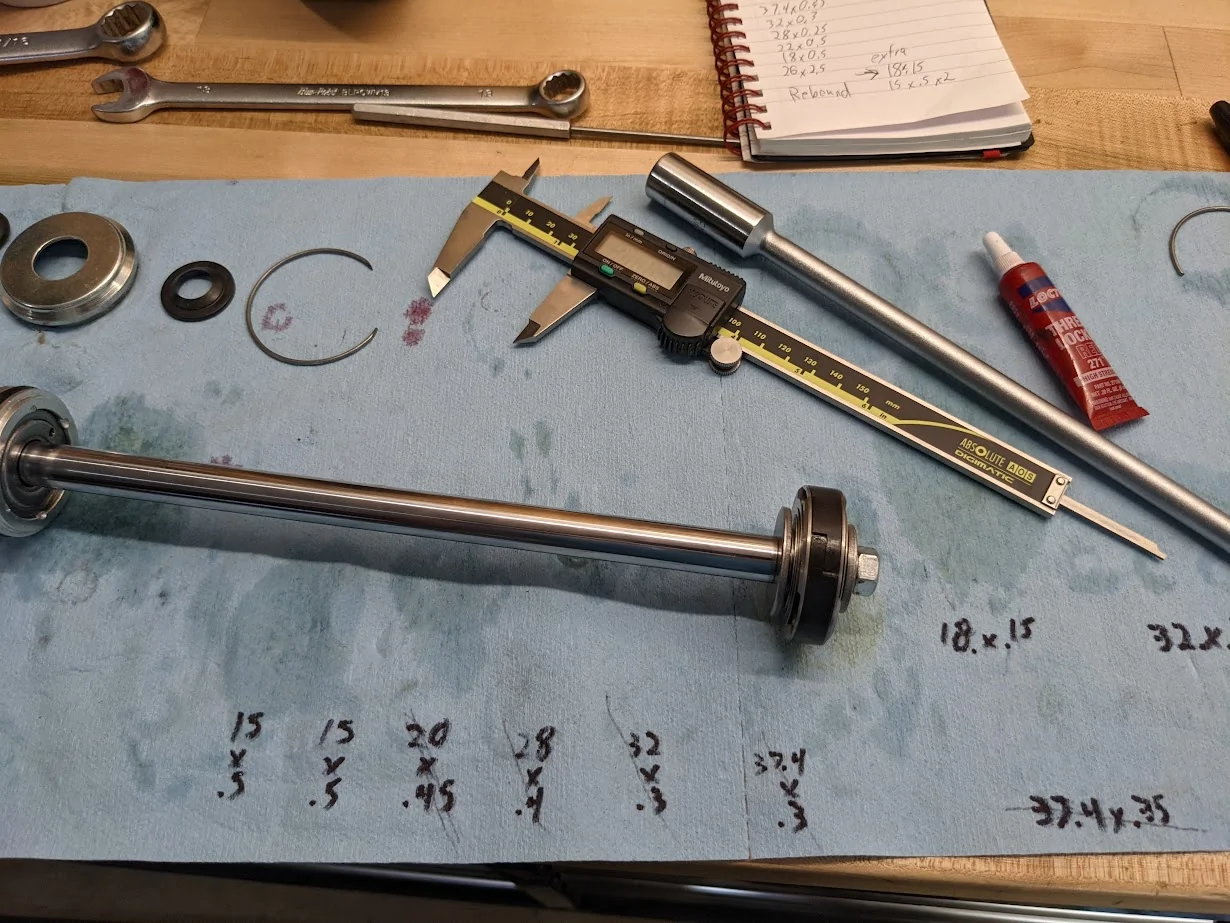

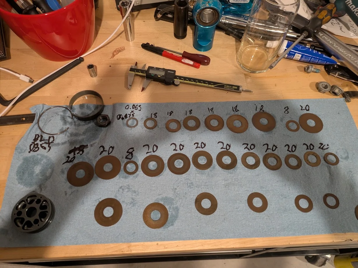

Side note: these dampers were fine for most things, but not stupid things. Doing mach-chicken for miles on washboard roads with heavy valving, I overheated the IFP and the expanded glass-fill plastic seemed to tear up the inside of the reservoir at one point. I repaired them with a steel IFP and didn't have the same problem again. They were just limited on how much damping they could make. This was not the damper's fault; I pushed them outside of their intended use case, hence the move to the bigger dampers.

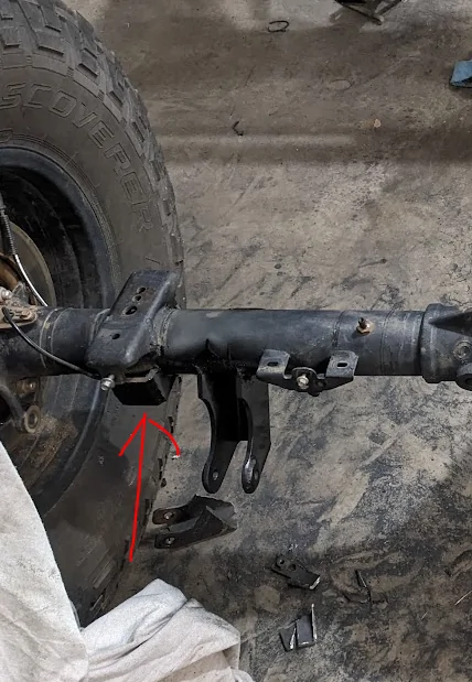

I welded on leaf spring perches to the bottom of the axle tube.

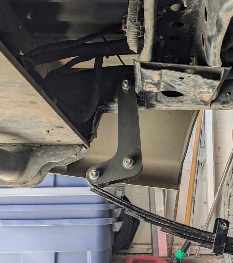

...and had some shackles laser cut to the length I needed and also to clear the rear frame
