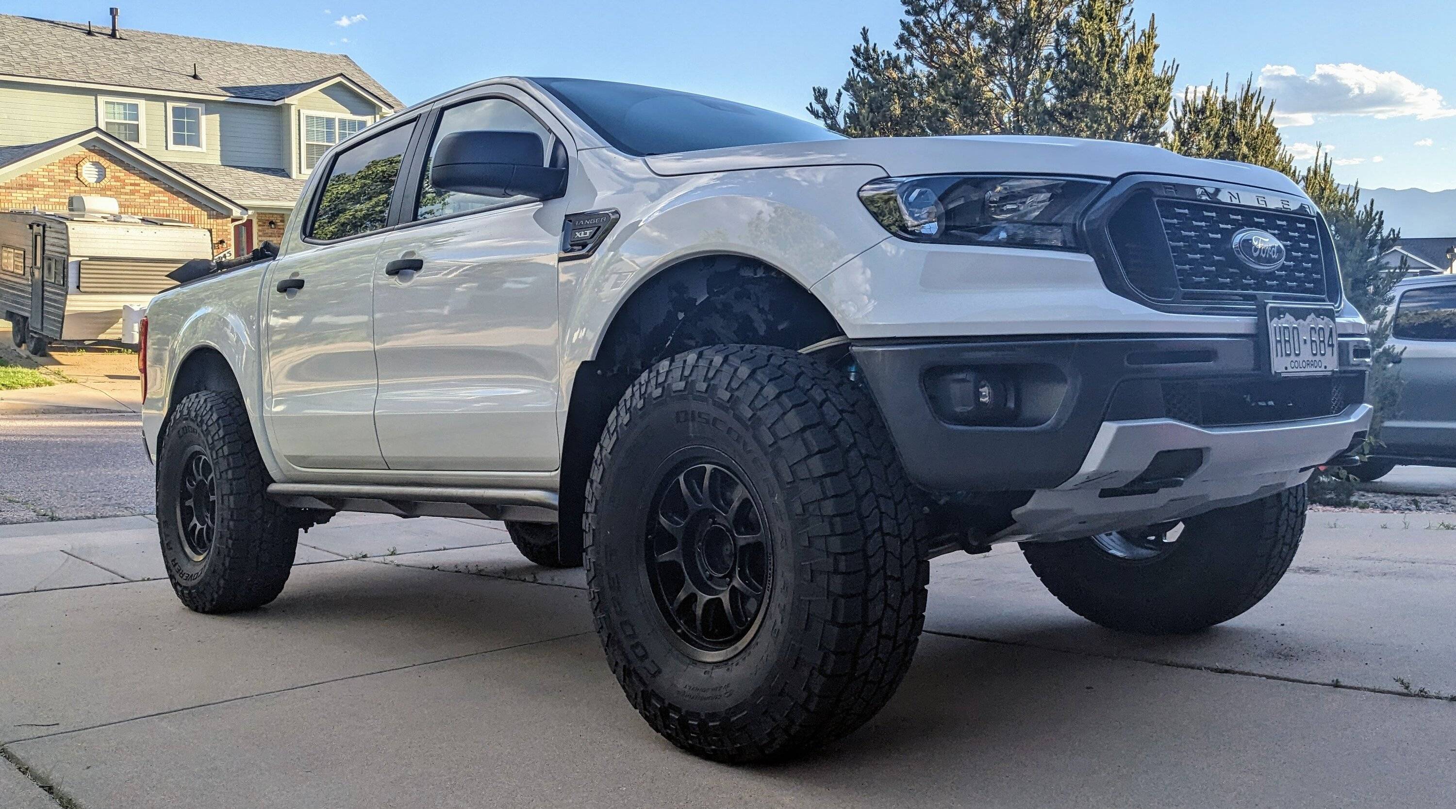

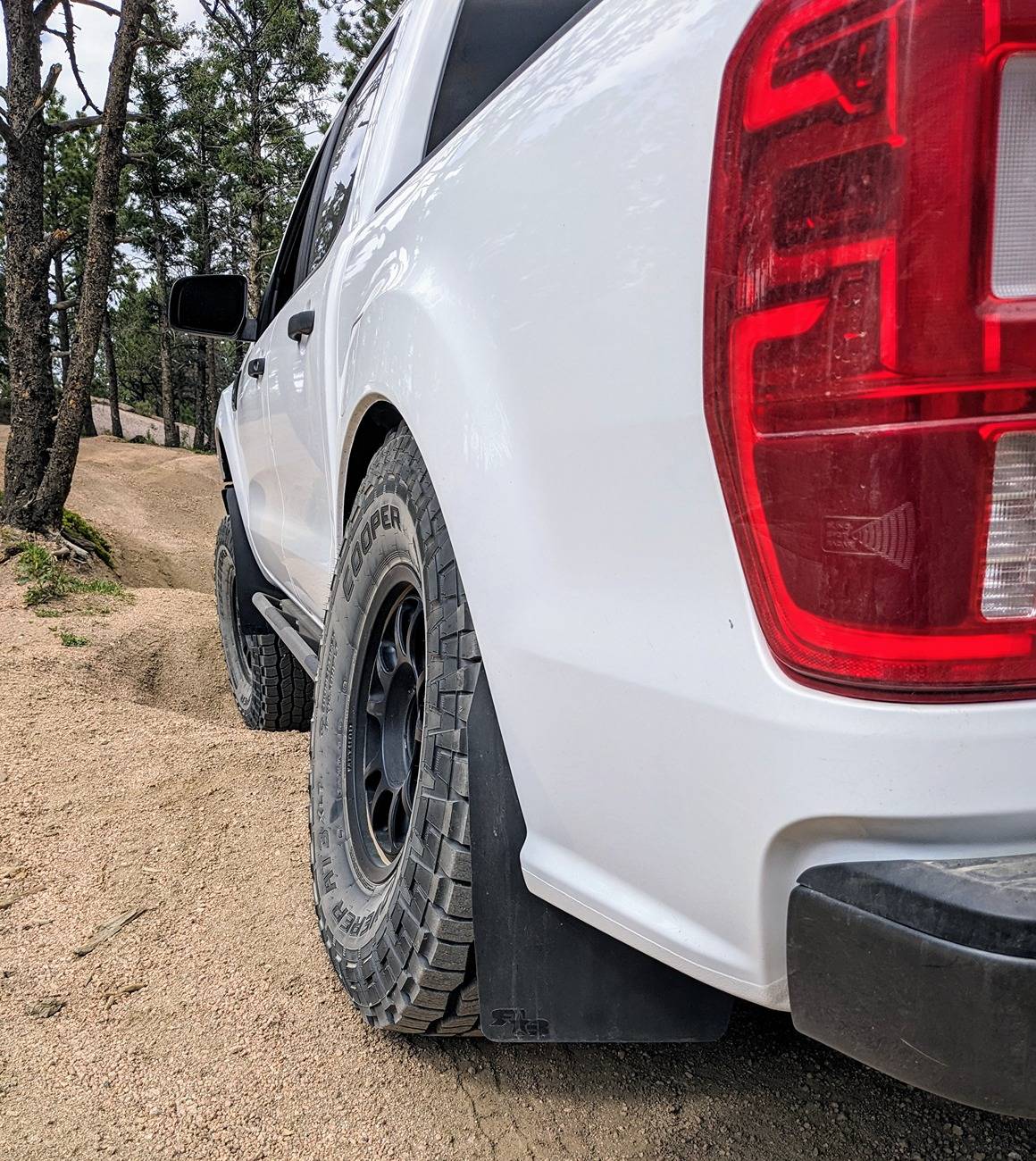

Been waiting on some parts and tools for the regear effort, but I'm enjoying the big meats:
I really expected the performance to be pretty bad with stock gearing, but the 10r80 has a very low 1st gear, so it still crawls in low range well. Driving in "D" mode is kinda miserable now, but "S" mode keeps things on the boil just enough to turn the big tires with aplomb. I can't wait for lower gears, though. I come from gutless Toyotas (that I still love), so the Ranger on 37s is a rocketship in comparison.

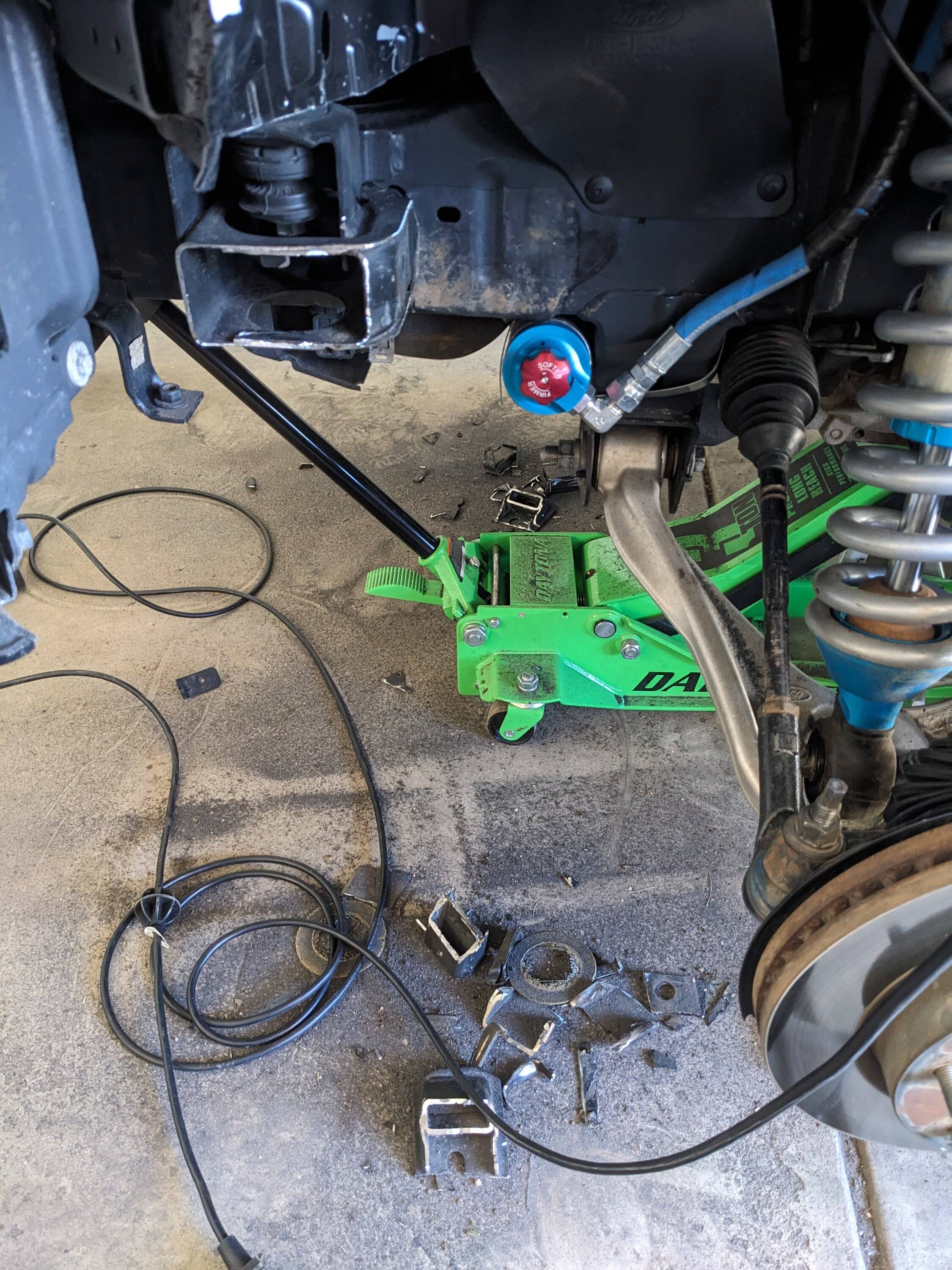

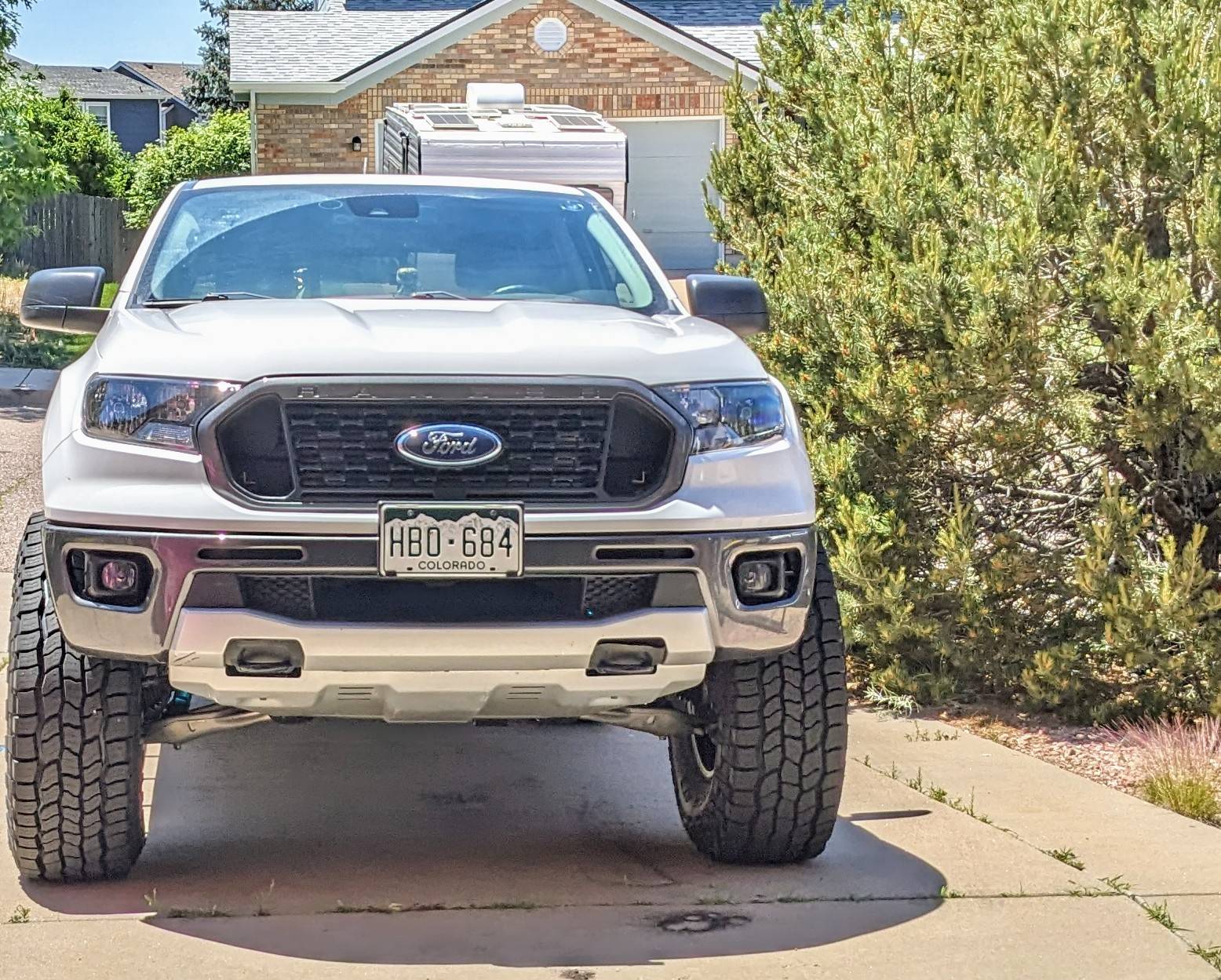

This is irrational; but the heart wants what the heart wants. In case anyone was curious, here's how I happened to do it:
On the front:
-Bronco control arms (wider than Ranger for slightly more wheel travel and tire clearance)
-F150 tie rods (2010s vintage, if I recall correctly)
-Reamed the knuckles to accept the bigger UCA and tie rod ball joint tapers
-Widen upper control arm mount at the frame to accept bronco UCA (LCA just bolts up)
-Axle half shafts are Bronco parts with Ranger inner cups

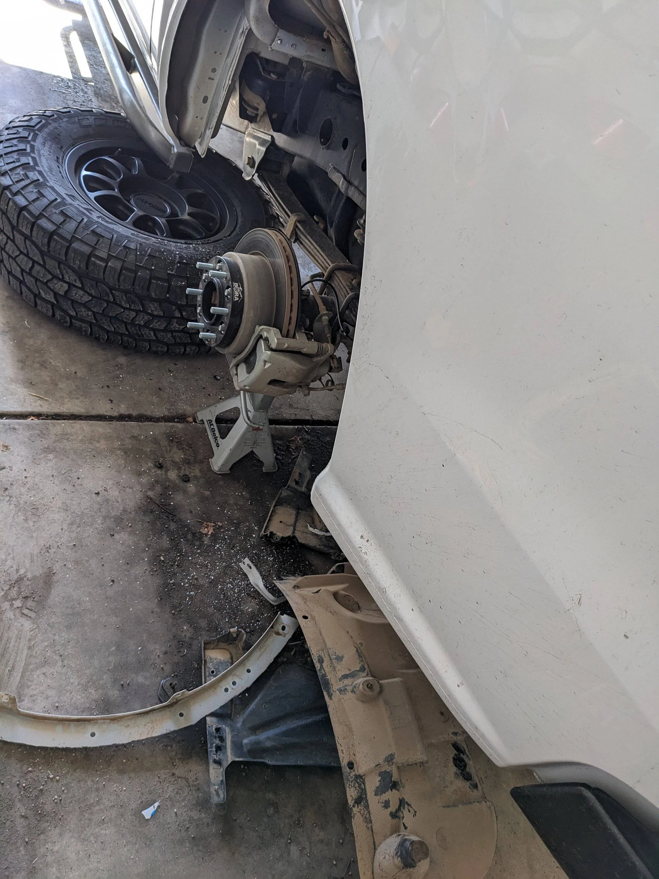

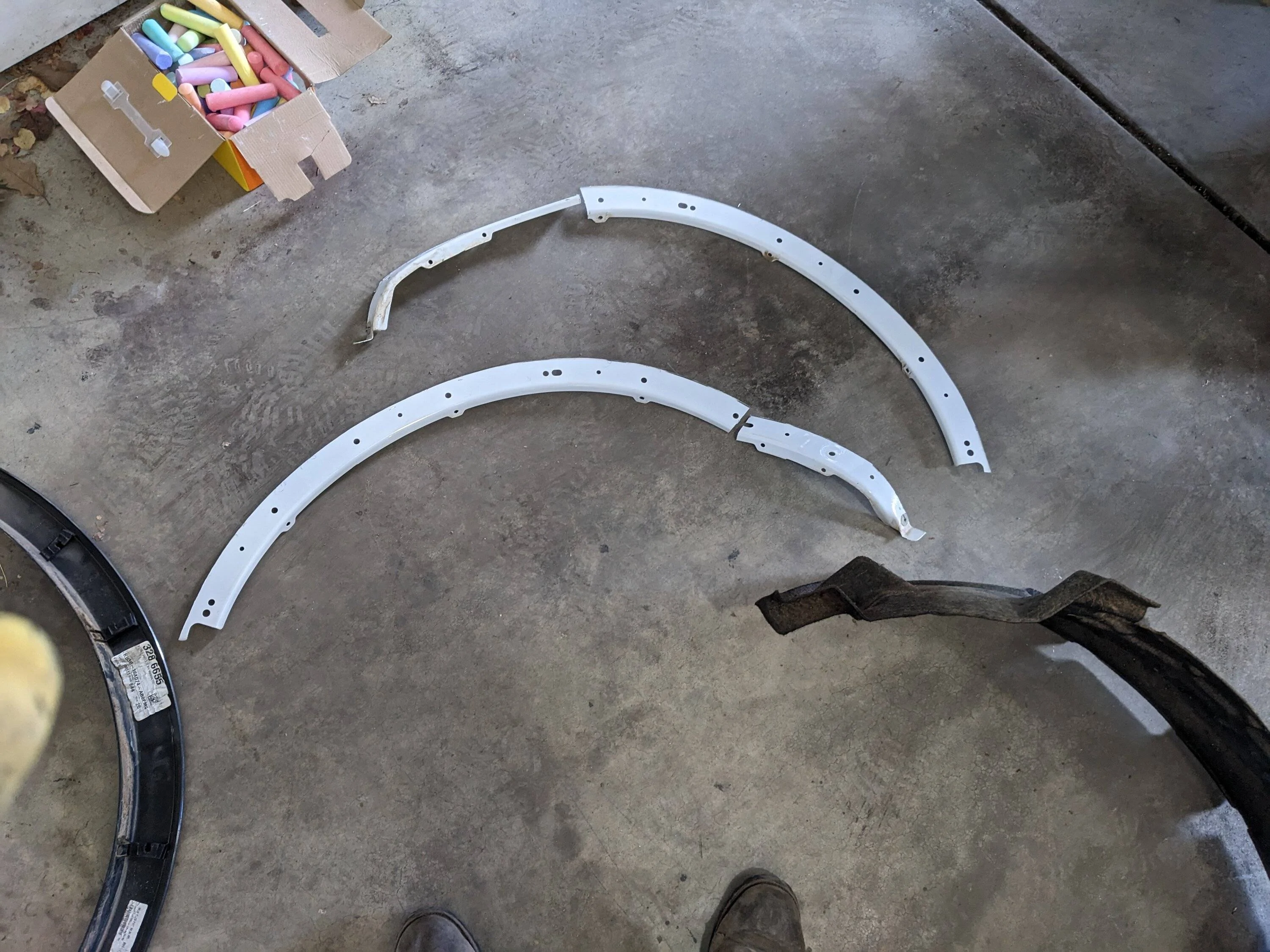

-Cut 2" out of the fenders (my engine bay misses my fender liners)

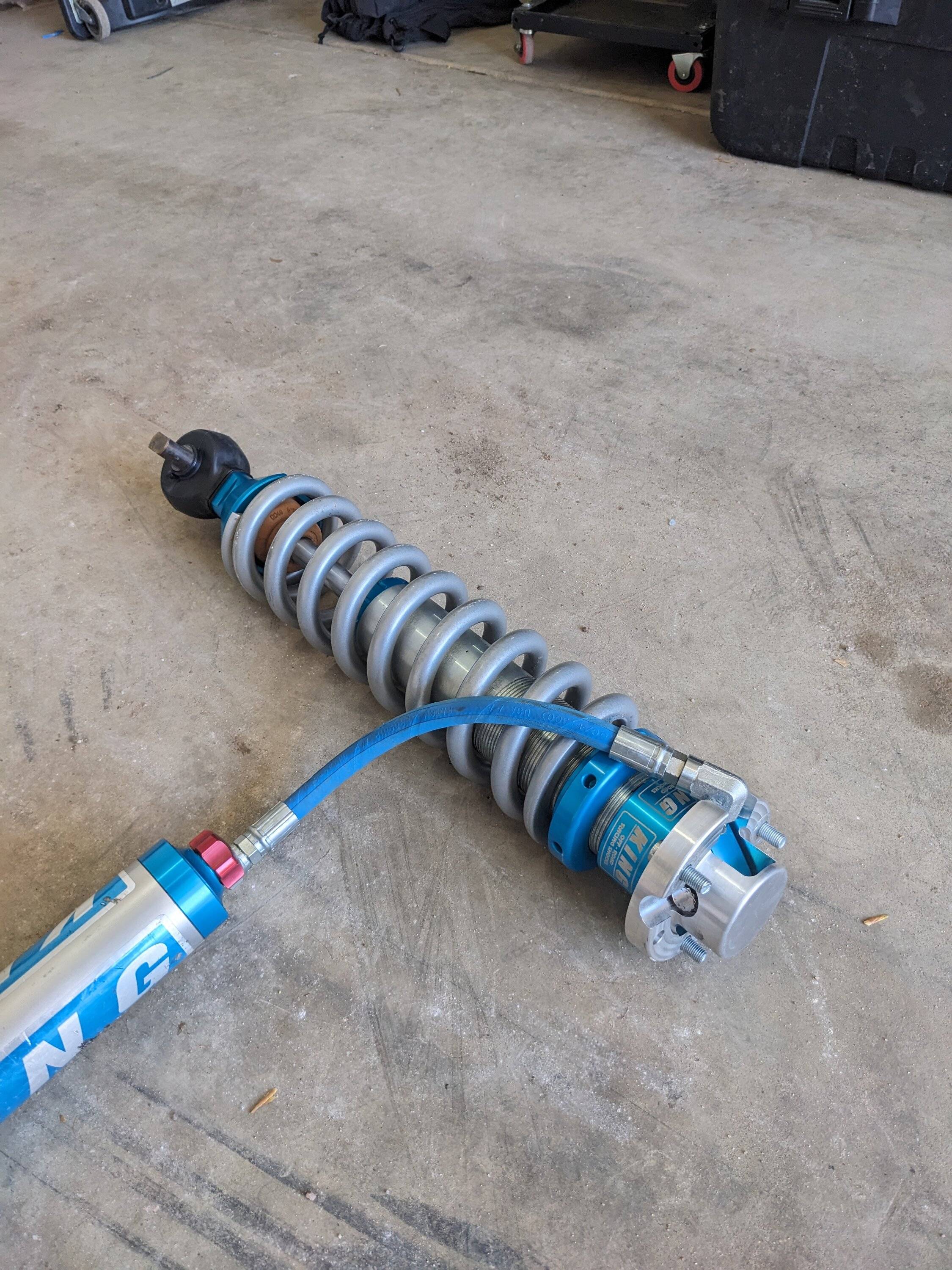

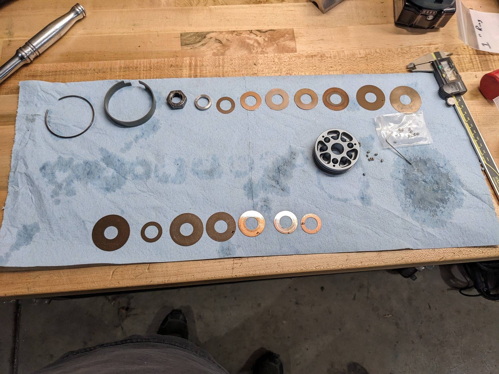

-Modified, revalved, and shortened King pr2508od-cohr-a dampers with parts from Filthy Motorsports and custom machined coilover adapter to suit the "Branger" setup
-Running max caster at the LCA to move the tire forward in the wheel well
-When you think you've cut enough, cut more and cycle the suspension without springs to check clearance at bump and steering lock

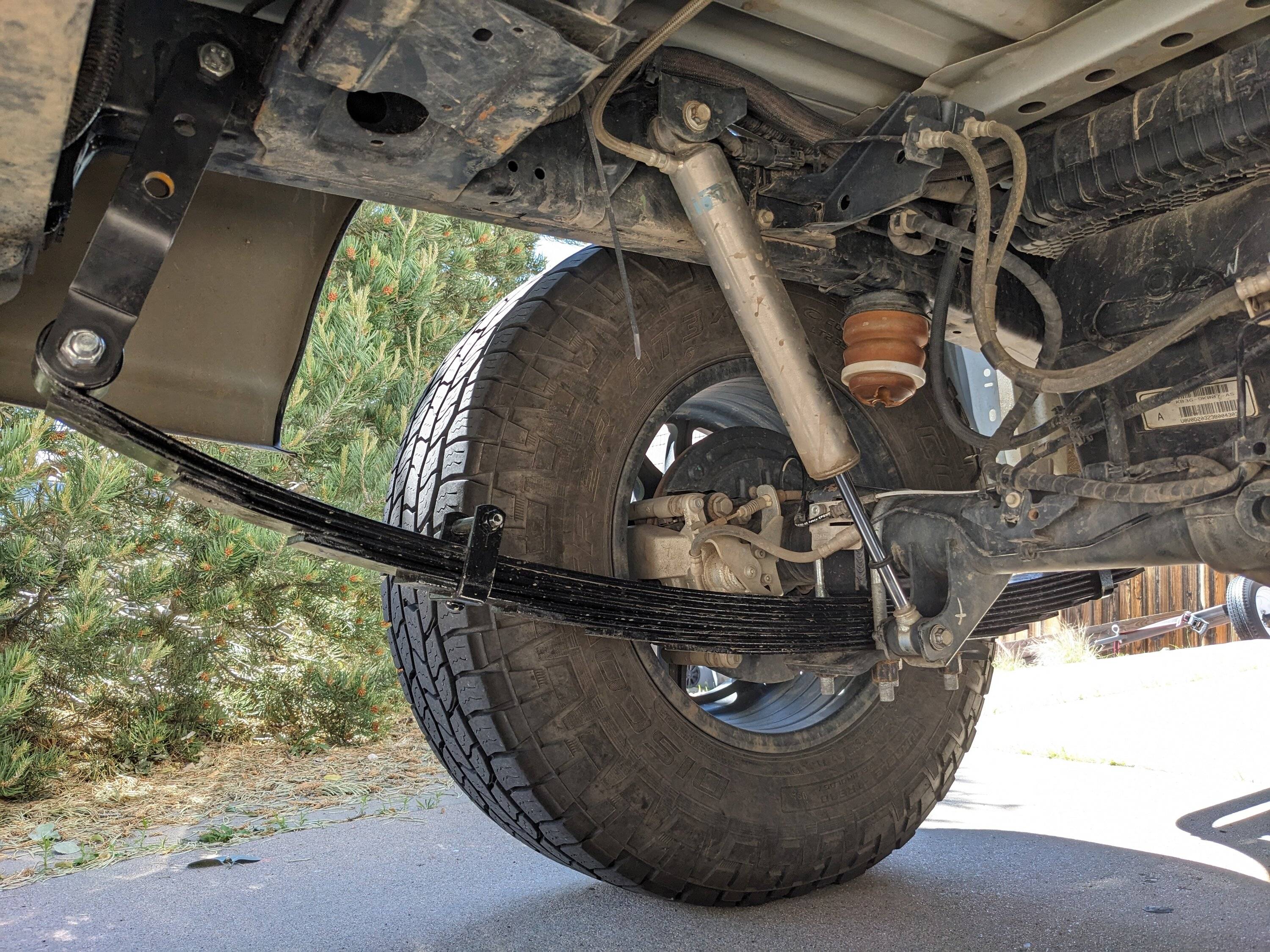

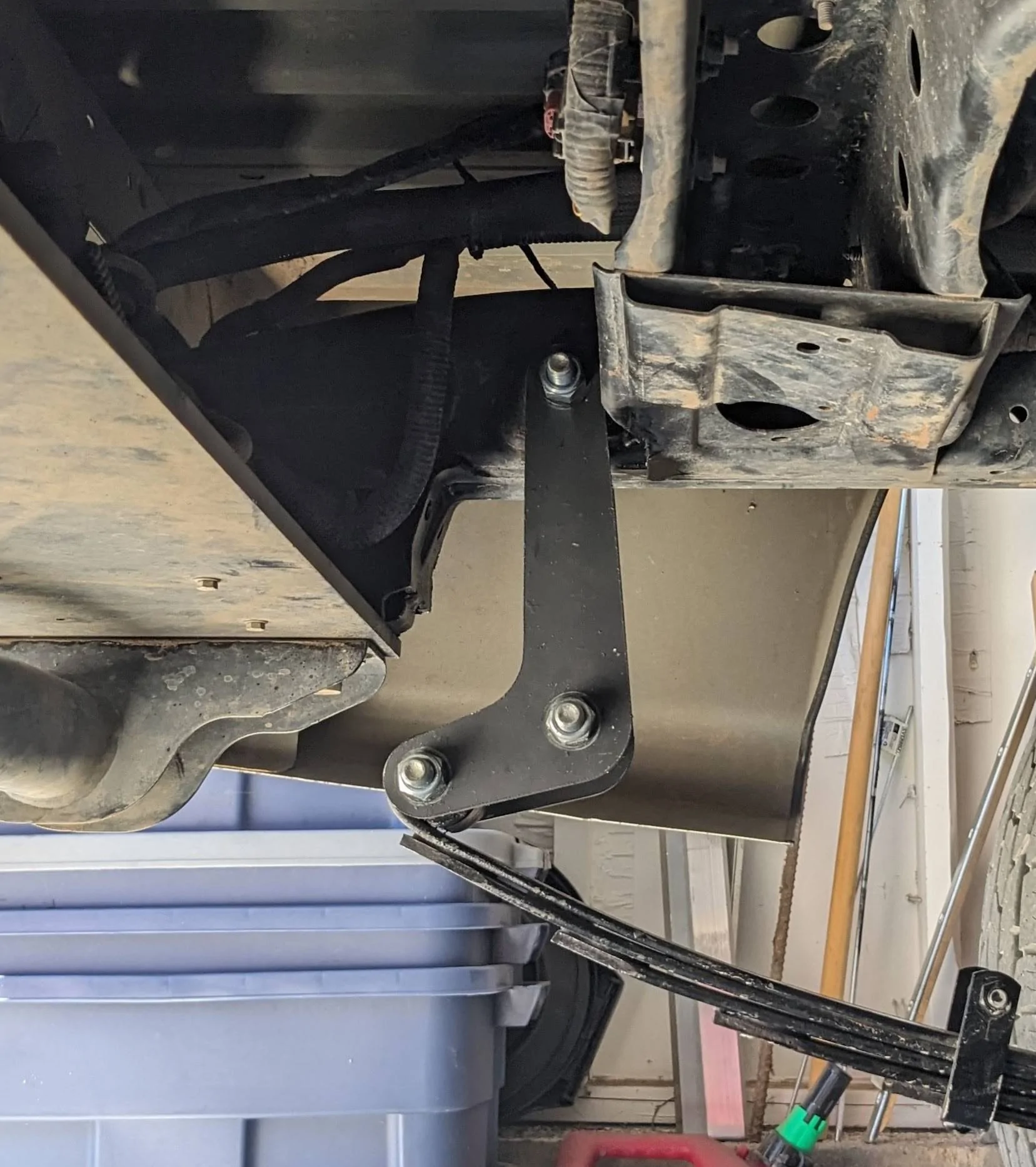

Rear:
-1" spacers (would have gone just a bit wider in hindsight)
-Spring under axle setup with modified Rubicon Express Jeep XJ 6" lift leaf pack
-Laser cut 12" shackles
-Short body Bilstein 7100s 10" stroke, 360/80 valving modified for less bleed
-Cut fenders
-Raptor bump stops (stock shown)

-17x8.5 +25mm offset Method 313's (positive offset helps a bit with scrub radius and clearance at full steer lock)
-Ford Performance tune and 91+ octane always
-Cooper AT3 XLT 37x12.5r17 (note some photos show my old 285/75r17s)

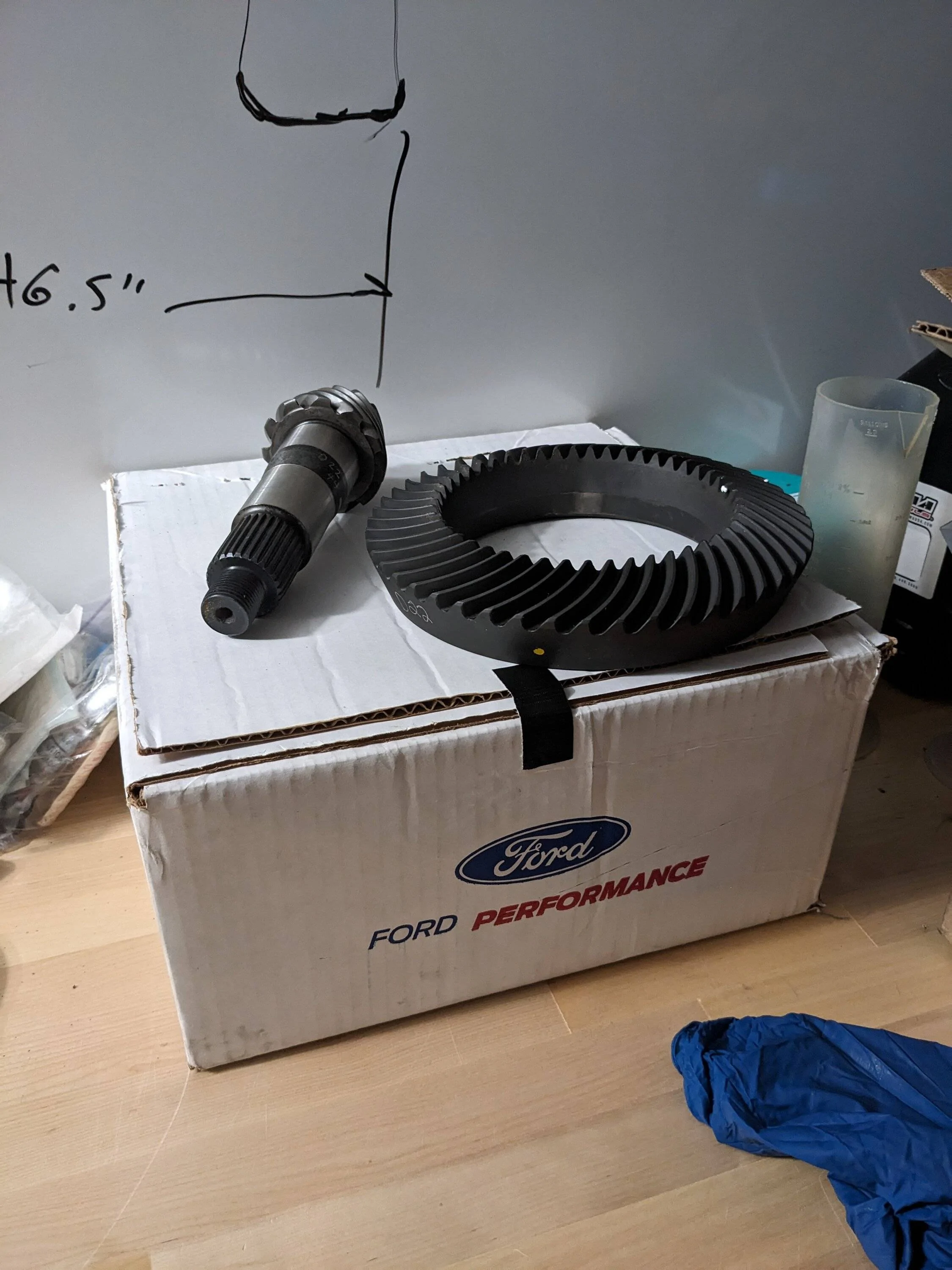

-4.46 gears are ready to go in

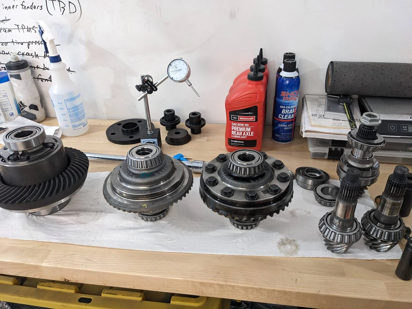

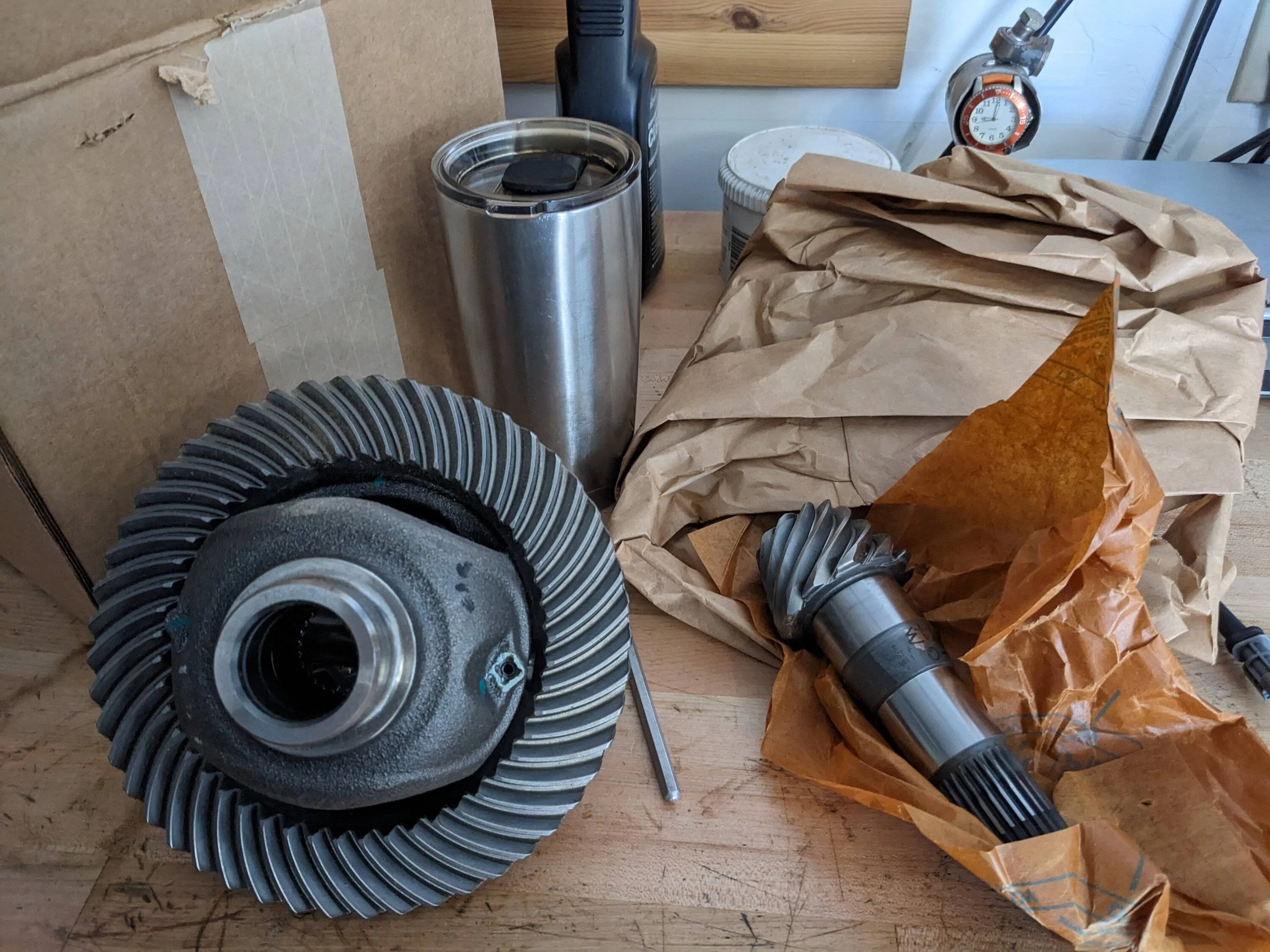

And all this time, I thought the front ring gear was welded on Rangers...
Admittedly, I didn't put much effort forth confirming that assumption. I would have gotten 4.88s if I knew. Oh well, the 4.46 pinion is tiny as it is, anyhow.

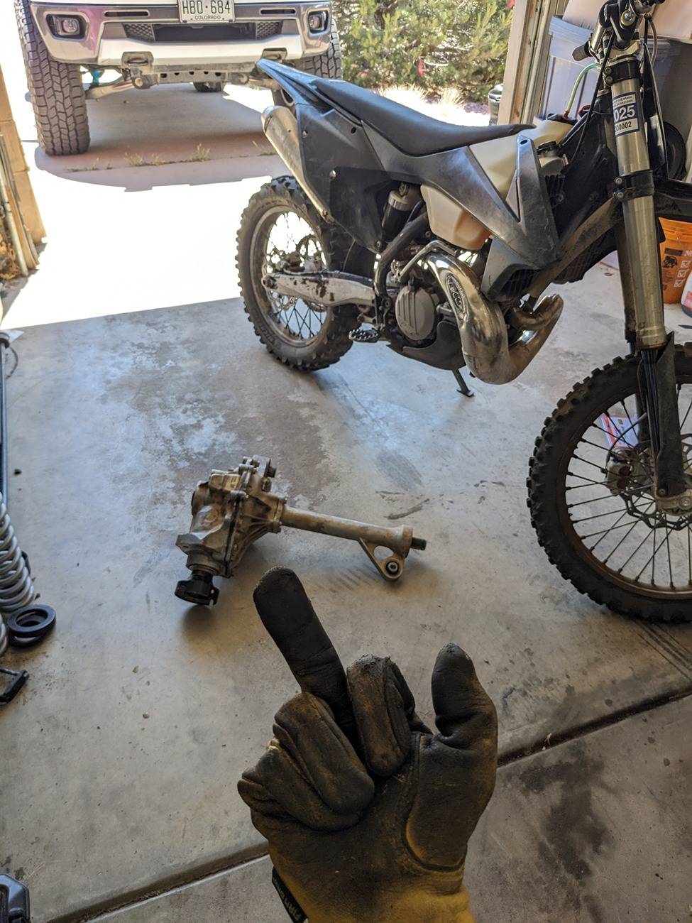

I’ll be interested to hear how it fits in the pumpkin. Can’t wait to see how this comes together. Might have to see if you’re willing to help me install…

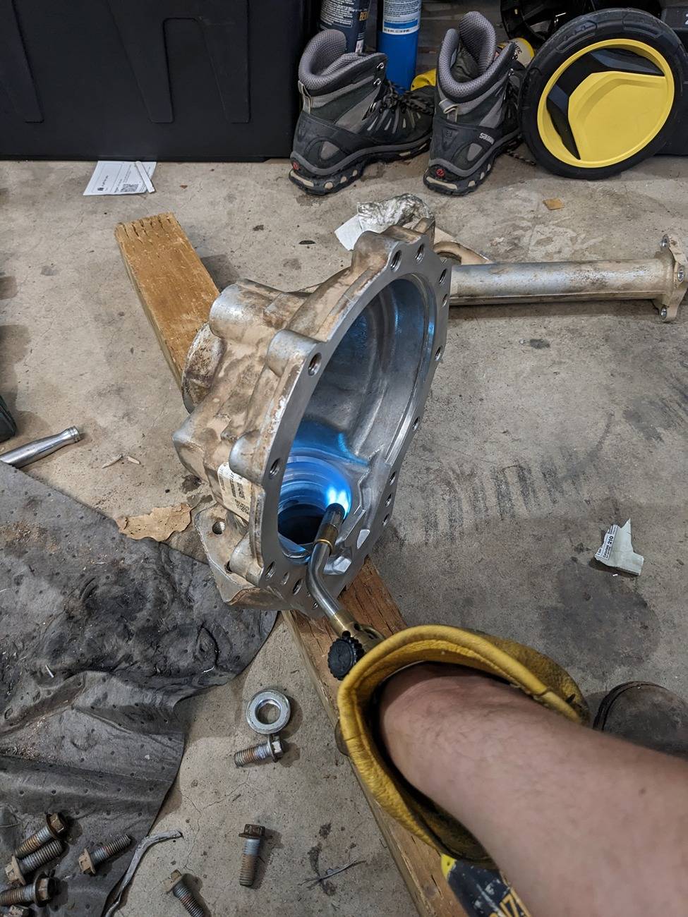

It fits fine. It's all just fine. I'm never doing that again unless I buy a lot more in the way of specialty tools; the pinion setup in a clamshell is super lame to work with.

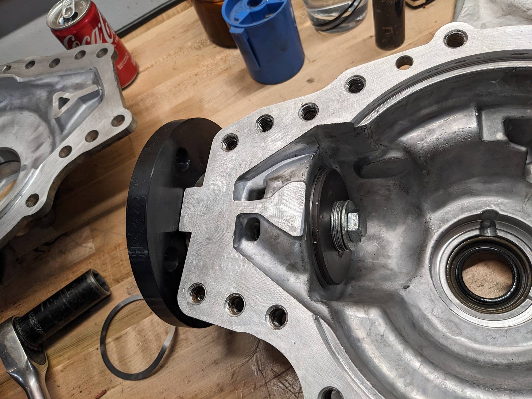

I'm now pretty well convinced a Bronco M190 FDU with a Ranger intermediate shaft and tube swapped over would be the hot ticket. I really wonder if that would work on the M210 now. That's the route I would have explored, in hindsight.
There is a mount on the OE M210 that doesn't line up with the Ranger. There is another guy on here who had that mount tabbed up, but he's been sick (I think) and hasn't hat a chance to test it out.
It's the mount on the right side tube in your last photo. Its flipped 180 on the Bronco. That's why the Dana FDU works, because that tube is rotatable.
[Exactly. What I wonder is if the Ranger intermediate tube and shaft could bolt onto an M210 FDU, since the carrier outputs are both 29 spline, if I recall correctly.
The carrier width is probably not the same... or there's likely some other detail preventing this kind of hybrid FDU.]
...yeah, none of that will work. Disregard.
