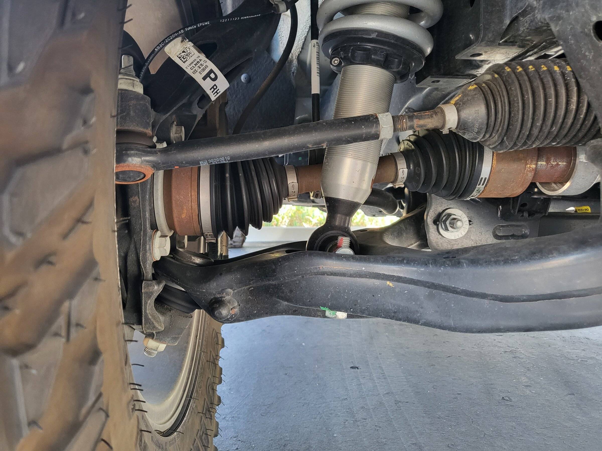

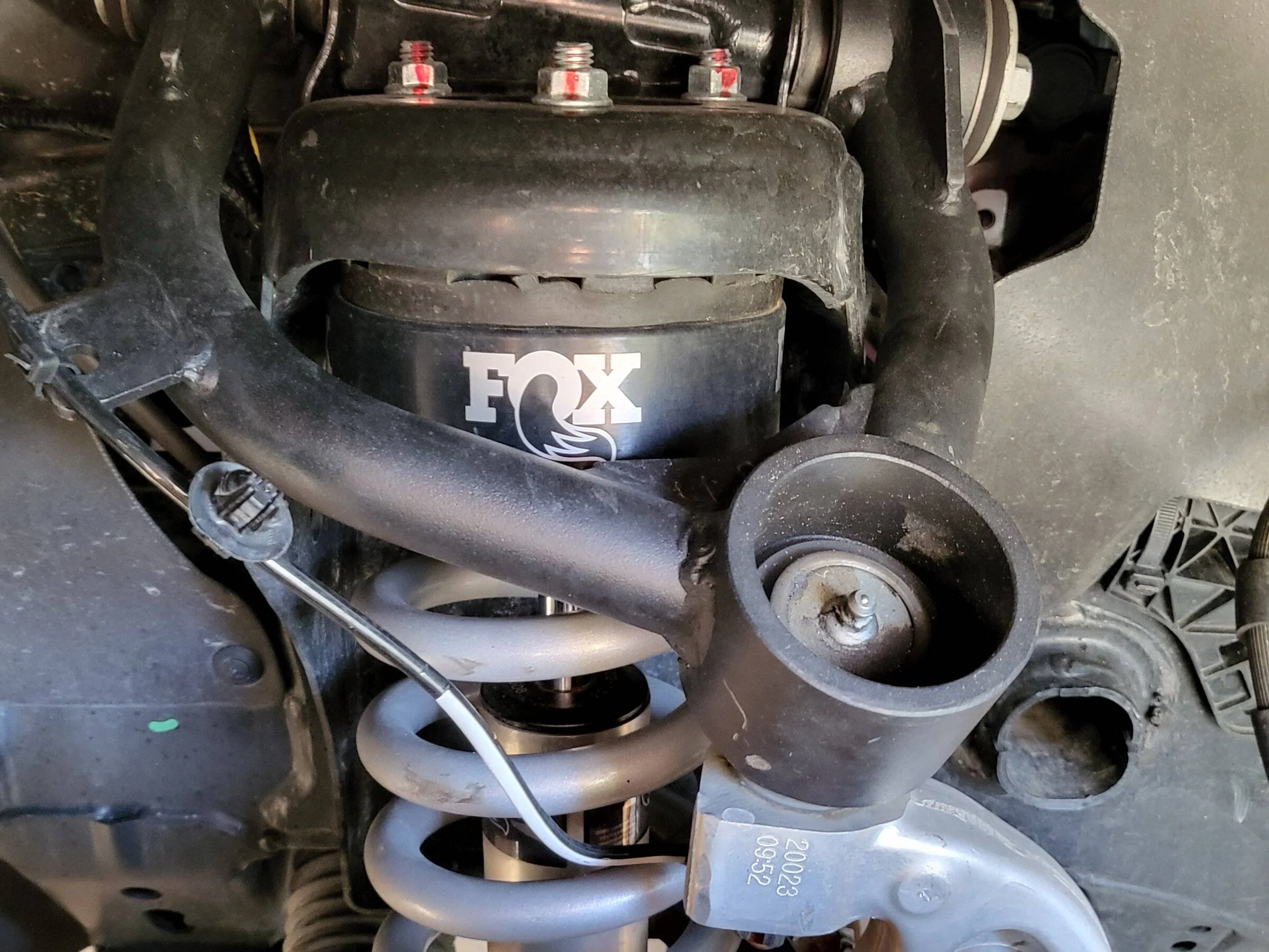

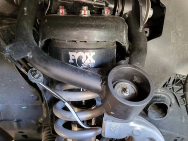

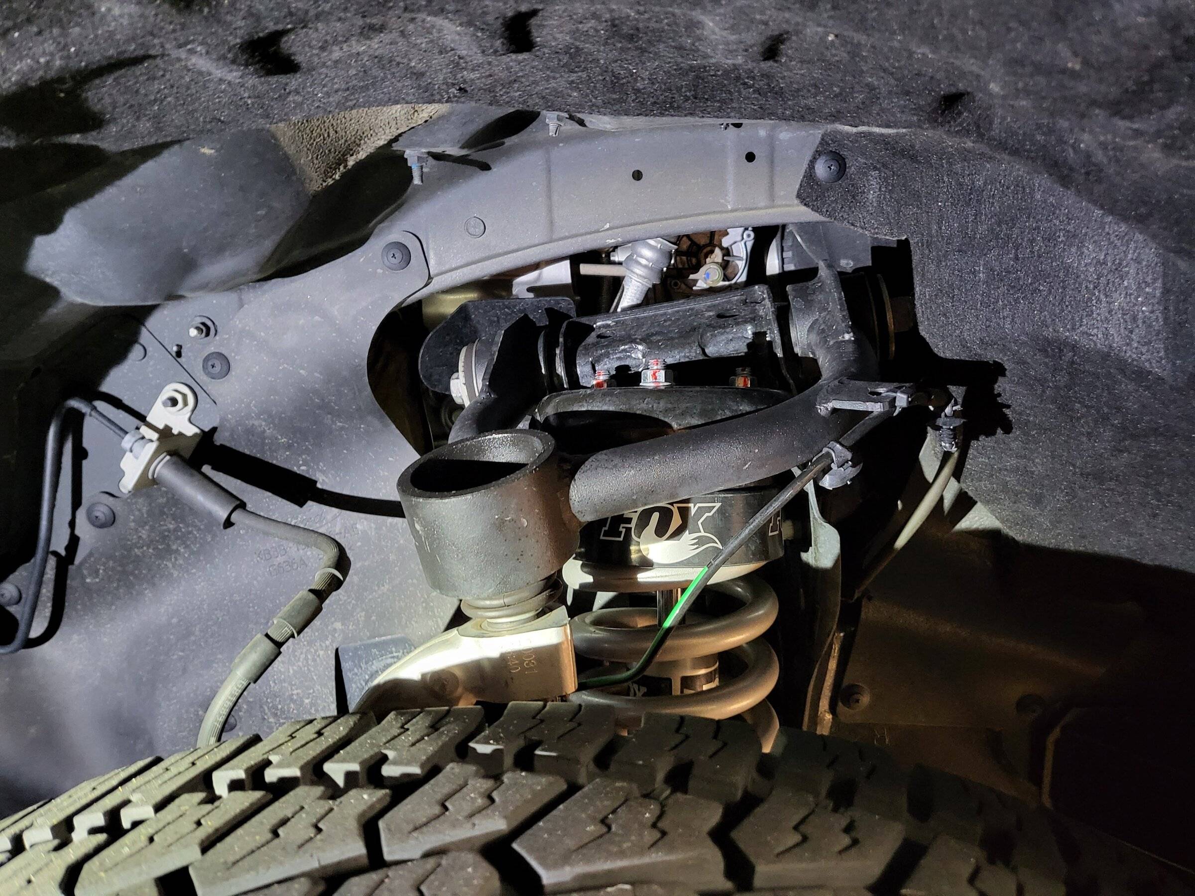

I'm using superlift suspension 3.5 inch, had it for over 1.5 years now. I just notice that the UCA is hitting the metal flange on the housing of the shock. I emailed superlift and they said it is due to the Fox coil over being longer than stock shocks. I'm thinking about using Eiback since they can handle up to 3.5 inch lift.
Take pics of your setup when you are done. I had a weird angle on the CV axles and my mechanic said that I will be replacing it often if I don't change it. Superlift also came with a diff drop but I can't drop it any longer due to the lower arm bar.

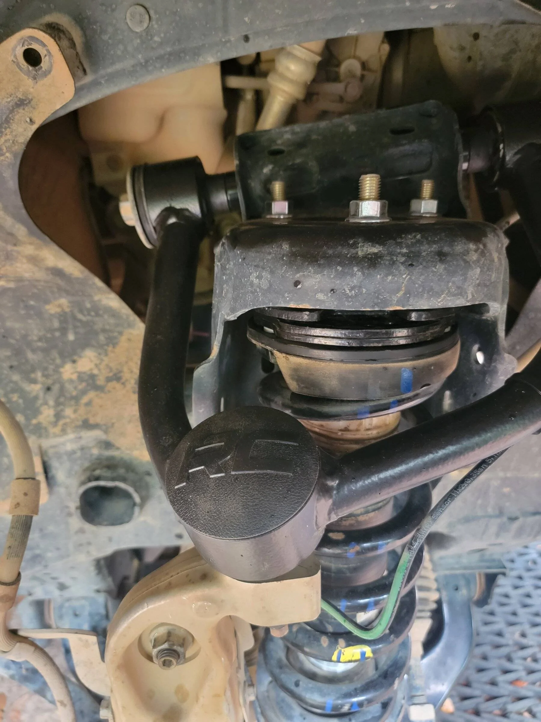

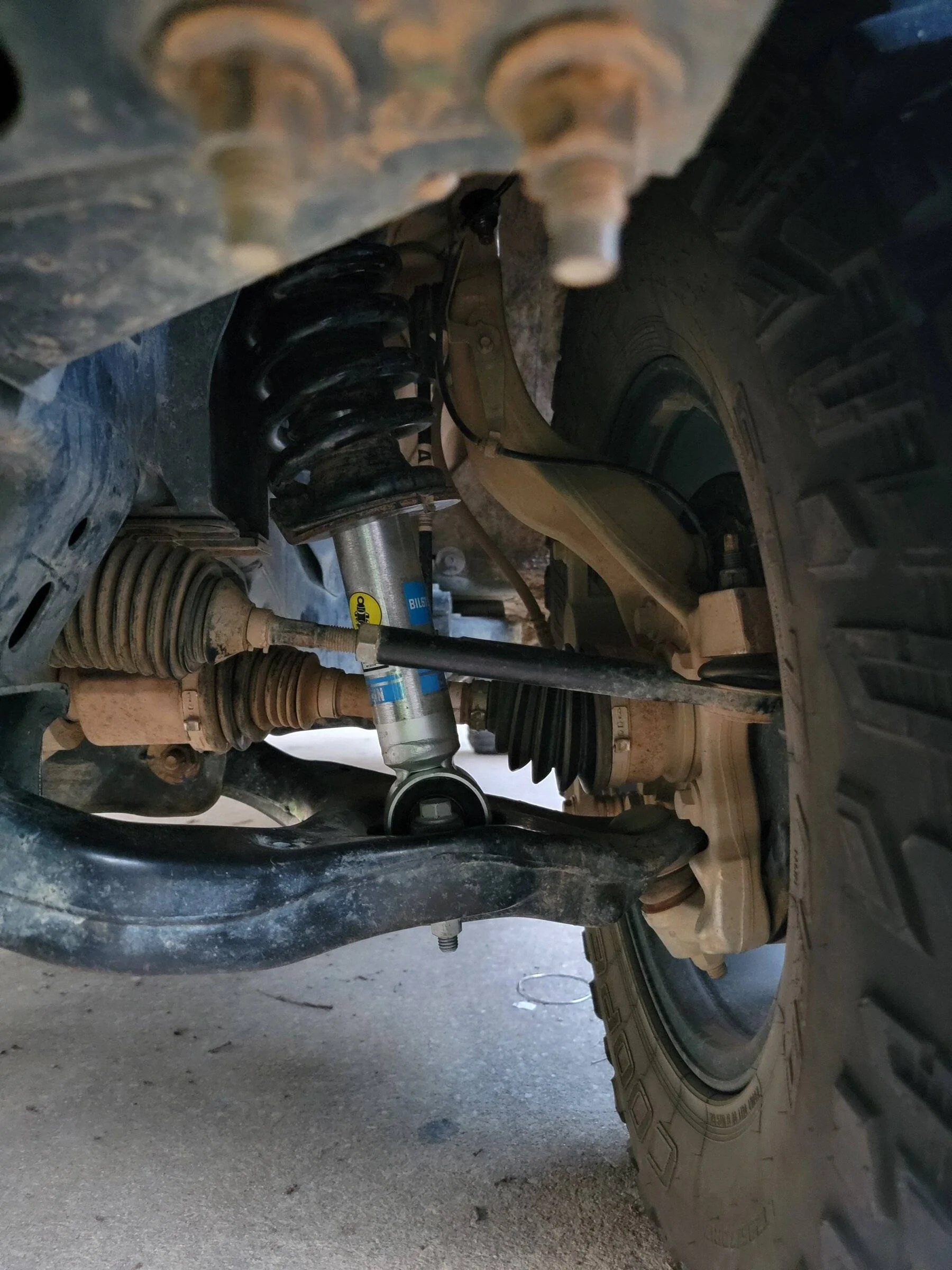

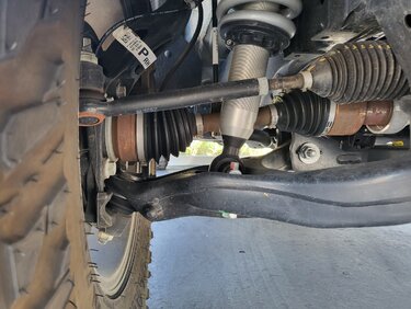

Finished up the installation on Sunday. Just getting around to uploading pics. Apologies for all of the dirt but I don't have a Mall Crawler nor Hanger Queen. With the RC kit it was a huge difference in cv angle as compared to the 3 in Readylift. Sorry I didn't get pics of the cv angle before I started. I can tell you that with the new UCA'S and Bilstein 5100's it's night and day difference over stock.
I got my monies worth from the factory shocks. It was perfect timing as both rears were showing signs of leakage at just over 43k miles.
The angle of you CV is not bad, plus the UCA looks like it clears the flange on both side of the housing shocks. The RC kits might have a better UCA.
Wow those UCA,s are really close to the strut frame mount. Are you sure that all of the spacers were placed on the inside of each bushing? Also could be your alignment needs to be adjusted out slightly to give more clearance?
The spacer is installed on top of the shocks then inside the housing. Superlift mentioned that thier lift is only design with the stock shocks. I had this for over 1.5 years now. I'm thinking of changing the front coilover to Eibach or Icon that can handle 3.5 inch lift. Did the RC comes with diff drop?

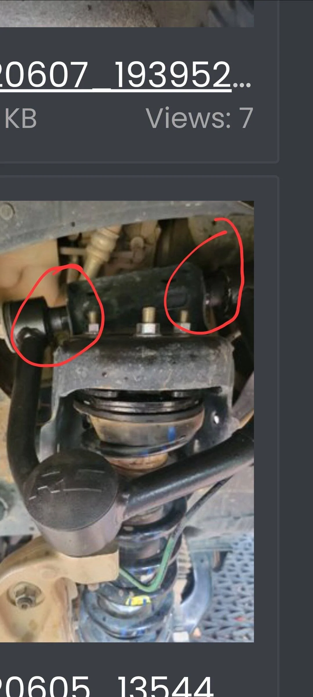

No, I'm talking about the spacers that sit on the inside of the UCA'S. Zoom in on my pic and you can see the spacers that RC provides. These prevent the UCA from being squeezed to tight to the strut tower mount. Not sure if you kit came with these.
Yes the RC kit came with a diff drop for both the passenger and drivers side of the diff. Dropped it like an inch or so over stock.

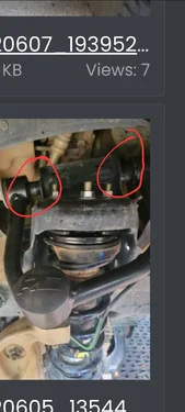

You mean on this one, pics with the circle in red? You had a lot of space there compared to the one I got.
