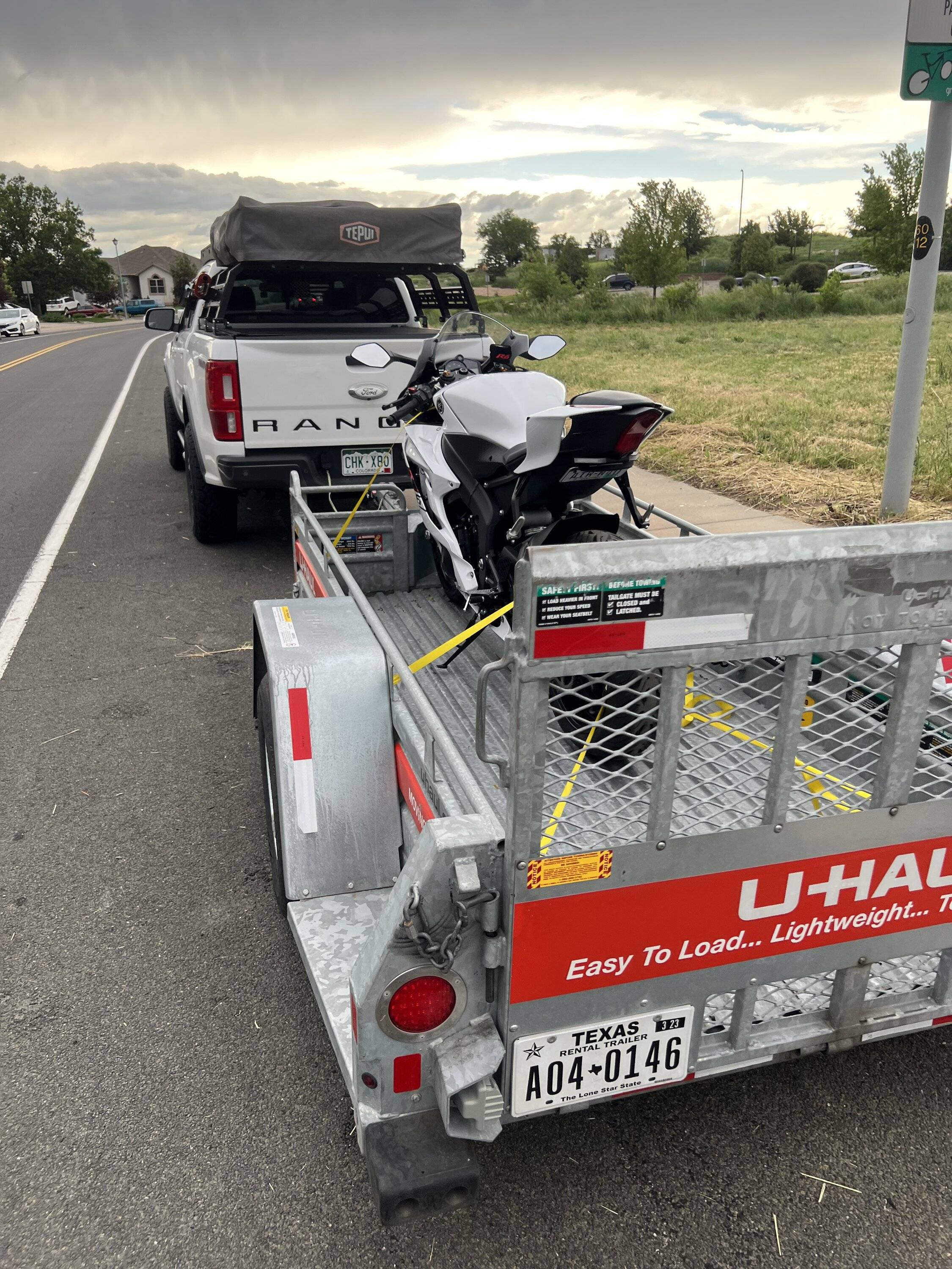

including the most recent pic of my truck for those of you who enjoy matching vehicles

Nice truck! I’ve been running the Toyo at3 285/75r17 for 50k miles now. I have the icon stage 5 lift. With it set to ~3.25” lift up front. I get the tiniest amount of rub going in reverse at some angles, but that’s it. Rear crash bars are still installed, fronts are removed with the stock bumper. The biggest part in getting the tires to fit is the right wheel offset (~25mm) and having an aftermarket UCA with increased caster. My caster is set to 3.9, I think the stock is 2.7.
