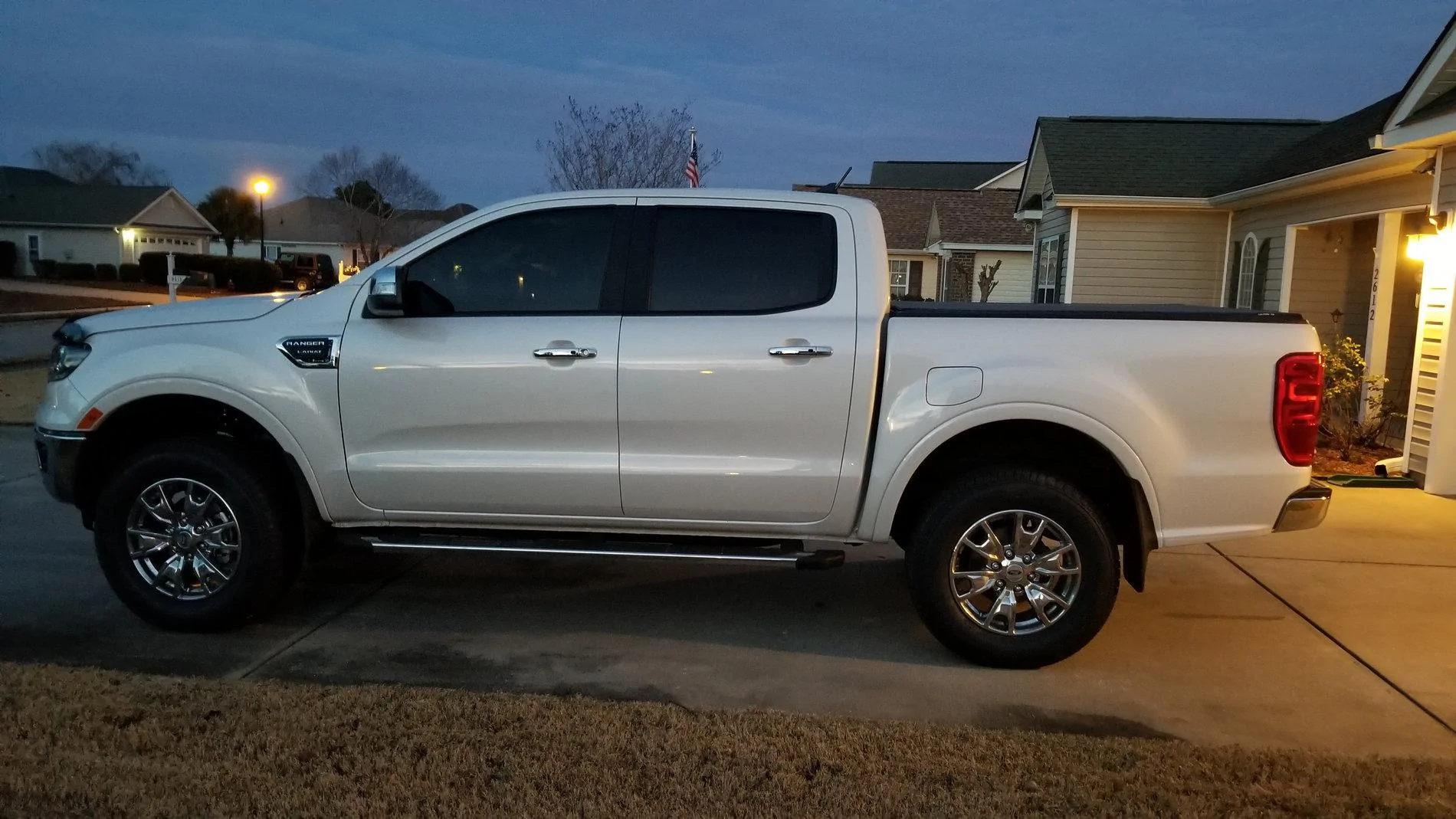

Eibach Pro Lift shocks install without the springs, ...2.25" front. Back is exactly one inch higher after install.
Front from centercap=23" from floor 38"
Rear from centercap =24" from floor 39"
Perfect numbers for me/ No need to go taller. As a bonus, the ride is better. fewer jolts over road hazards. More "planted" Less body roll.
My only recommendation is don't buy tires before you install the Shocks. I would have gone with a larger more aggressive-looking tire, but I'm keeping the Michelins.... for now..

Tom did you put a block in the rear or did the shocks lift the rear 1 inch

No I didn't Bret, The rears are 1" higher than the fronts (after the install). Exactly what I wanted. A slight rake will help when flushing out the bed on level grounds.
IF you go with the Eibach springs you will have to block the rear as they are 3" high in the front which would lower the back needing a block for a 1" level that you get when installing the Eibachs at 2.25
Good luck. This has been the best mod I have done so far relating to aesthetics.

Do you like the ride? Looks pretty level as apposed to keeping a slight rake for ride quality. How’s the ride?
