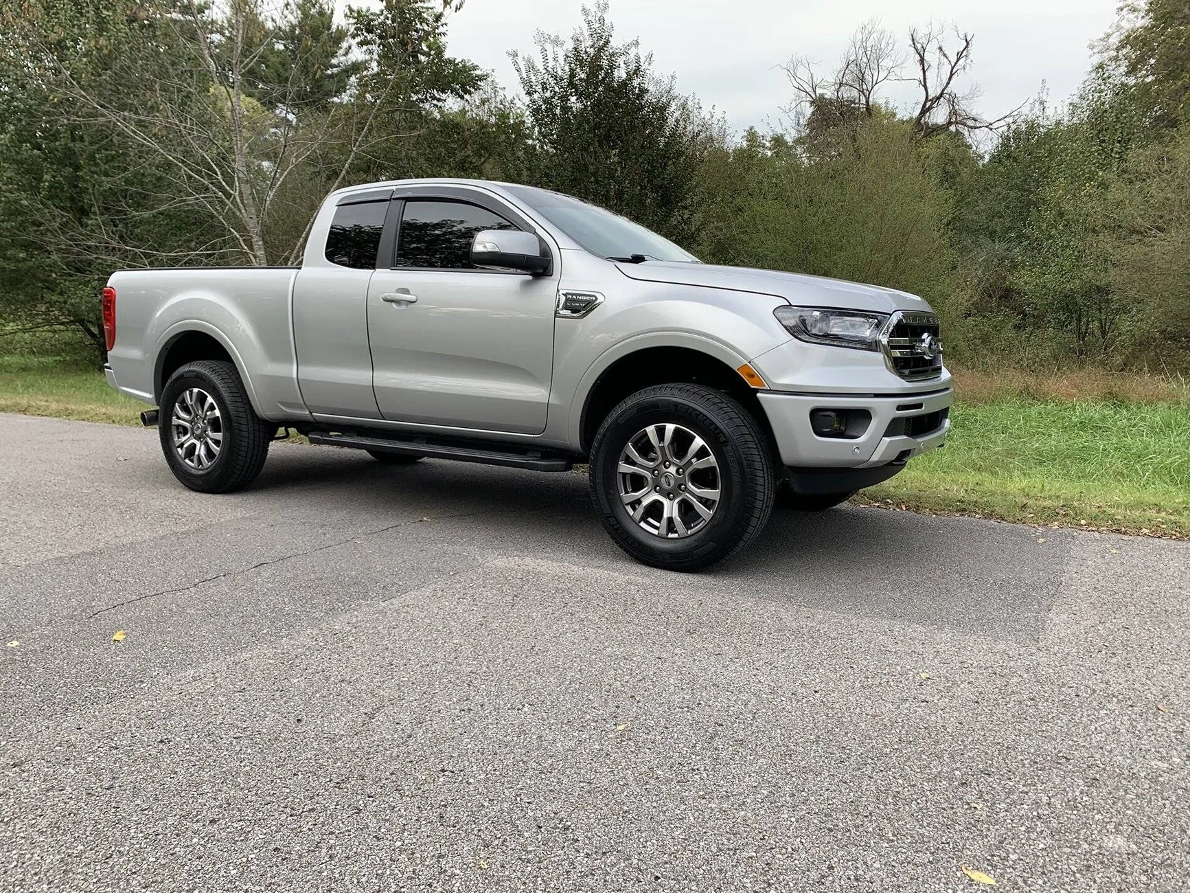

I have 265/70-17's and a 1.5" Truxxx level but they fit fine before I put the leveling kit on.
