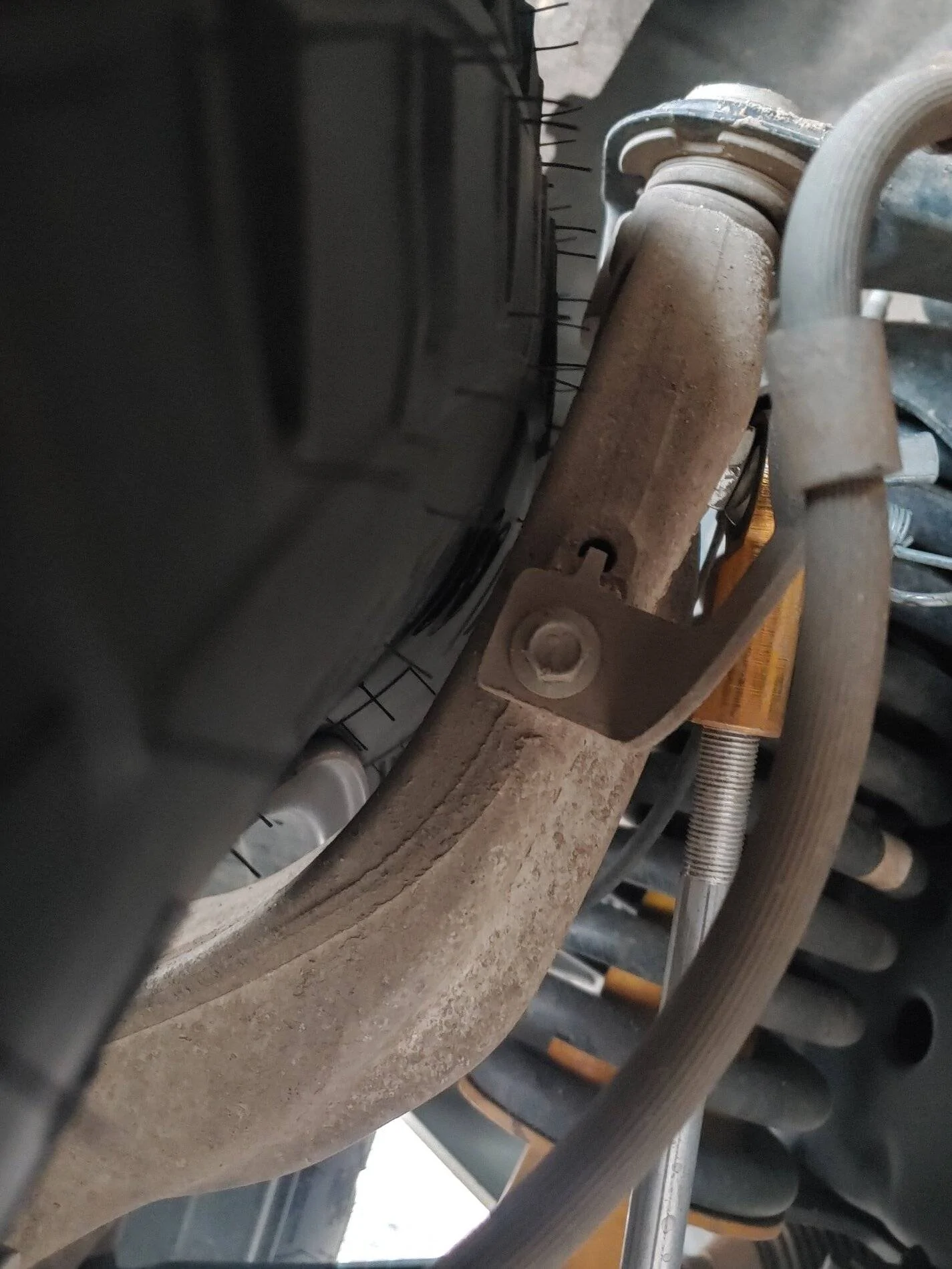

So if memory serves me correctly the tremor is higher than a non tremor Ranger by roughly 2 inchs in the front(dont care ro much for the exact measurements). With that said you theoretically could fit that size but due to the Tremor(Raptor) wheels it may not be the best option. Why you ask? Well those wheels are the same offest as the sport Ian other 17 inch wheels and are also wider. Because of such the inside wall will be closer to the spindal. Due to that you would eithe have to use a wheel spacer(and I dont recommend it) or buy a different set of wheels.
I should also add that not all tires are made the exact same. Due to this not all tires i. That size will make it easy either.
Now you probably wonder what I have. I have a 2019 sport 4x4. It is lifted with Old Man EMU wich provides 2.4 front and 1.6 rear for lift. If anything it gives you a reference. I do run the Firestone Destination XT in 285/70-17 on the sport wheels with no spacers and I manage to do just fine. Could you do it with that particular tire? Maybe but due to the wider wheel I suspect you may rub unless you get the sport wheels or wheel spacers.
I should also add that all i had to do with the crash bars was remove the plastic guard and push the crash bars forward a little.
Here are some pictures for you to reference if anything.
