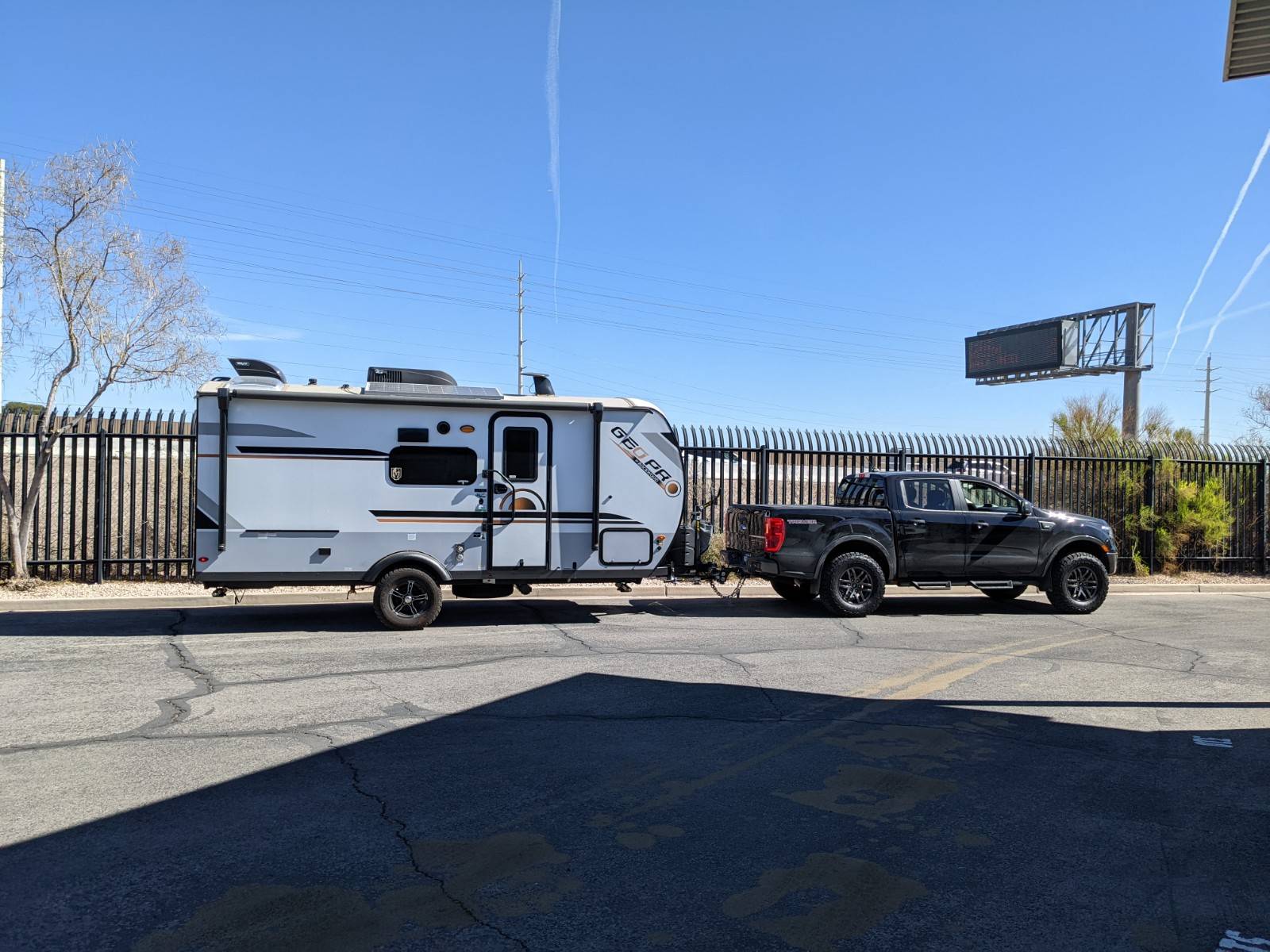

So, I know what you are feeling. I tow a Geo Pro 19BH which is a single axle trailer probably about 4200lbs loaded for the weekend. Short story, get wheel spacers. If you want all the details, read below lol.
The Temor is already a little wider due to the factory wheel offset but on top of that, adding 1" wheel spacers was magic in taking care of nearly all the wiggle I would feel from passing trucks. I got the 1" wheel spacers mostly for looks but was curious if it would help in towing. Well, WOW I was surprised.
In Utah, well before the gas prices skyrocketing, I would get passed by big rigs doing 80mph (posted speed limit) on the 15fwy while I was at 65-70mph. I would move to the shoulder of my lane but would still get some wiggle. Did the wheel spacers and man, I do not worry about it like I used too. Maybe SOME wiggle still there if I do not move but so little I do not care to move unless there are cross winds or headwinds which play into it too.
Sure it still happens on occasion. This weekend coming back from Havasu a lifted RAM 2500 blew by me probably at 80mph to my 58mph (CA 55mph speed limit) and I felt some wiggle but I didnt move or anything. Nothing incontrollable, plus a cross wind that he interrupted as he passed.
I will just say, wheel spacers were a game changer. Just get quality hub centric ones. Check out Stage3 performance. That is where I got mine. Or, if you do not like wheel spacers that much, change your wheels to the appropriate offset and make that an excuse to upgrade wheels.
You will likely need 1.5" spacers to match my track width. Plus I have 285/70/17 but that is less of a factor I think.
