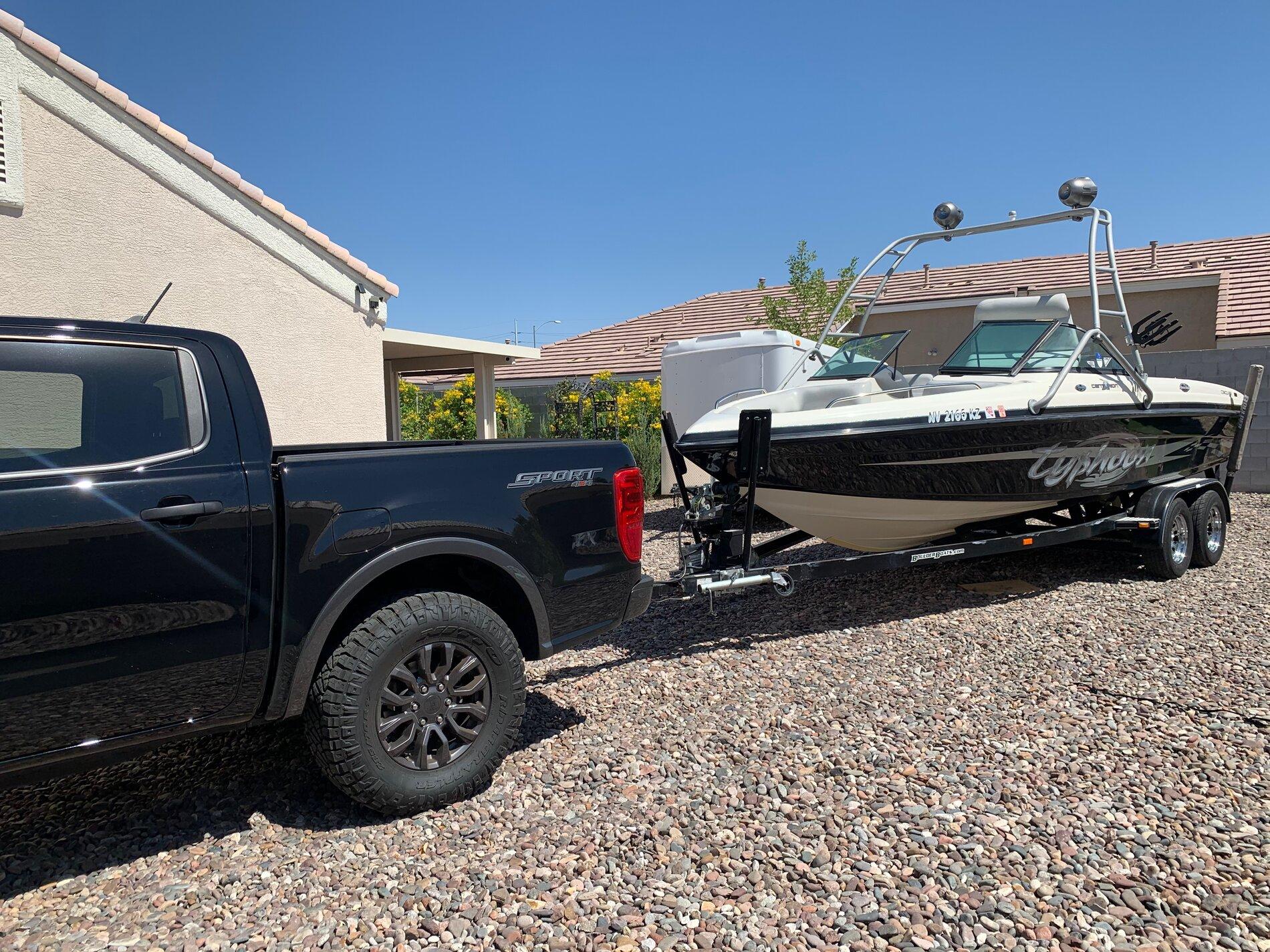

My boat is probably 4,000lbs with a full tank of fuel. Ranger handles it quite well and I have no issues or concerns for relatively local towing. Not sure I'd want to pull this across the country, but no doubt the Ranger is capable of it if I needed it to.

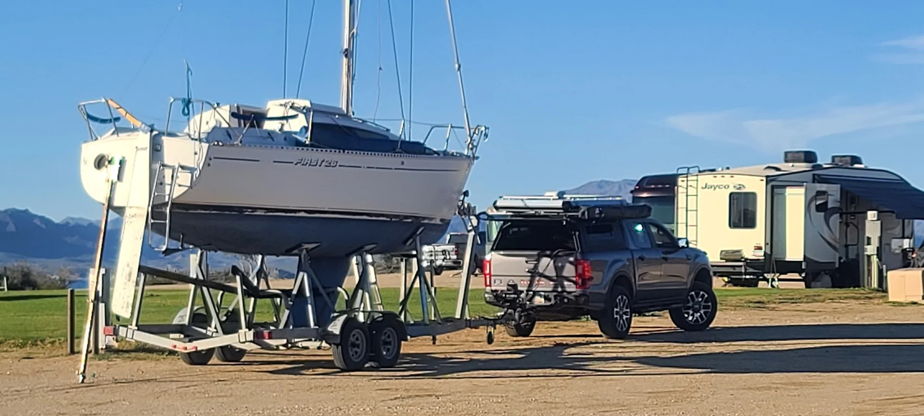

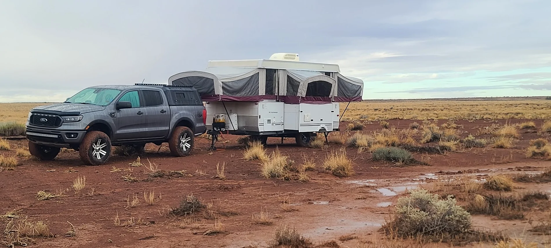

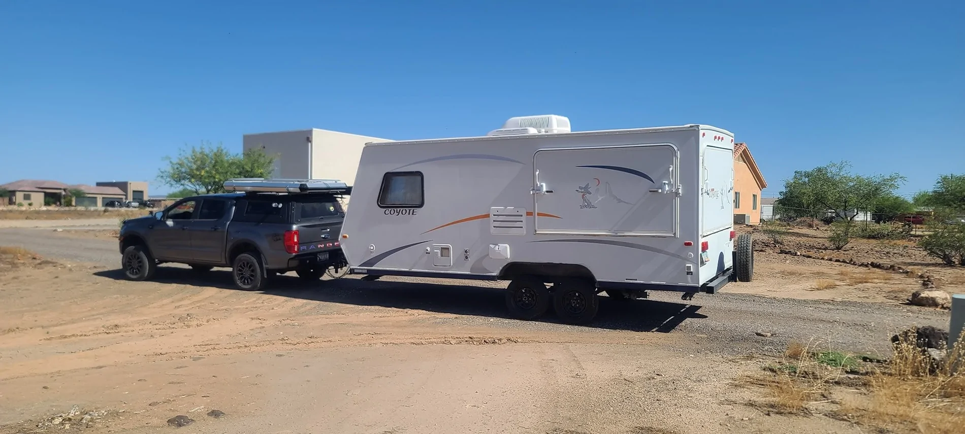

My 22' TT is pretty easy - 4400# - Trips to Dolores CO, Yellowstone, and this year Glacier NP.
Little more challenge with my 26' Beneteau 26 - 7000#..
And when I feel like getting offroad - my little popup is hardly noticeable @ 3500#
Note - for the longer on-road adventures, I keep a set of OEM tires and rims. For offroad and local, the 315s do just fine.
Setup: 5000# airbags, Brake Controller, bunch of bolt on engine stuff, 5 Star towing tune, and travel around 65mph
