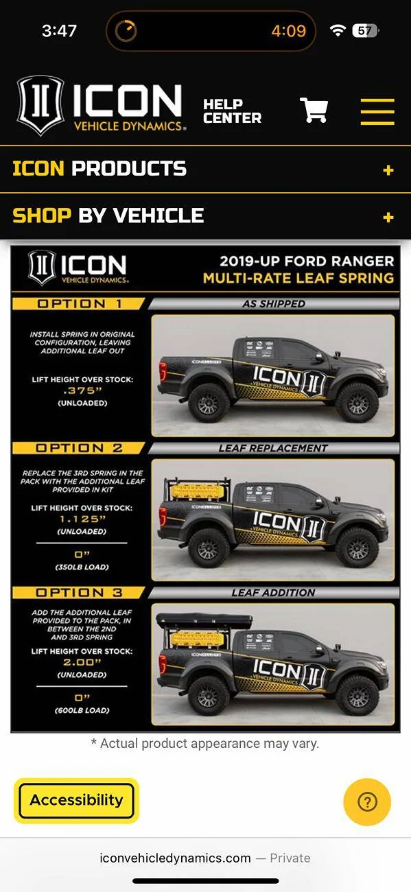

Shock Surplus videos are EXCELLENT! I got the Eibach Pro Truck and they are great. Do they make the Icon leaf springs with no lift?
OGMix376
Bryan
Jun 30, 2024
1,033
3,530
Pulled this off their site.. looks like at very minimum you’ll be at .375 of and inch lift in the rear at the lowest configuration.. hope this helps…
