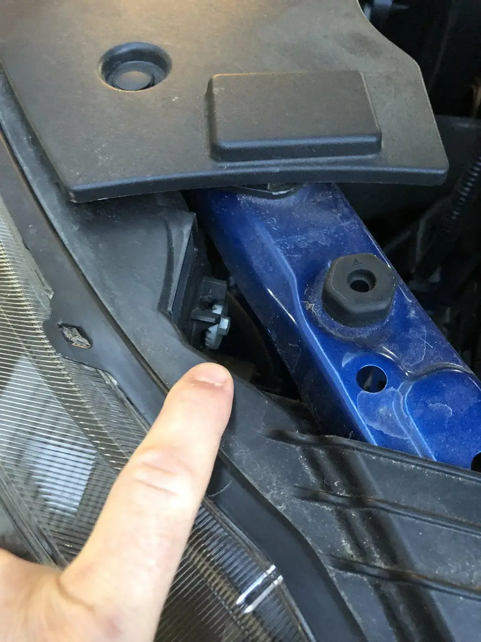

I have a 2020 ranger and know where the headlight adjuster is. But which way do you adjust it. Is clockwise as if your standing in front of the truck. Or if your sitting in the driver seat

Use a Phillips head screwdriver. Too much torque with an 8MM. I stripped mine and had to replace the headlights.

Not sure how much you need to adjust. Tried using a philip screwdriver at first, but it was taking forever. Use a philips bit with a drill.
Goes a lot faster and easier 😁

i was actually thinking the same thing.I thought the screw was broke or something.So i backed it into my garage ran tape across the door.Took 20 turns to even it out with passenger side.
