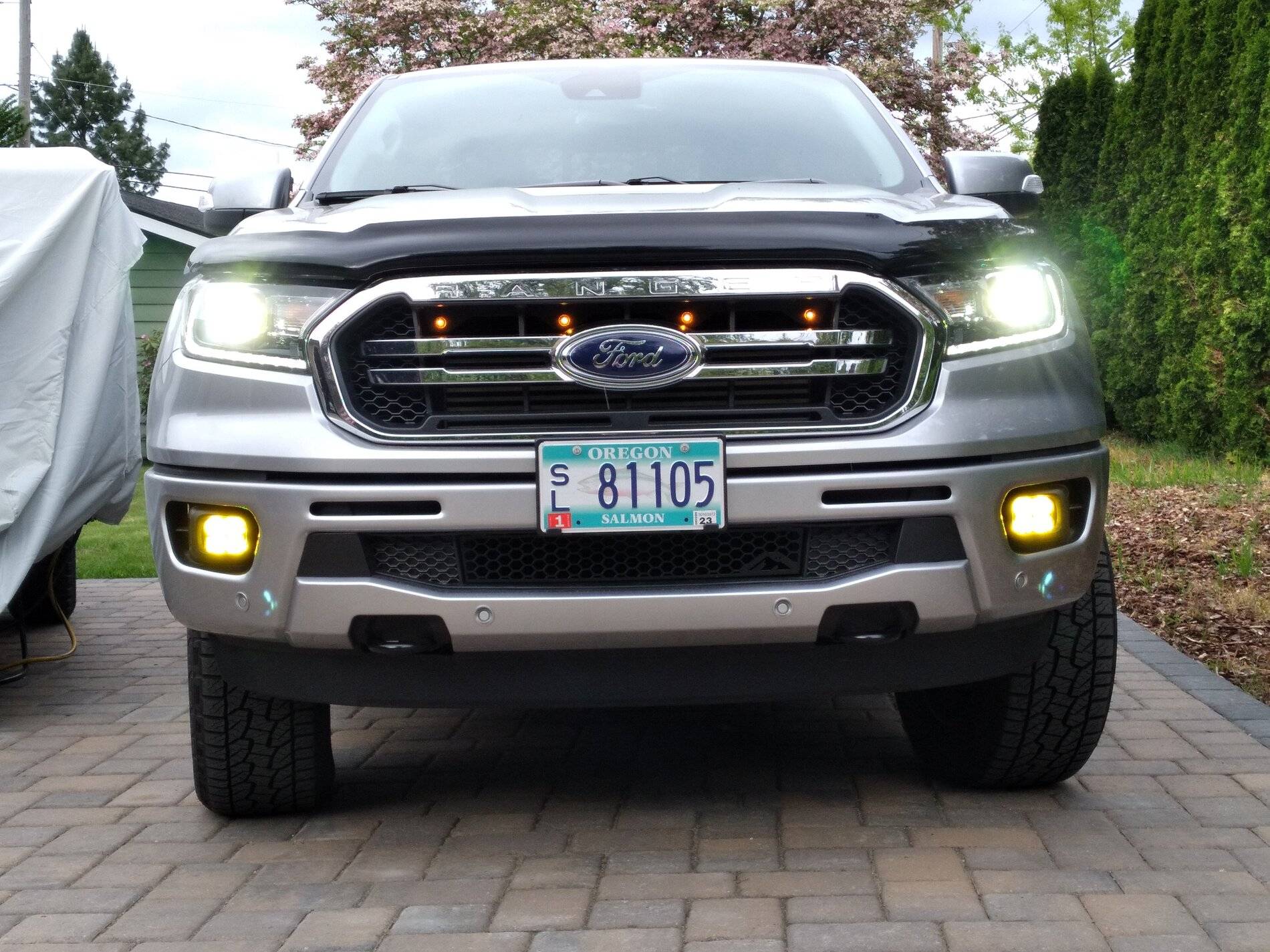

OK I changed my stock fogs to the Diode Dynamics SS3 Pro yellow and love them. They are frigging awesome. The picture doesn't do them justice. They are very bright. I like the yellow in the rain and crappy weather. Much easier for me to see the road and any potholes and crap. Also it's easier for other vehicles to see and notice me. They were very easy to change. It took 1/2 hour to do both. I did have it up on a lift at a friends house which made it easier.
