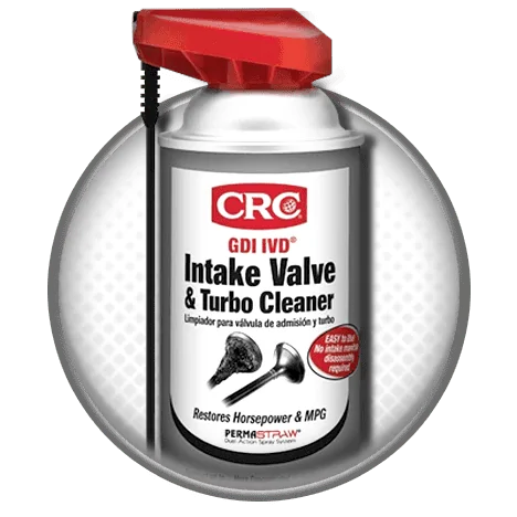

I noticed this as well, and this was on an abused engine. Don't think I'm going to be wondering when I need to get my valves cleaned anymore. Might try an endoscope at 100k to see how much buildup is on them.
I used this stuff every 10K in the GTI. It works. I removed the MAP sensor and sprayed it into the intake port.
