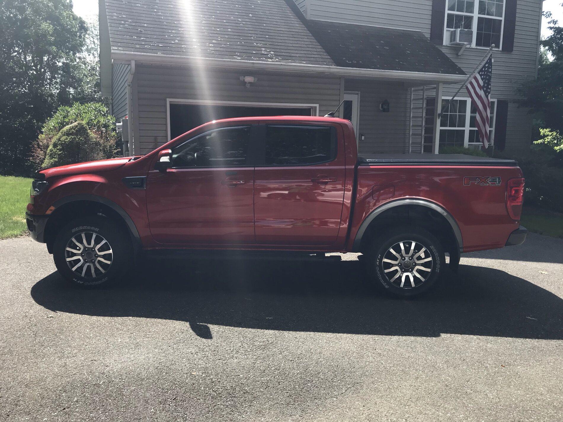

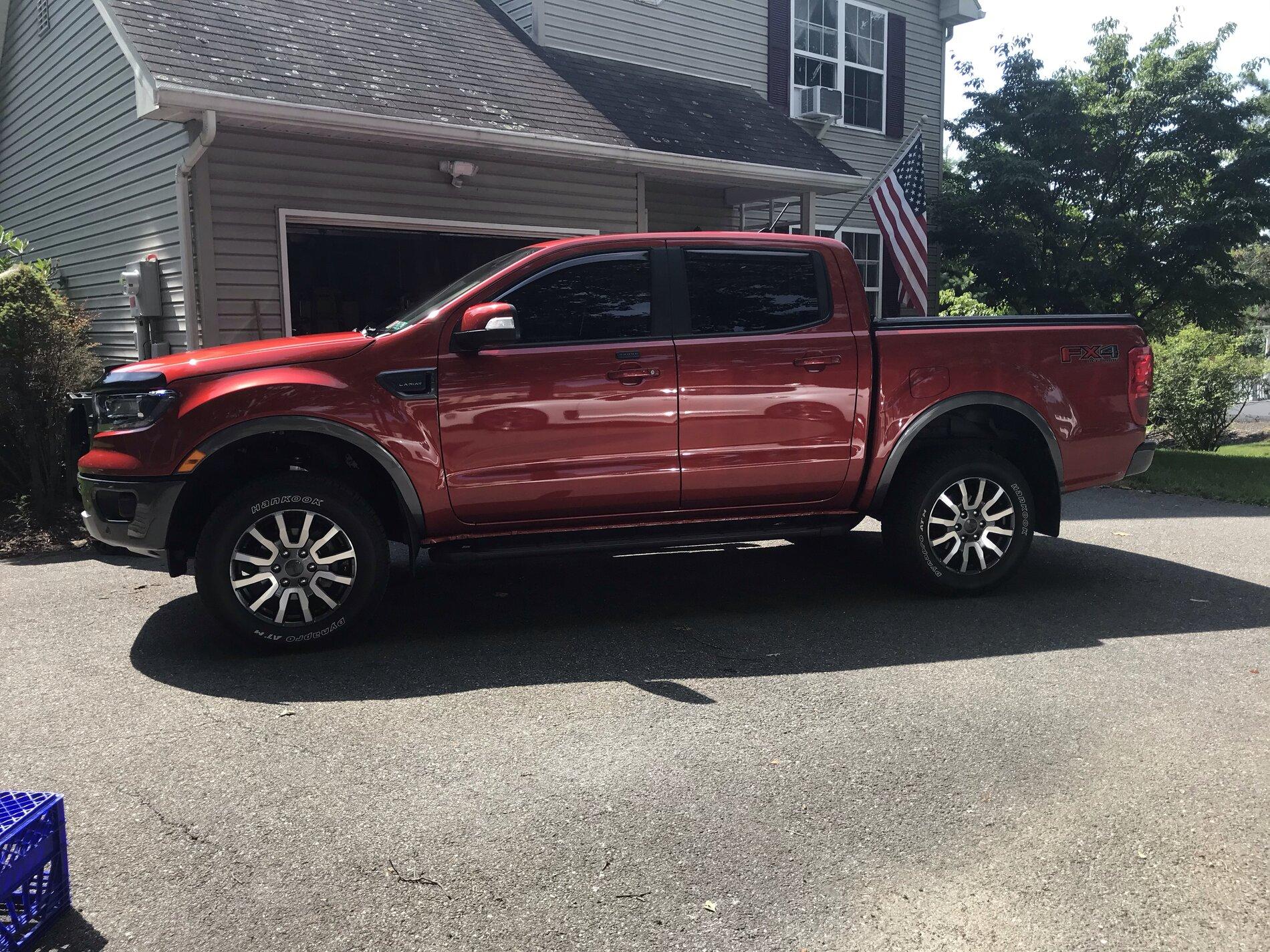

This is with the Eibach’s front and rear.
With a 2.25 lift up front?
Yeah, from an aesthetic perspective the front can benefit from some lift.

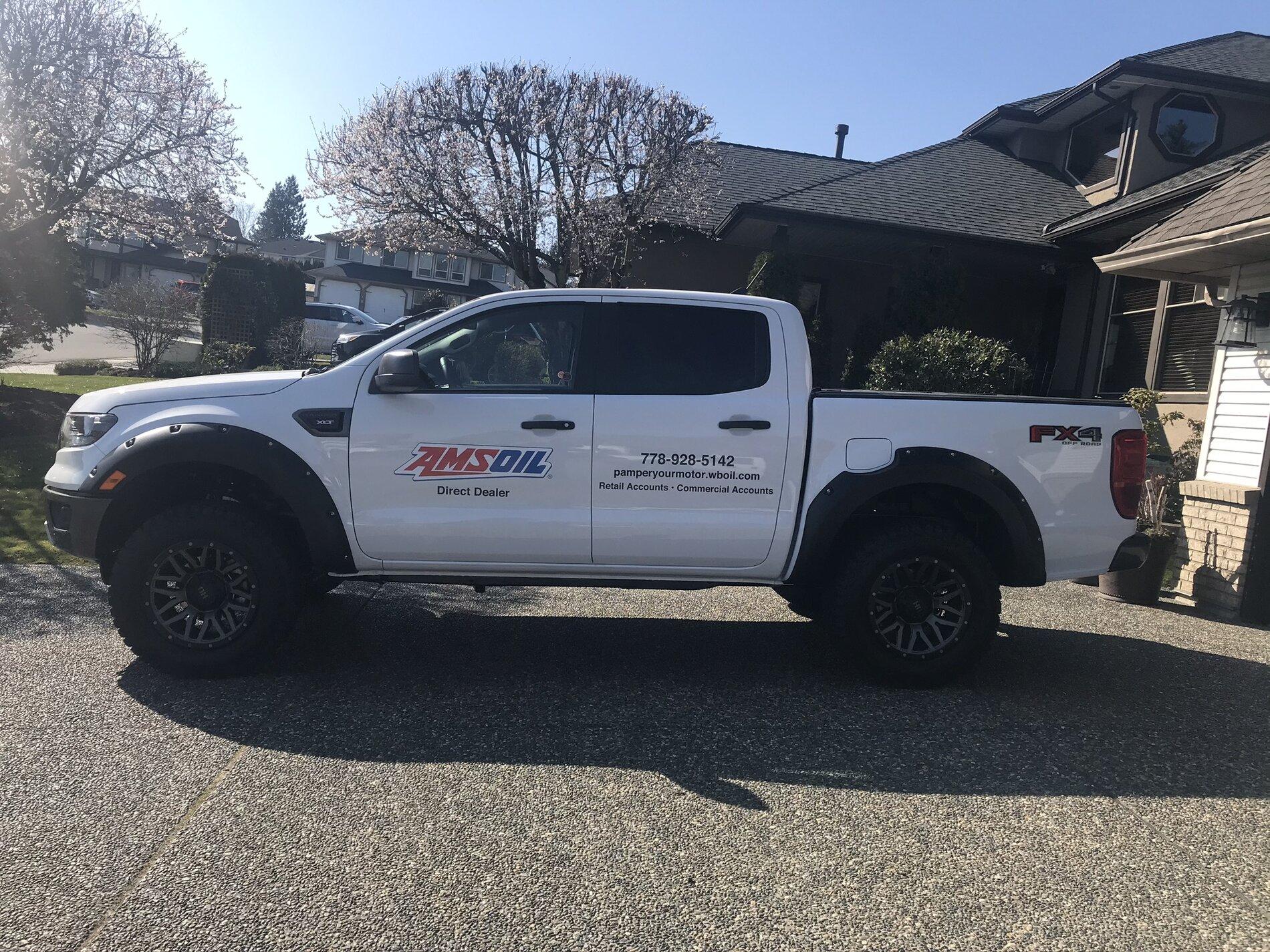

I love the leveling kit. I had the dealership do it as part of the purchase. An alignment had to be done. I think it improves the look of the truck.
