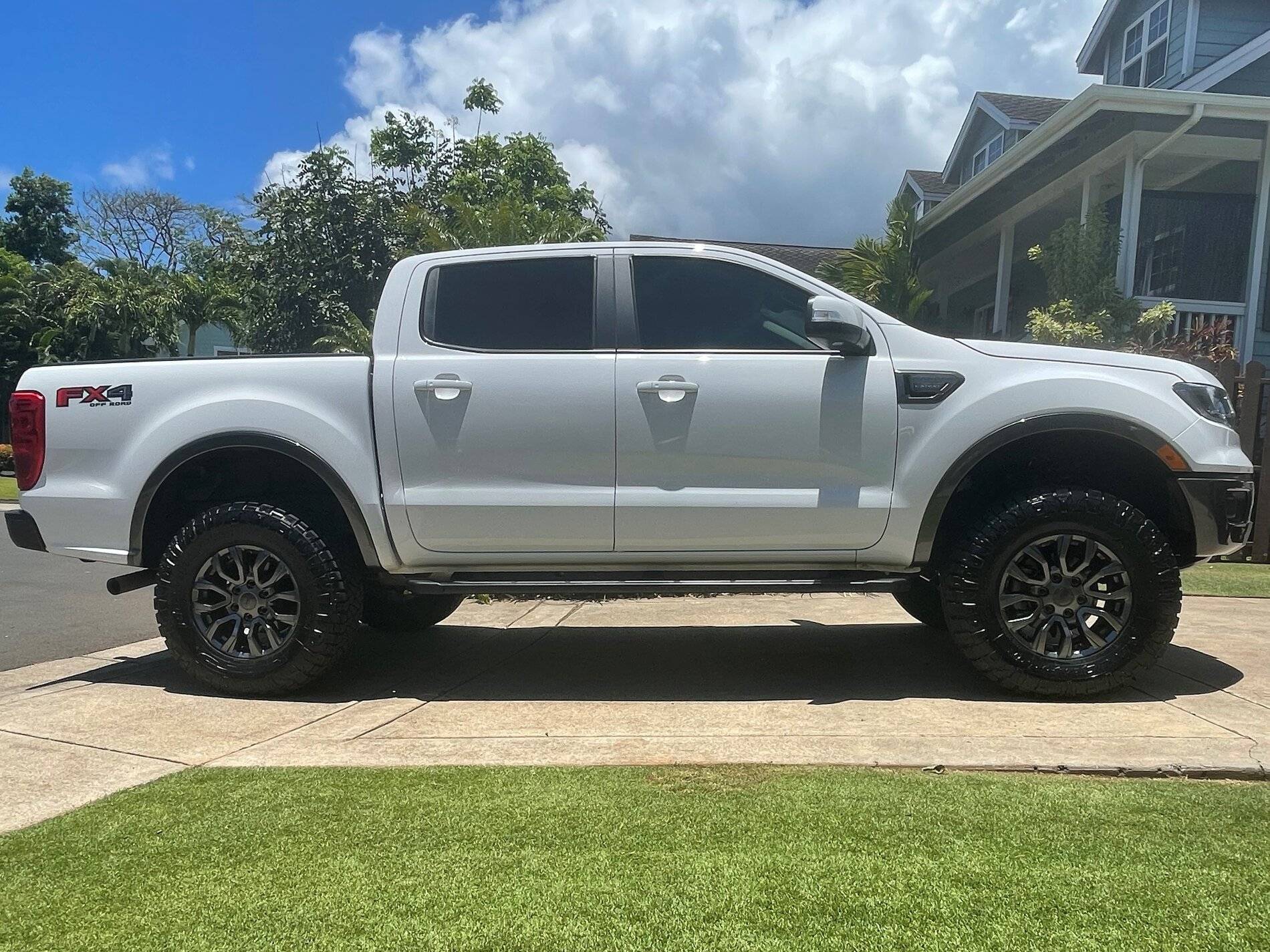

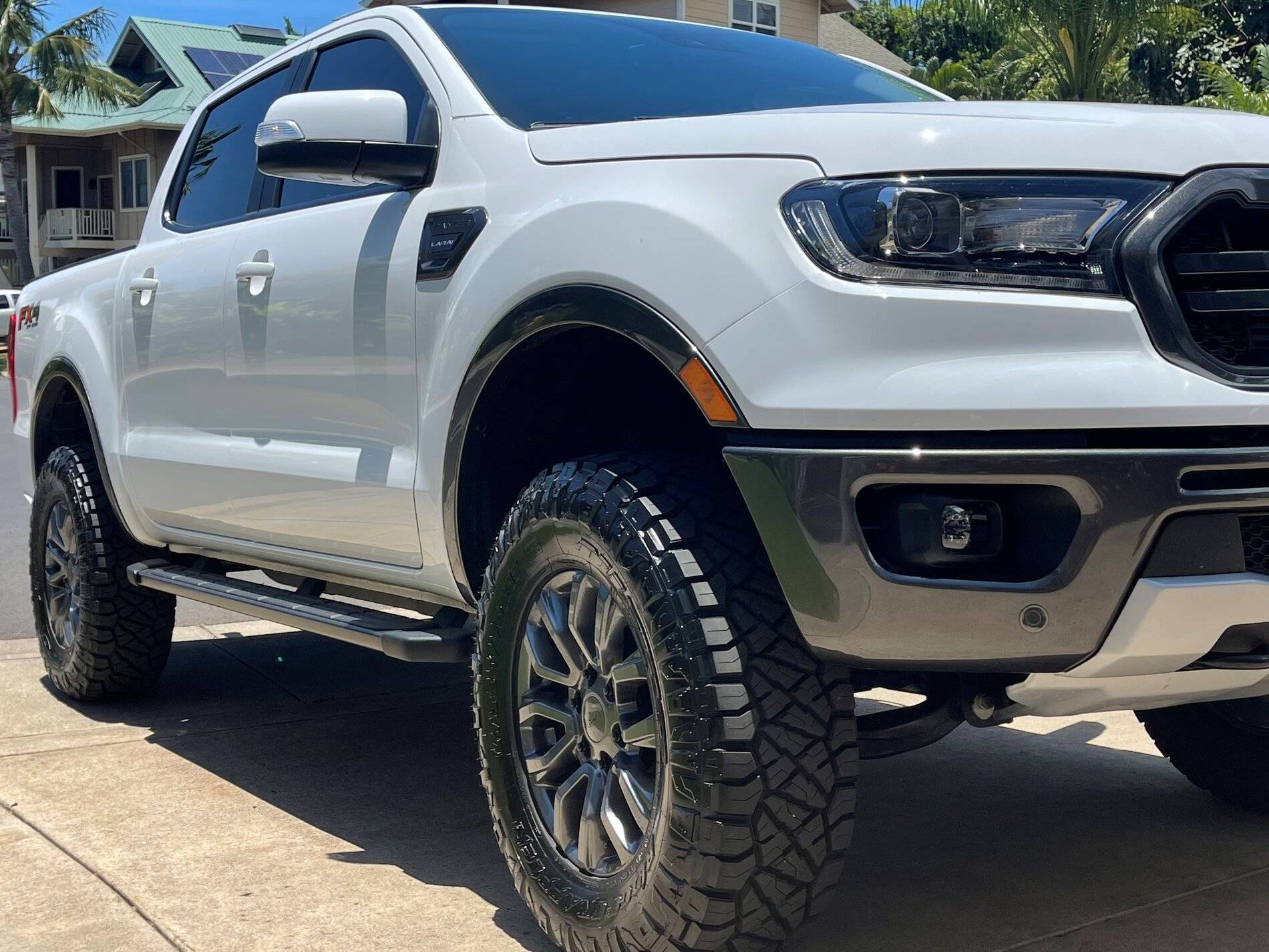

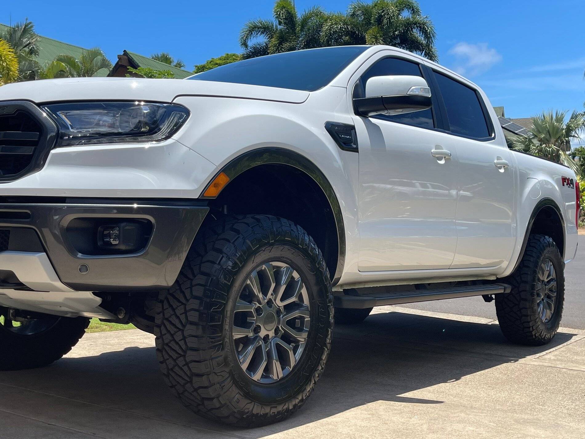

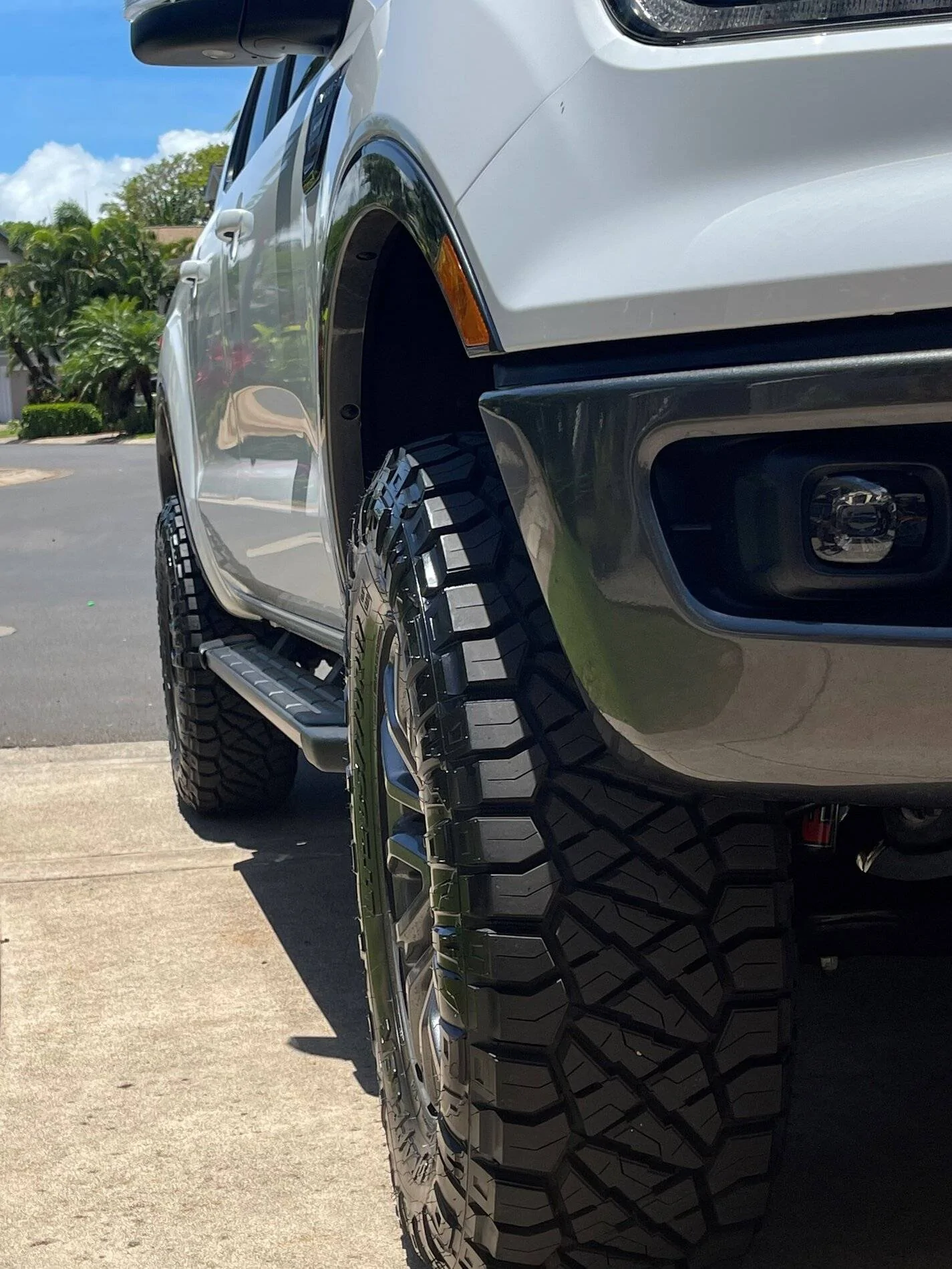

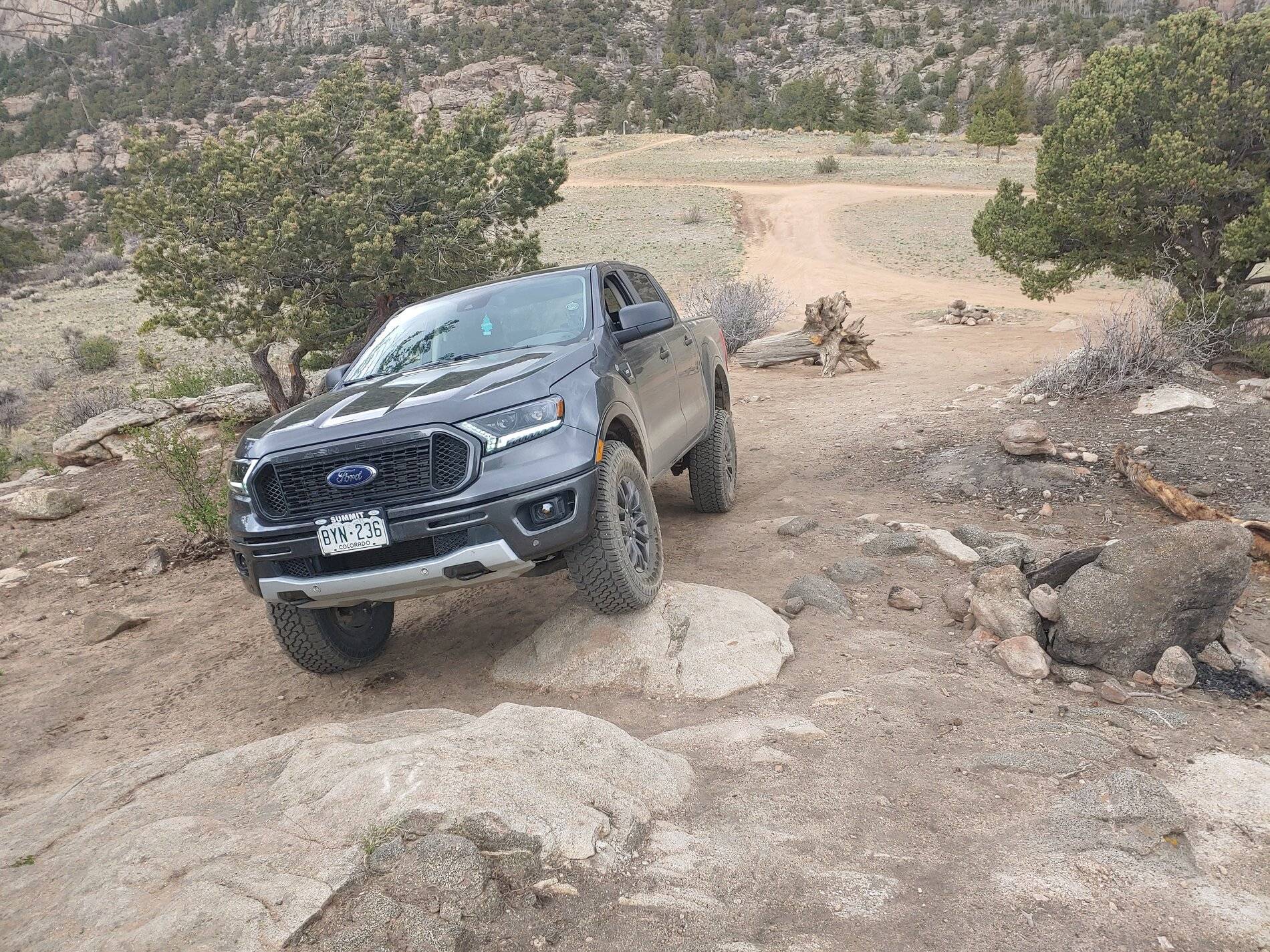

With Firestone Destination XT on 285/70-17 I dont rub the knuckle what so ever. If anything on the OffRoad in a turn and suspension compressed I only have minimal rub on the front crash bar.
Heck yeah! Plus that is much wider tire. Looks great!

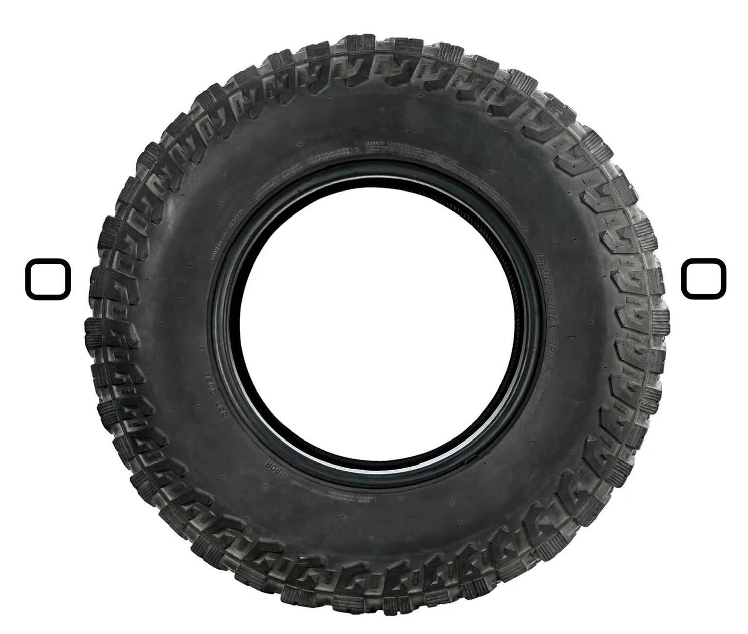

EDITED: Hey @The_Kings_apostle , I’ve updated this to help you visualize how offset and lift play out when it comes to our trucks.
Offset and Levels and Crash Bars - Oh My!
Offset
Here is a stock +55mm offset wheel setup
(The lines represent the crash bars)
Now, push it out 2” (the grey area) with a 0mm offset wheel…
All looks fine - cool - so far, so good, right?
Not so fast, let’s go back to the stock setup again…
Now, turn the wheel all the way to the left…
You can see how the sidewalls get closer to the crash bars
Oops - the tire is now into the crash bars - rubbing - not cool.

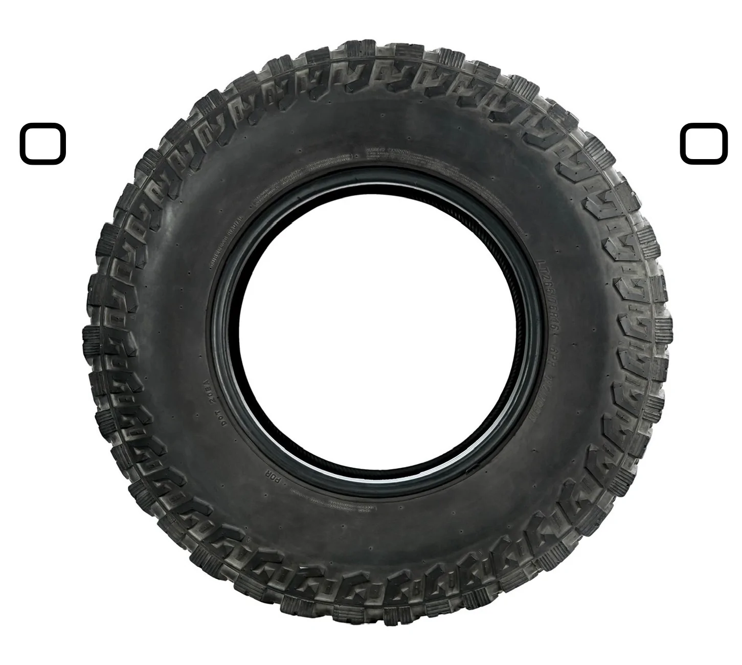

Levels and Lifts
Lifting the front end of the truck moves the crash bars higher above the arch of the tire, giving you more room to work with in the scenario above. The small rounded corner squares in the images below represent the crash bars.
Factory height…
There’s a limited amount of room between the tire and crash bars but when you lift the front end, you lift the crash bars higher, creating more space.
Here it is lifted/levelled (exaggerated for emphasis)…
Now, there’s much more room between the tire and crash bars.
Added Bonus: Other things that tires can rub on such as, fog light housings, wheel well liners, and crush blocks are also lifted out of the way at the same time.
Good luck!
