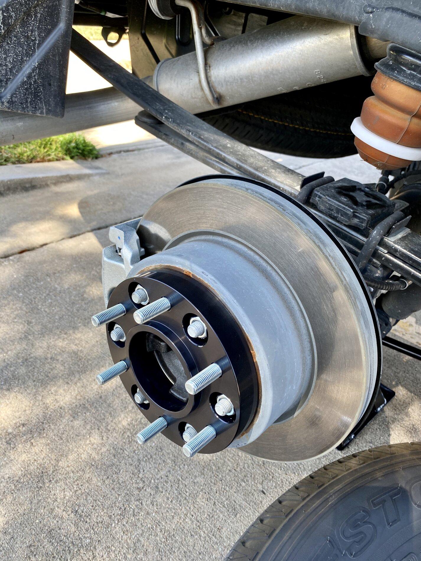

If using 1” wheel spacer, does anyone know if you need to cut factory studs? Or is there a relief on inside of factory rim. Thanks for any help
I went with the 1” Bora Hubcentric ones, comes with the required bolts and u reuse the OEM studs to the Spacer

There is a relief on the inside of the rim
