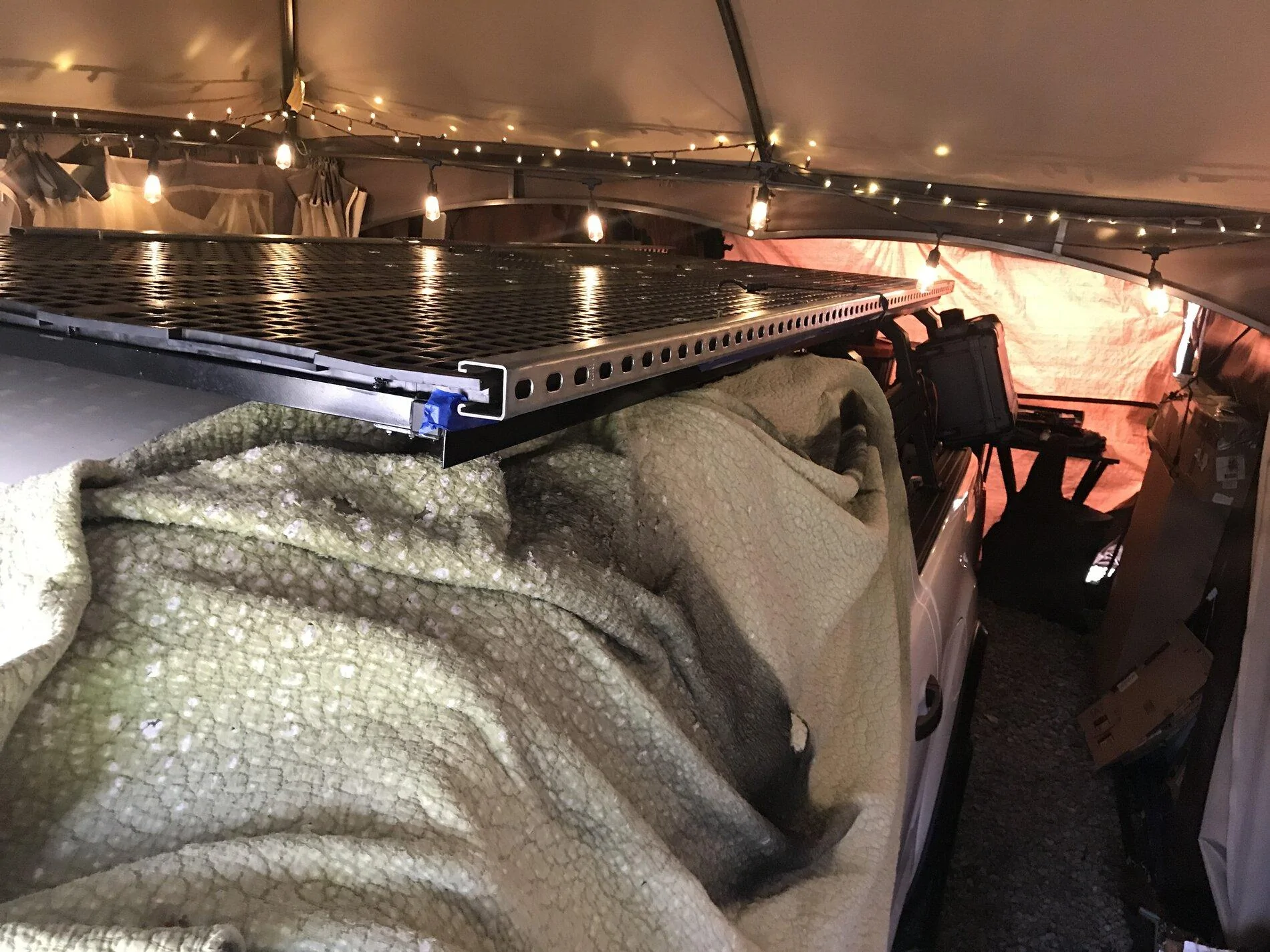

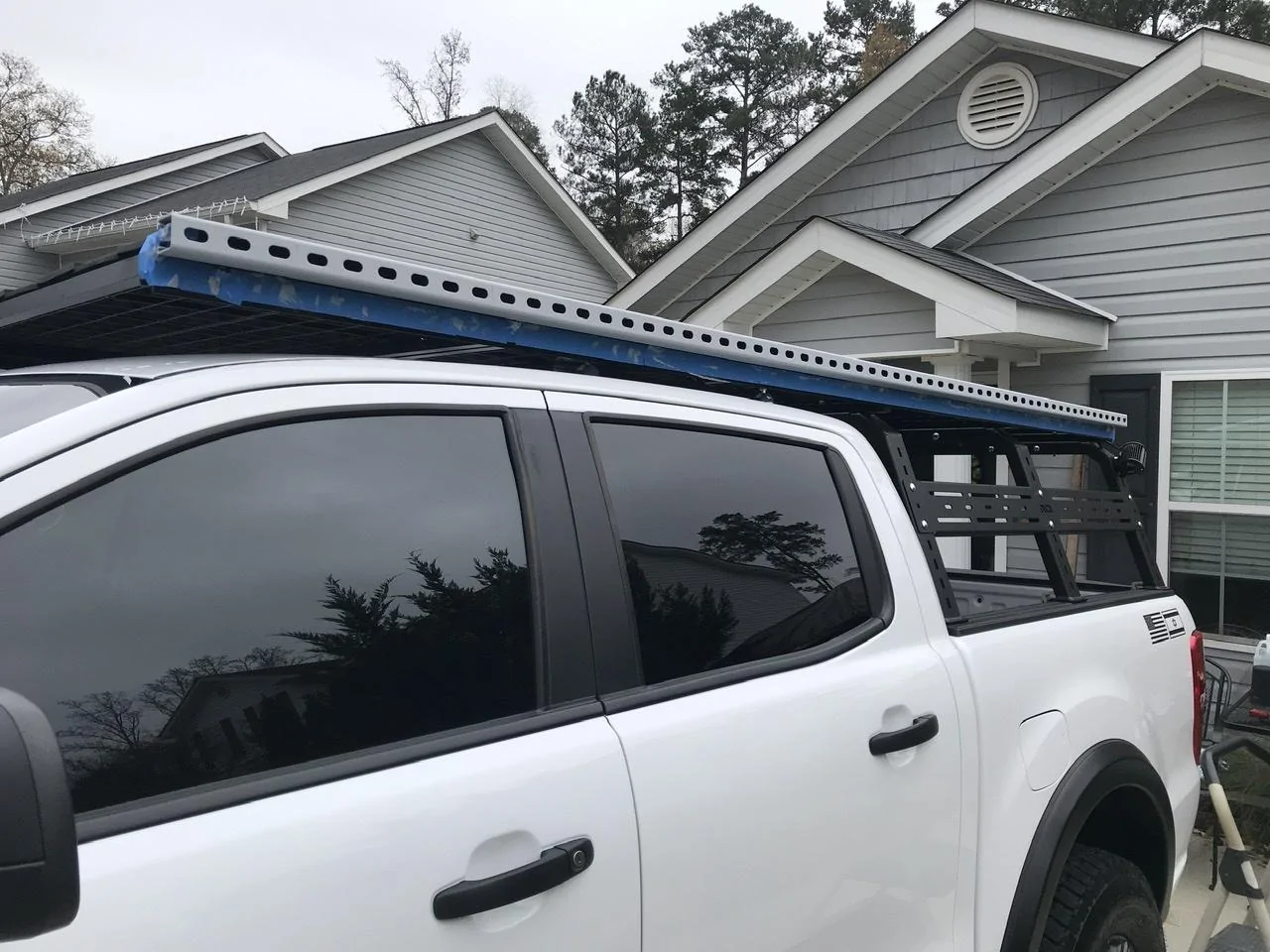

So this worked out with pure dumb luck (bolt clearance) I could slide them on about halfway and then had his rubber mallet the rest. These won’t even come off without bolts unless the flooring breaks but of course I will be securing it.

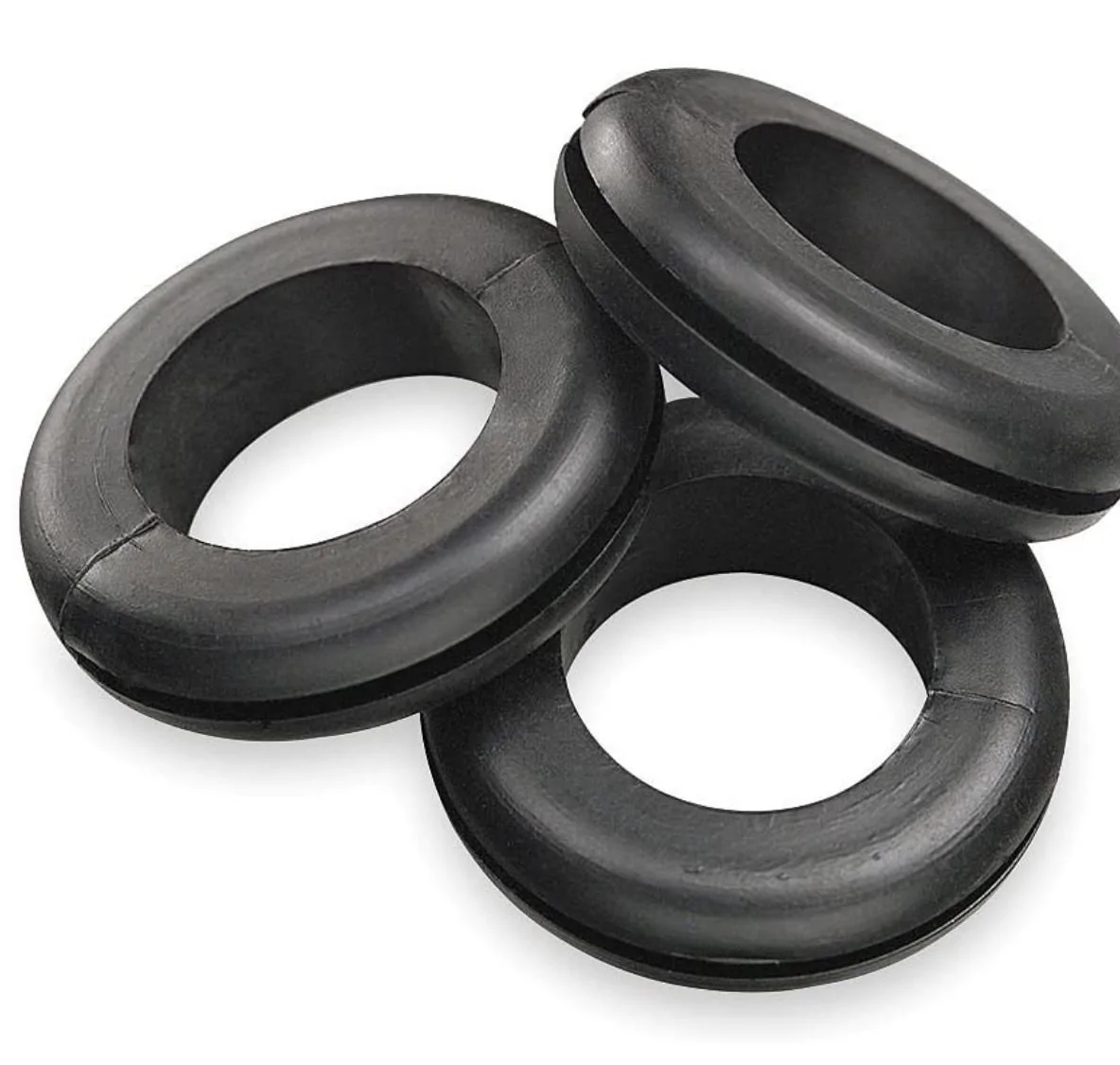

I want to run rubber grommets, o rings, or gaskets for the slots on the framing strut can anyone advise if there is a product made Specifically for this or do I just need to find a grommet of similar shape and make it work. (see image)
The problem is the slots are oblong and not circles I suppose I could do a form of weatherstripping without issue but I would preferred to be seamless.
The plan is to install them with black sealant to prevent any city water or dirt from getting under the ring.

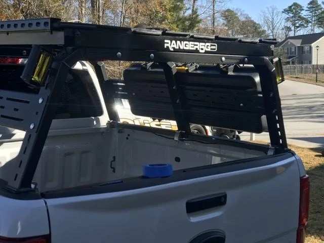

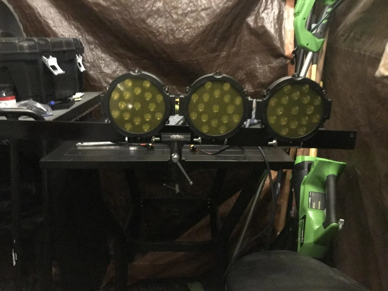

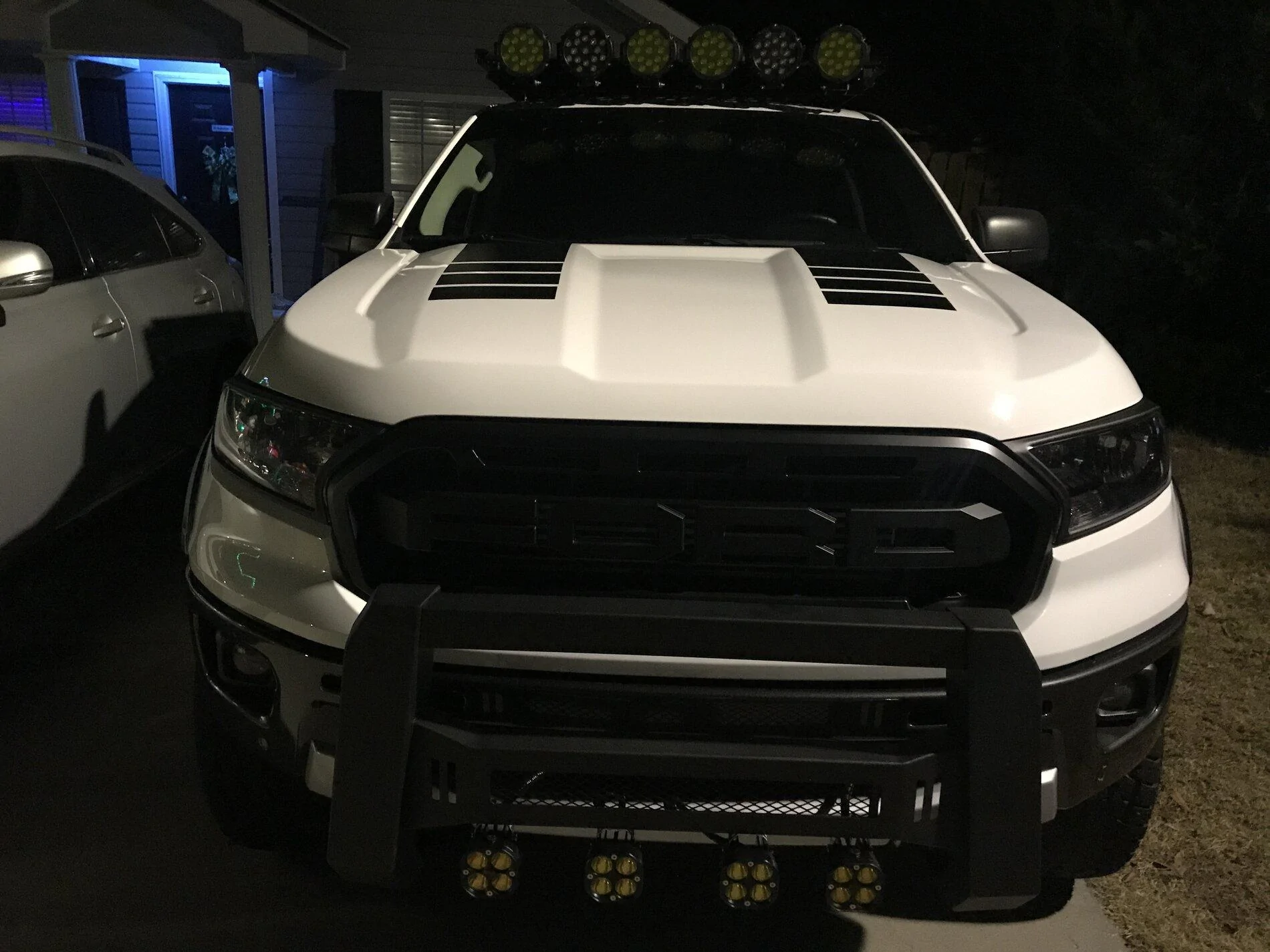

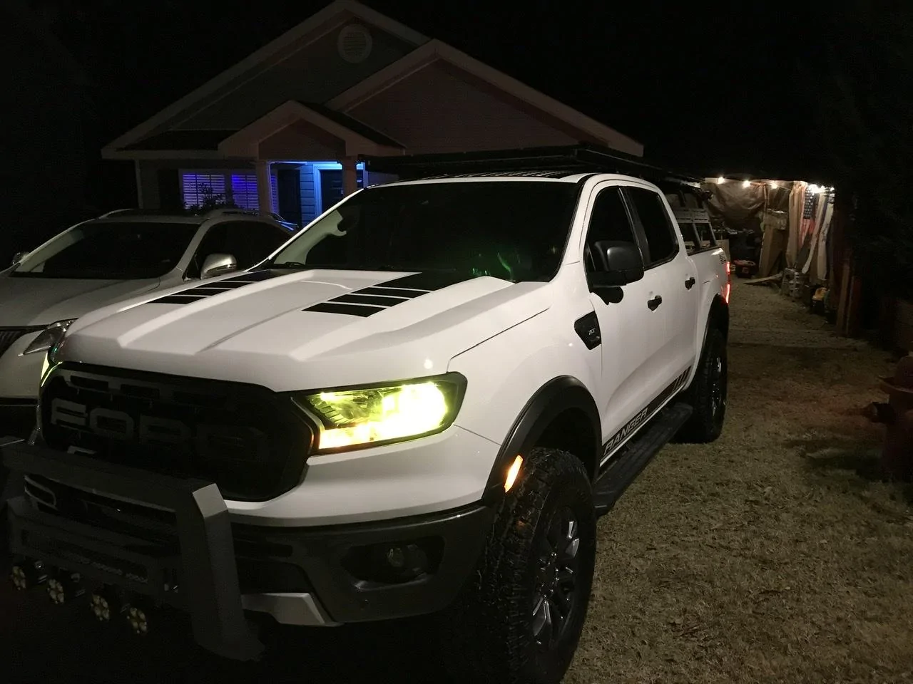

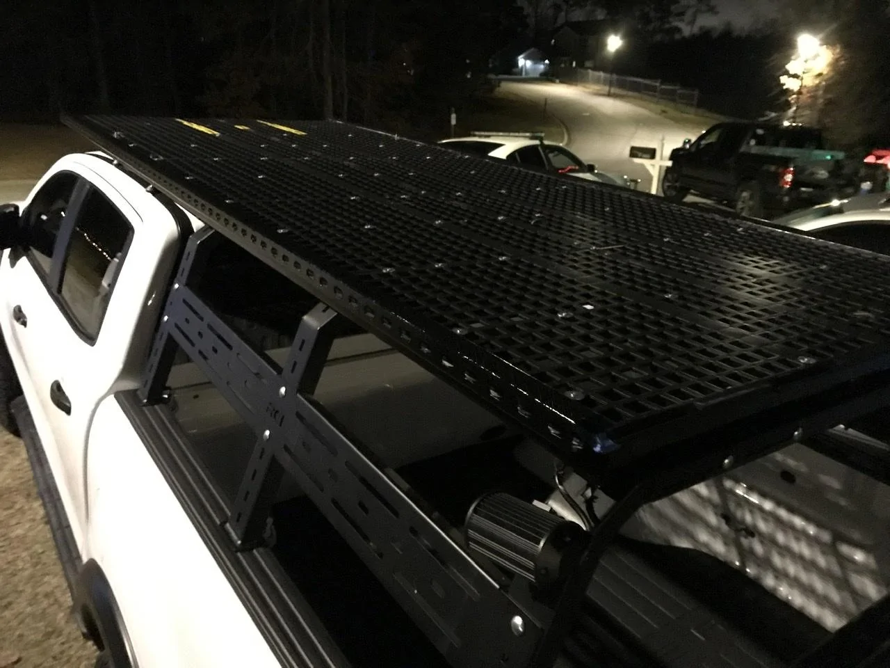

Working on the 44 inch six light front panel the alignment isn’t perfect but as they say good enough for government work.
Edit: I think I have an idea how to integrate a wind fairing directly behind this as I will be using brackets to stand off the panel about 3" lower and 4" away from the front frame beam. I know it might seem silly considering I will have six dinner plates up there, but it will cover the gap much better from the roof line to the front frame beam, won't cost much, and something is better than nothing.

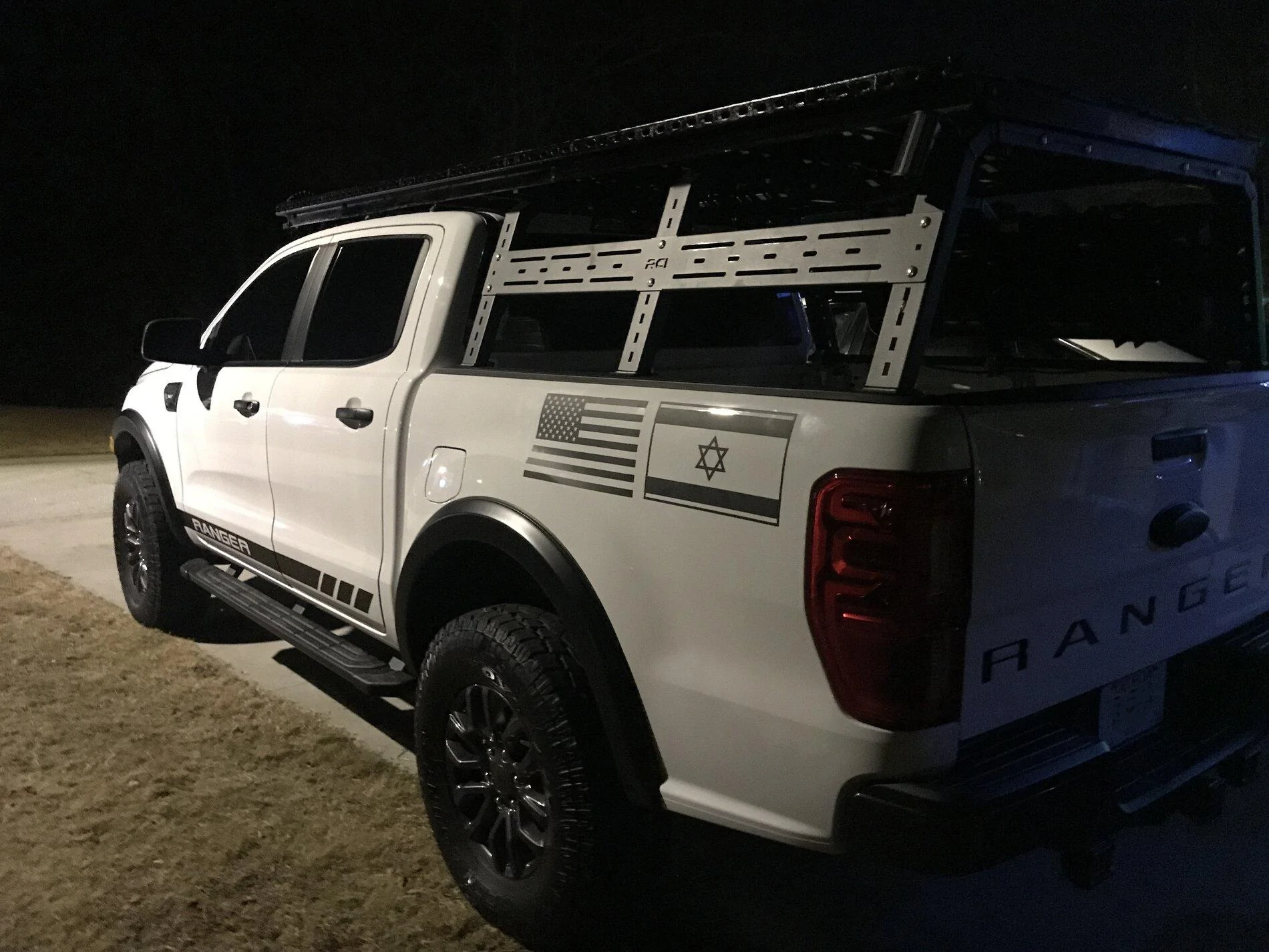

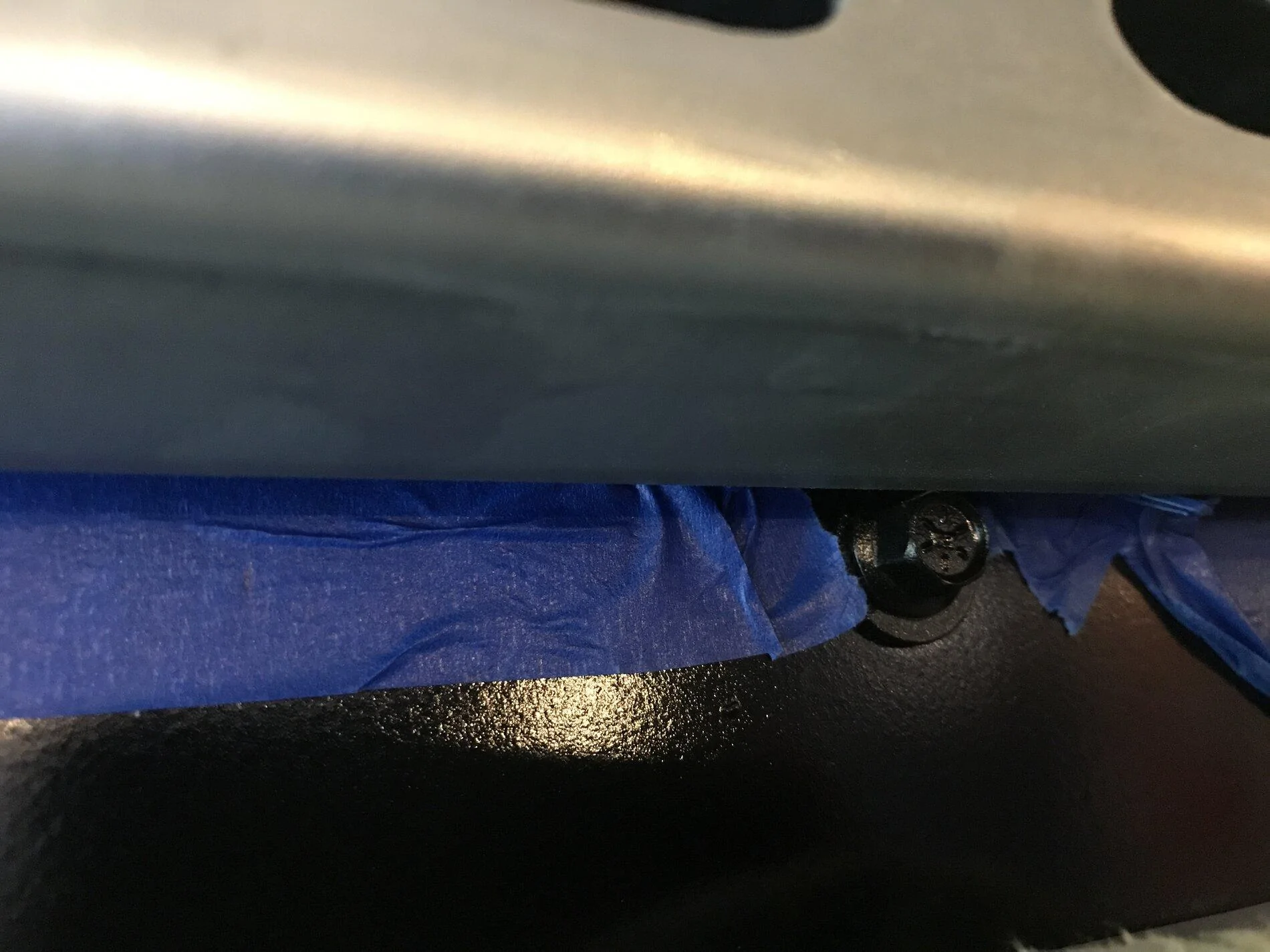

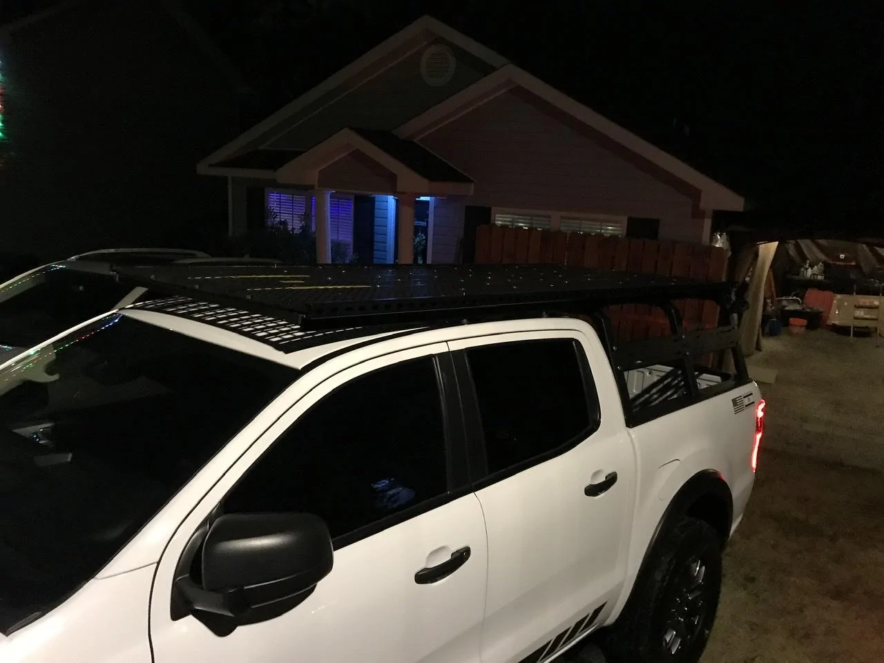

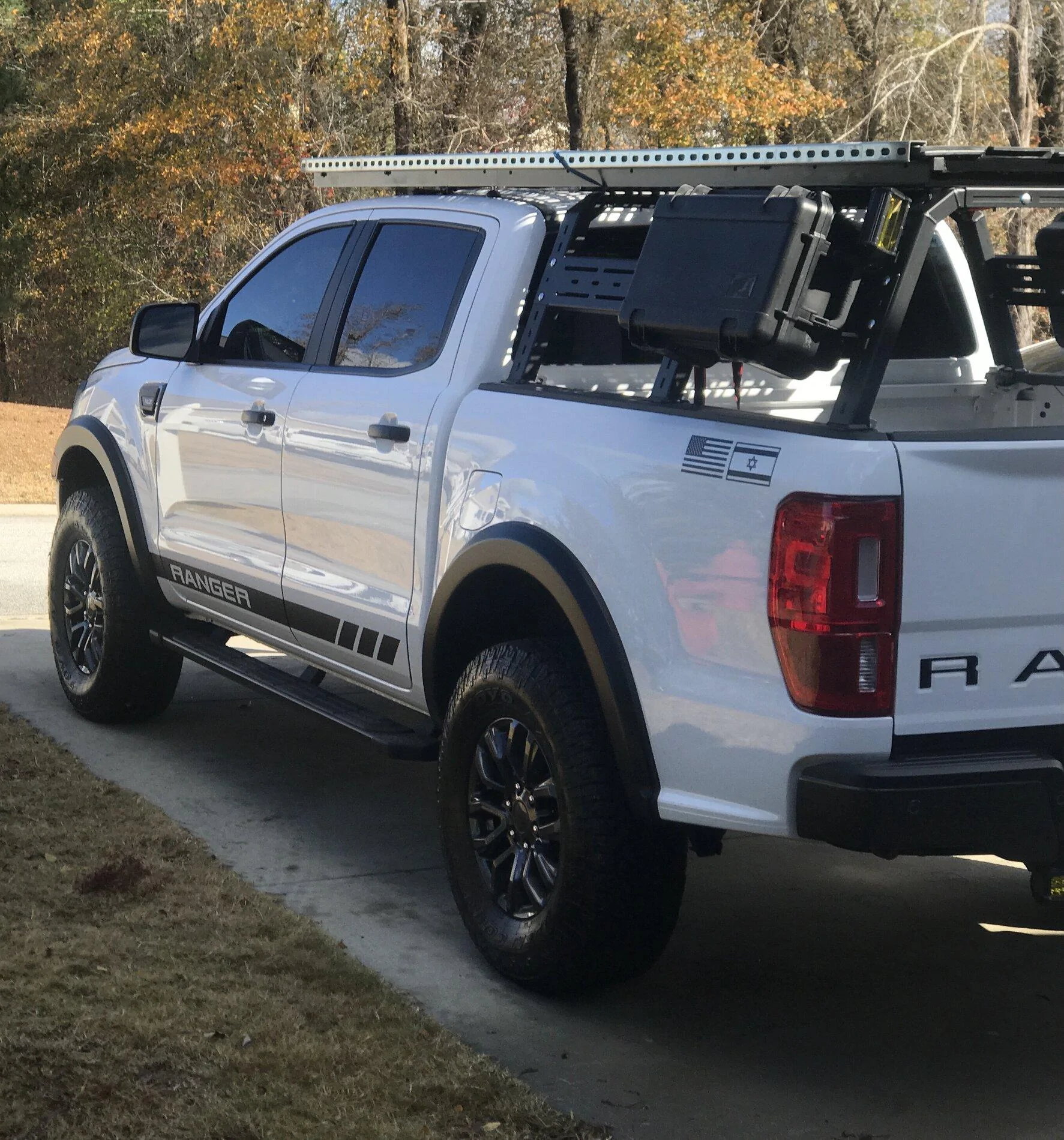

Still need to amber tint new set and seal them proper like. Had a spare moment to pull the old flags off and install the new ones. Also the rubber spacers came in today and they are nice and beefy. Had to put slight pressure on the cross beams to shove them in where I wanted them and it worked out perfectly. None of the cross beams visibly show any movement, but for the price over-built better than under-built.
