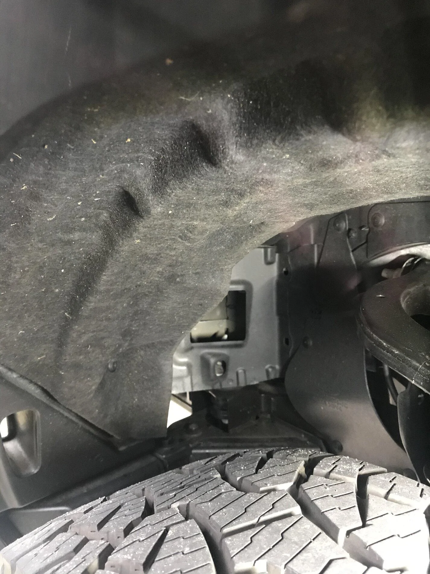

Can someone send me a picture of what the bottom left of there truck looks like? Towards the front above the tire.
