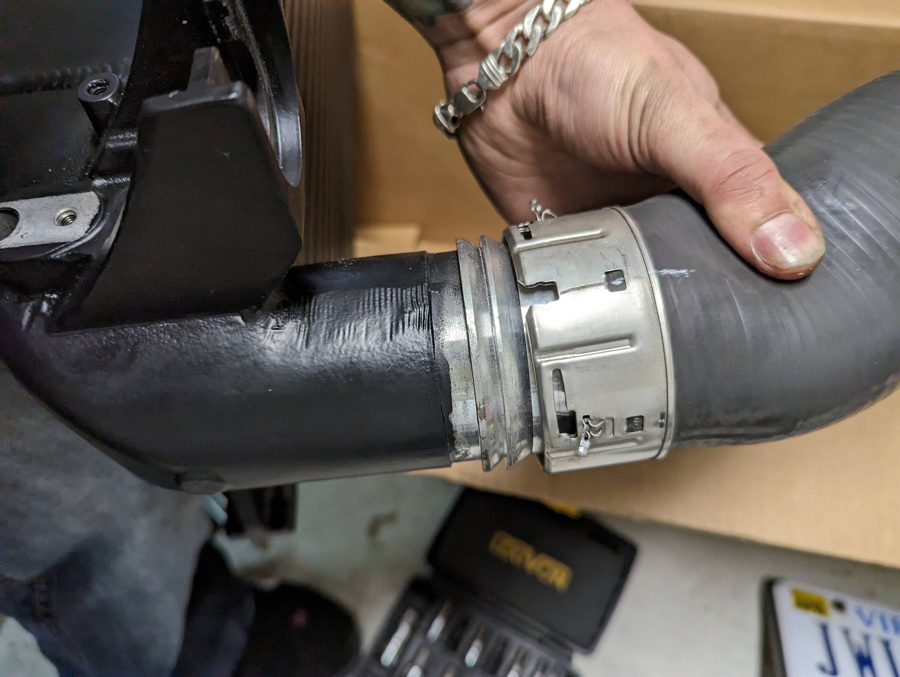

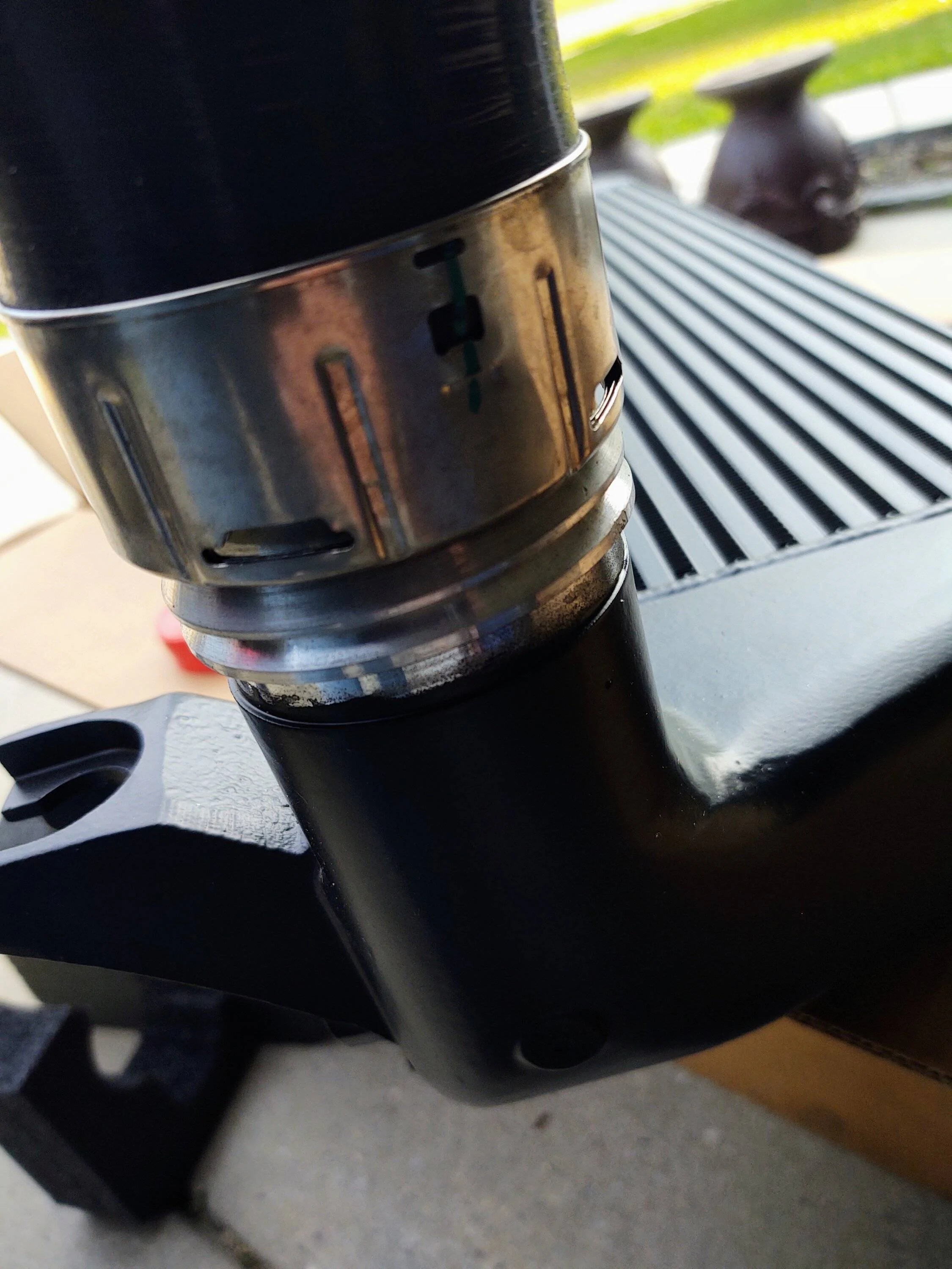

So i was the first person to report an issue with the ESP intercooler fitment. The outer diameter of the cold side outlet is too big to fit into charge pipes. The photo shows the stock pipe, but I currently have the CVF pipes installed and was producing the same issue.
UNLESS you have a silicone pipe. Most of the aftermarket pipes are all aluminum with the exception of Mountune being silicone.
The solution.........Wait 2 months for a fix in the form of an adapter of some sort. I was stoked to see a discount on any of the intercooler, so i jumped on this one. Well didn't work out in my favor.
So. Much. Work. Involved. In. Taking. Everything. Apart. Only to put it back together with the original part in place. I'm positive Elliott has great products and many fans, but my experience wasn't exactly enjoyable.

I do have a solution. I am going to make a custom piping kit and send out to you free of charge. All I ask is about 2 months to get a sample made, fitment tested, and a production done.
It's not life or death and they offered a refund if I return or a 10% discount on more parts if I can wait. What is the stock diameter? I wonder what effect the slightly larger exit will have?
Stock is 67 ESP is 68. Small difference but with hardened metal that doesn't flex. It's a big difference.
So IF mine arrives with the 67mm all is good - but I won't hold my breath.

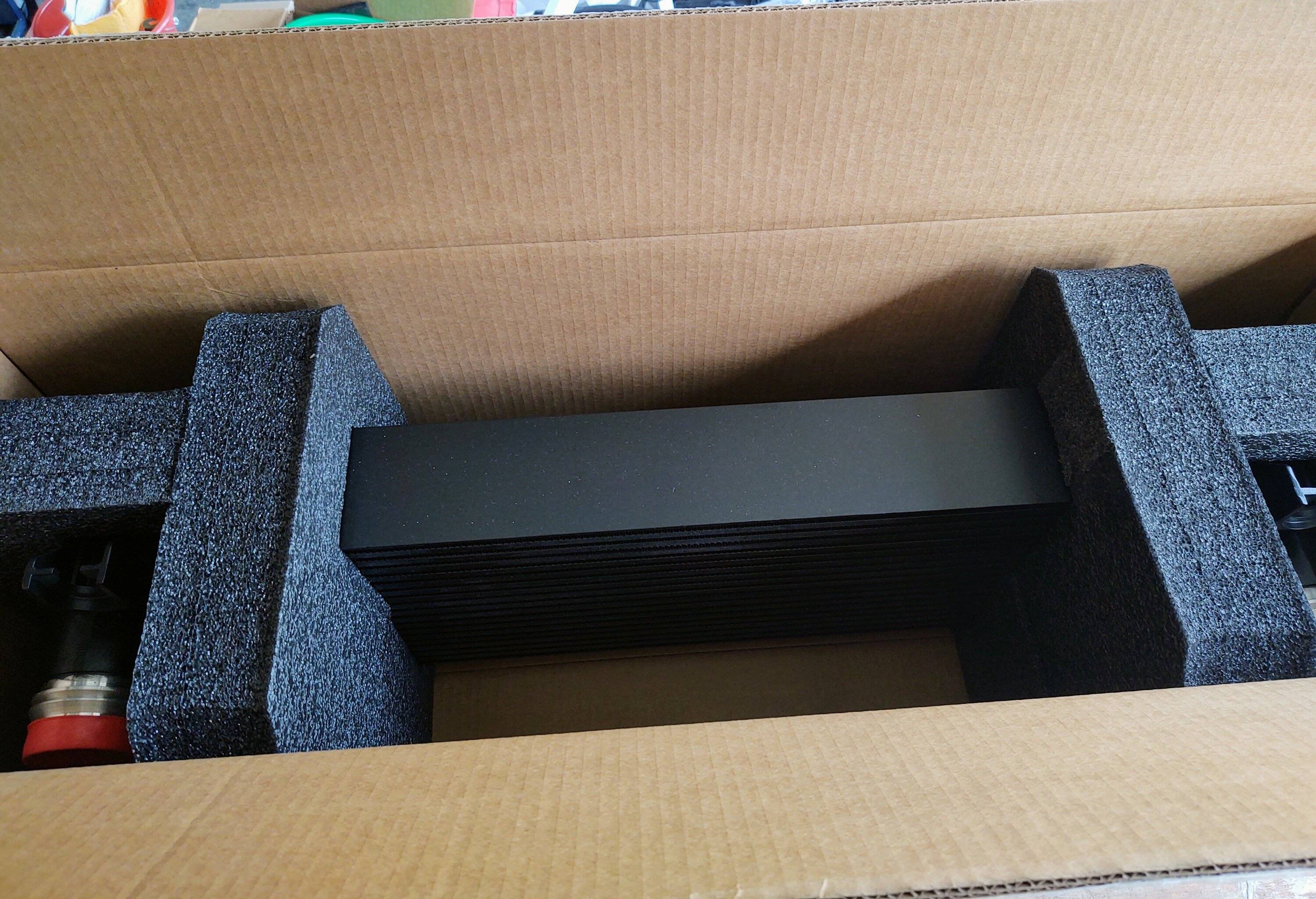

Mine came and I have the larger-than-stock cold side port ?
So I'm going to wait to see how this is resolved. I already have the mishimoto charge pipes and they flow much higher than stock. Not sure if ESP's solution would be larger than stock like aftermarket but I certainly hope so. I recall someone mentioning CVF sells just the hot side pipe and looked on their web site. Not sure why that's a good thing vs. both ( @CVF-Jason ?)but I will point out that when I installed my mishi pipes I ran out of time to do the full install on it one week and only put the cold side on. My power band got flattened and my MPG's shot up but I preferred the full install performance that I completed the following weekend.

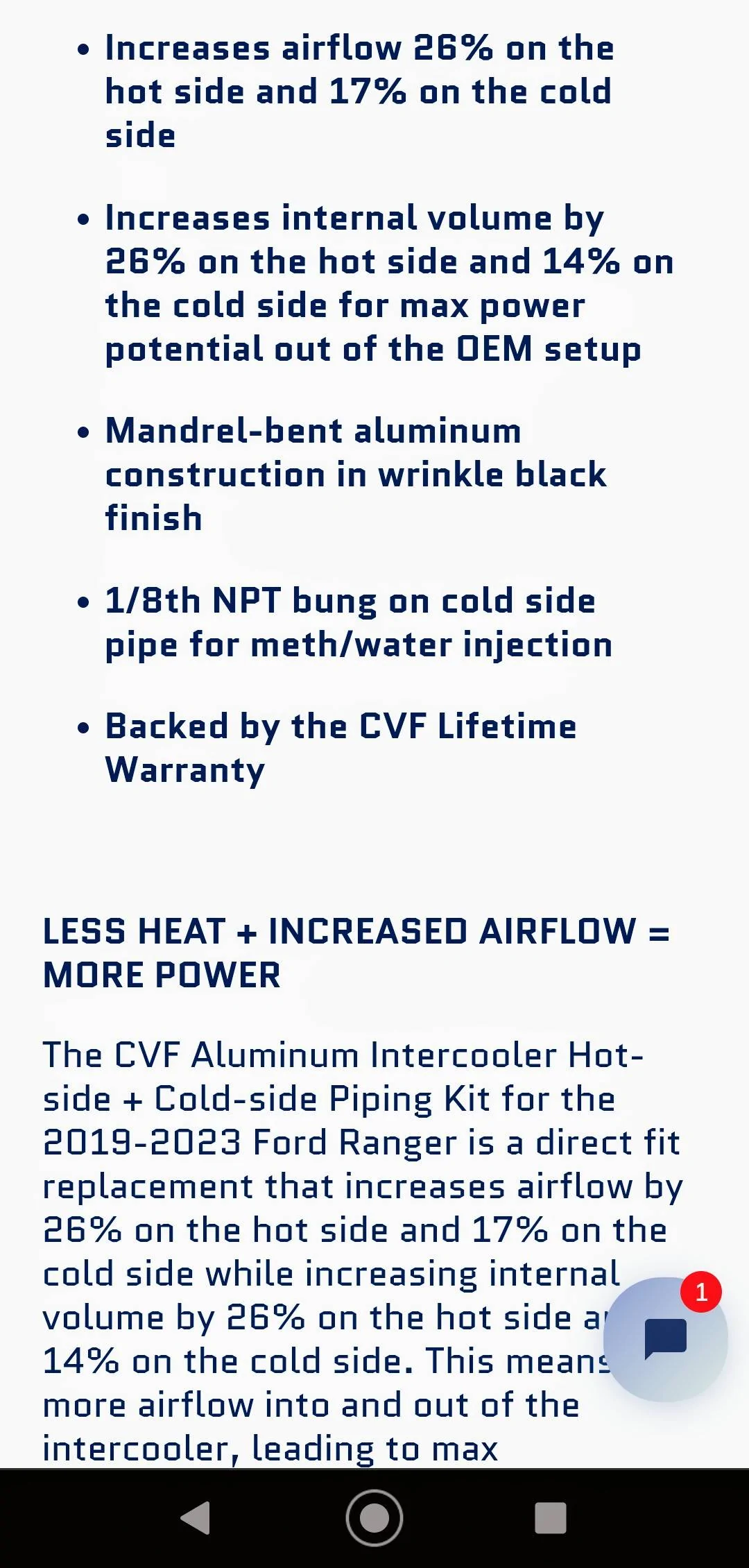

Here's CVF's info on their full pipe:
I do like the bung for those who want to add injection and the flow numbers are similar to Mishimoto's which advertises 25.6-percent more flow on the hot side and 16.6-percent on the cold side; Increases internal volume by 26.4-percent on the hot side and 13.7-percent on the cold side but you'd have to tap your own port for injection. With the intercooler and charge pipe specs being so darn close across manufacturers I wonder what a different variance in ratio of flow between hot and cold is going to do for power?
