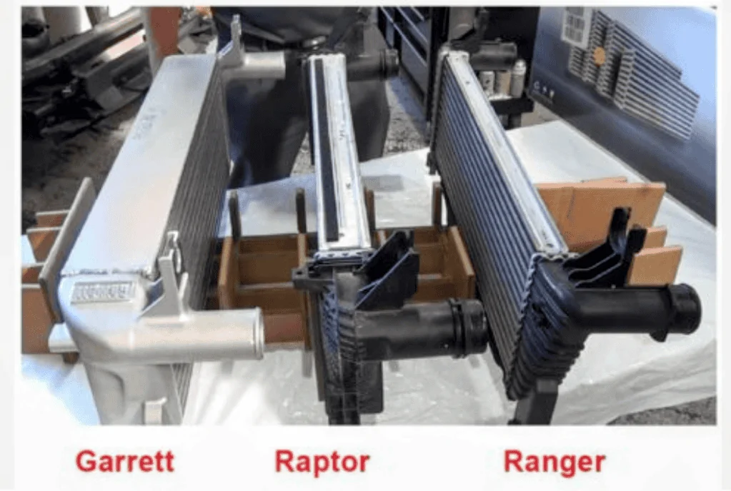

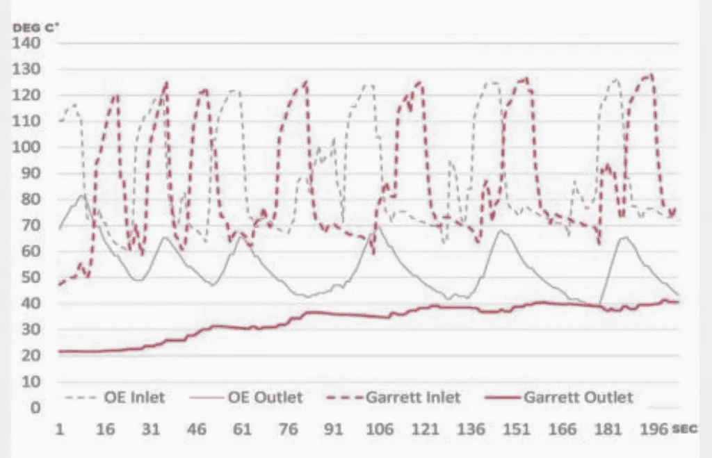

From Garrett:
Upgrading to a more effective intercooler will increase horsepower by improving intake air density and reducing thermal stress on the engine through cooler intake air temperatures.
Cooler temperatures results in a decrease in combustion temperature, moving the engine further from the edge of detonation under boost. As a result, water and oil temps can drop and that pressure drop across the core reduces the strain on the turbo’s compressor while reaching target boost pressure.
This means the turbine does not need to recover as much power from the exhaust stream to power the compressor. Less power recovery needed reduces back pressure resulting in less propensity for detonation, less heat retained in the engine as well as better volumetric efficiency. With cooler intake air temperatures and less back pressure, the engine’s tolerance for detonation increases. This new higher tolerance utilize tuning to increase boost pressure, ignition timing, and perhaps a leaner air-fuel ratio to produce even more power. For a simple bolt-on upgrade, a performance intercooler has a cascade effect for making more power and efficiency while reducing stress on the engine
Combined with more octane - I'd advocate for utilizing ethanol rich fuel as much as the factory computer is designed to handle (can you find 94 octane 15%? Not really) but I never had problems with E30 (94 octane) so there's that. Just can't find it these days.
Image of intercoolers for scale:
And this graphic:
Read the sales pitch here: https://www.garrettmotion.com/racin...r-everest-mazda-bt50-performance-intercooler/
