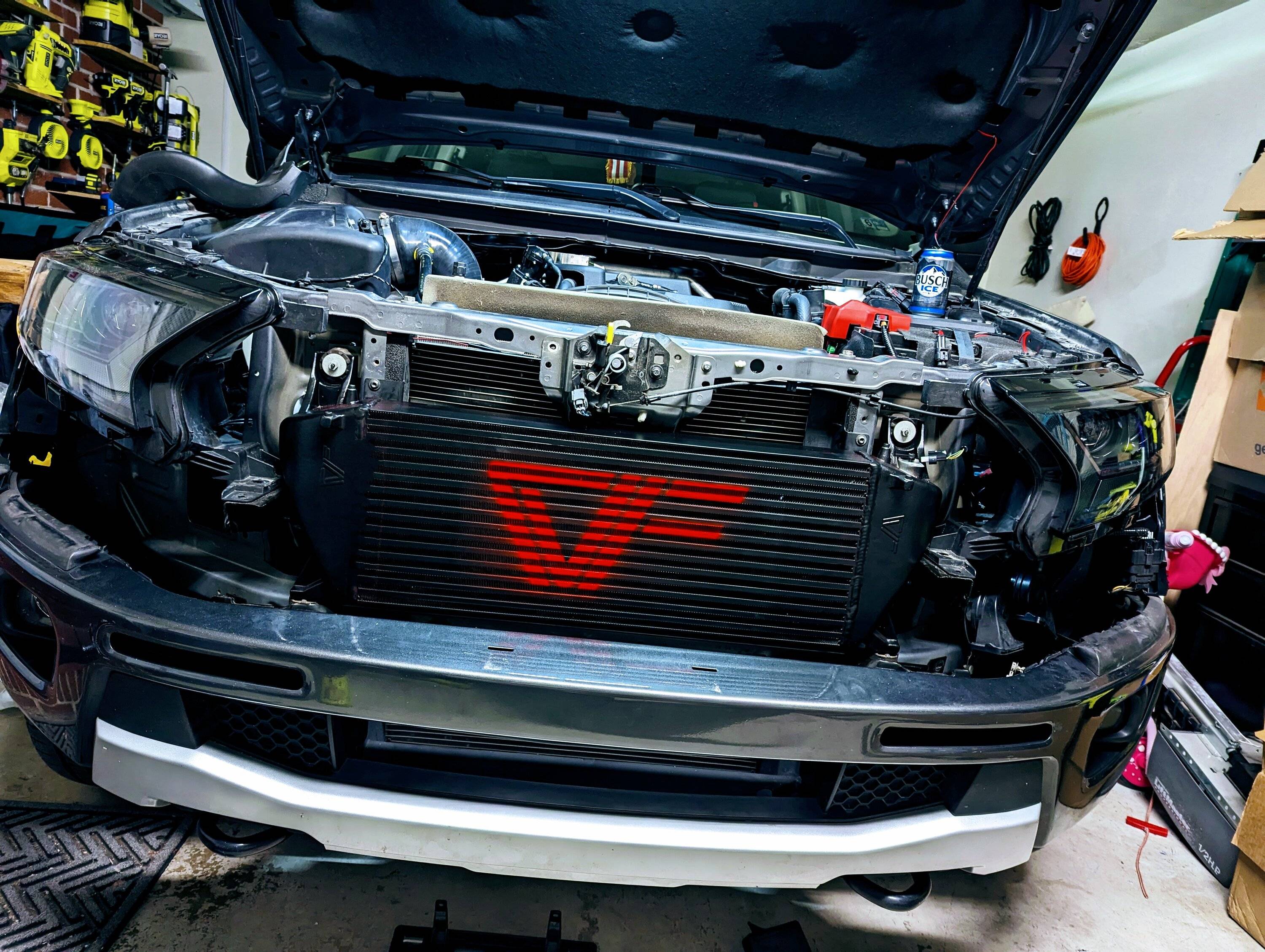

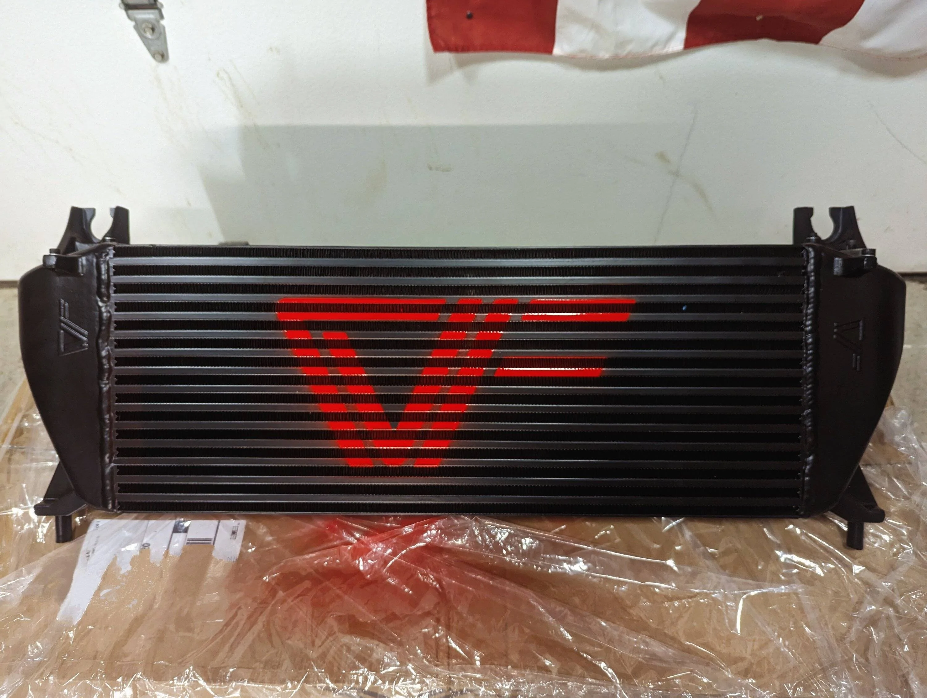

On the other hand, the CVF intercooler showed up!
Install was actually possible with this one. Before i got to involved, i grabbed the stock pipes to make sure that they fit, which they did. I had zero problems installing and fitting it to the matching CVF charge pipes i bought a few weeks prior. So yeah, go get the CVF intercooler.

Yes a HUGE difference: the CVF intercooler actually fits. ?.
Weight is the same, i will admit that the welds on the ESP are cleaner, the finish is smoother, but that's very very much excused with the fact that it's affordable and functional.

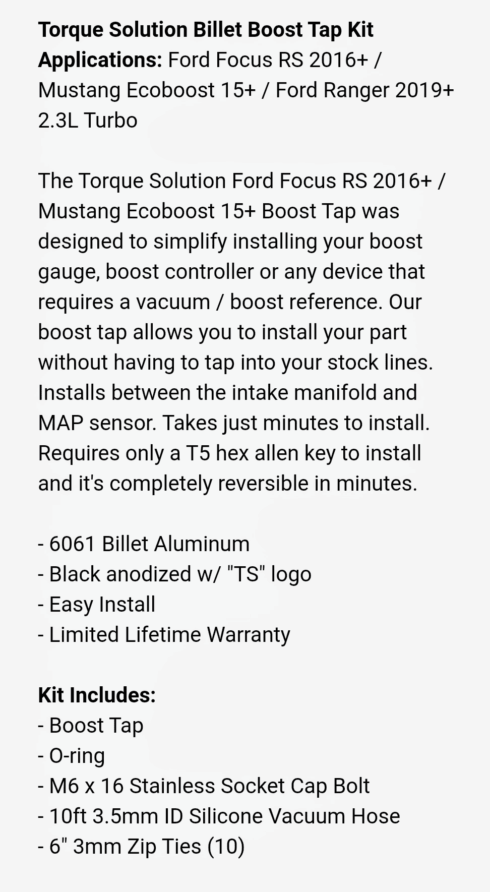

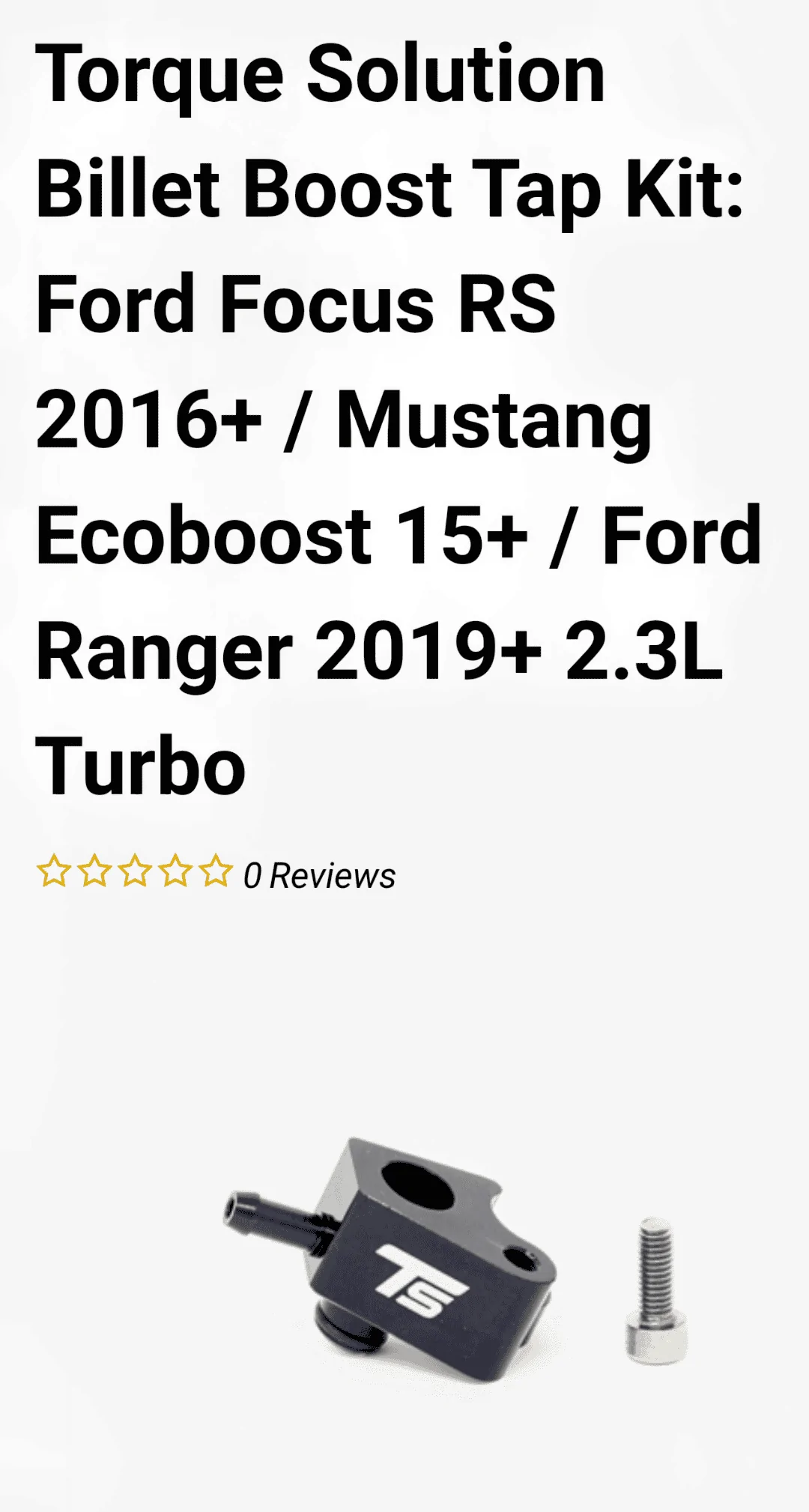

I had exchanged a couple emails with Jimmy and had pointed out CVF has the threaded bung in their charge pipes and Mishimoto has and area on theirs you 'could' drill and tap. While ESP says they have an area on their intercooler to drill and tap for injection or boost gauges I pointed out the Torque Solution provides a non-destructive way to hook up a boost gauge:
This was over a brief discussion about intercooler pipe design. Let's see if this turns up on his web store!

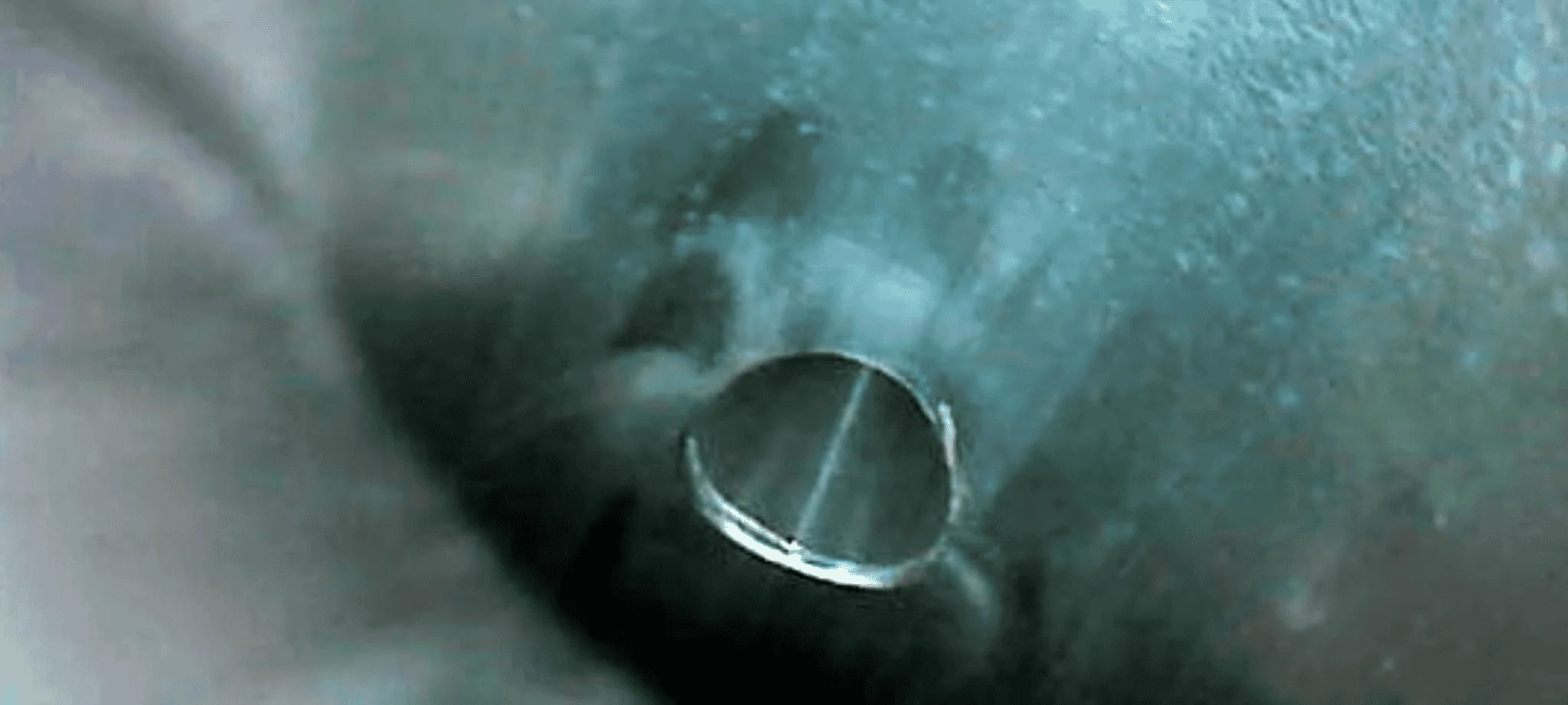

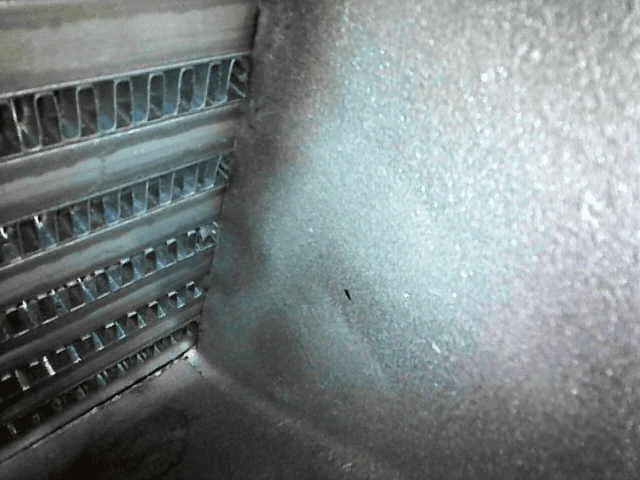

I clean out my pipes prior to install. They are generally full of manufacturing dust/metal/shards.
I stuck my camera through everything on my intercooler and pipes, just prior to sealing it up with hoses.

What do you do to clean them?

Brake cleaner. If you want to clean the intercooler itself, you could get 5 gallons of E85 and run it through the intercooler.
